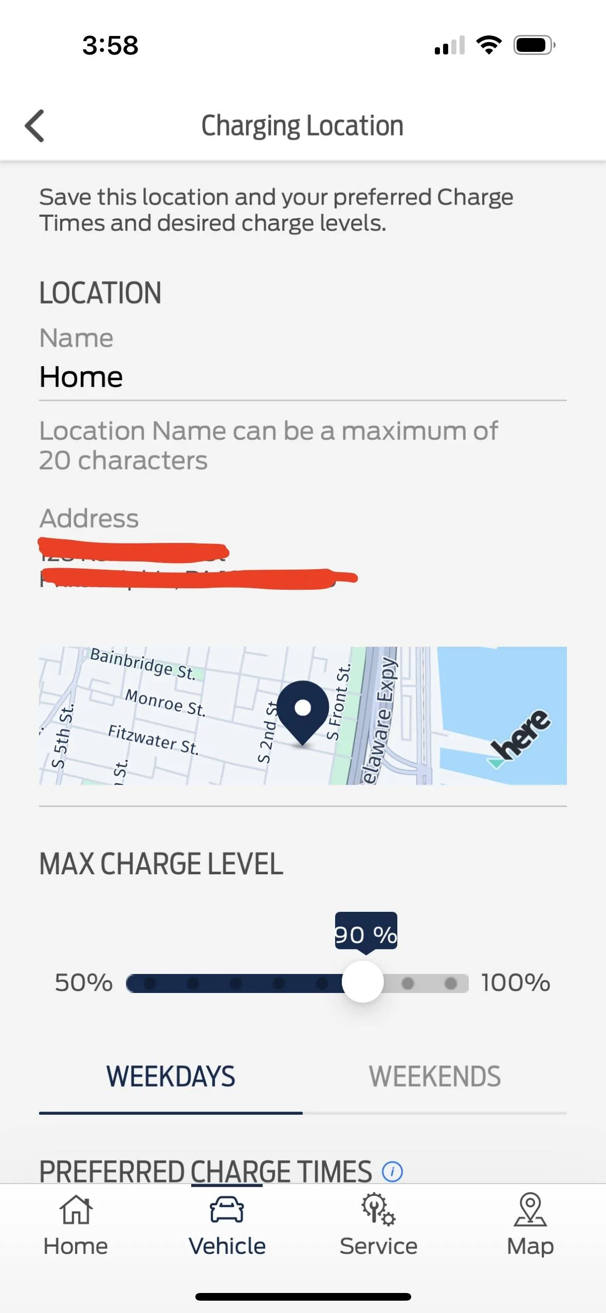

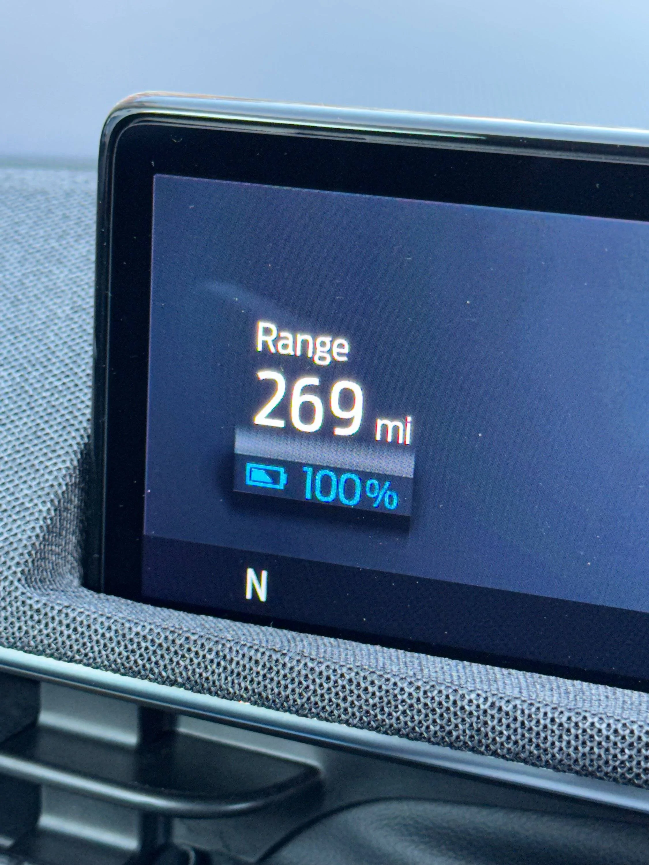

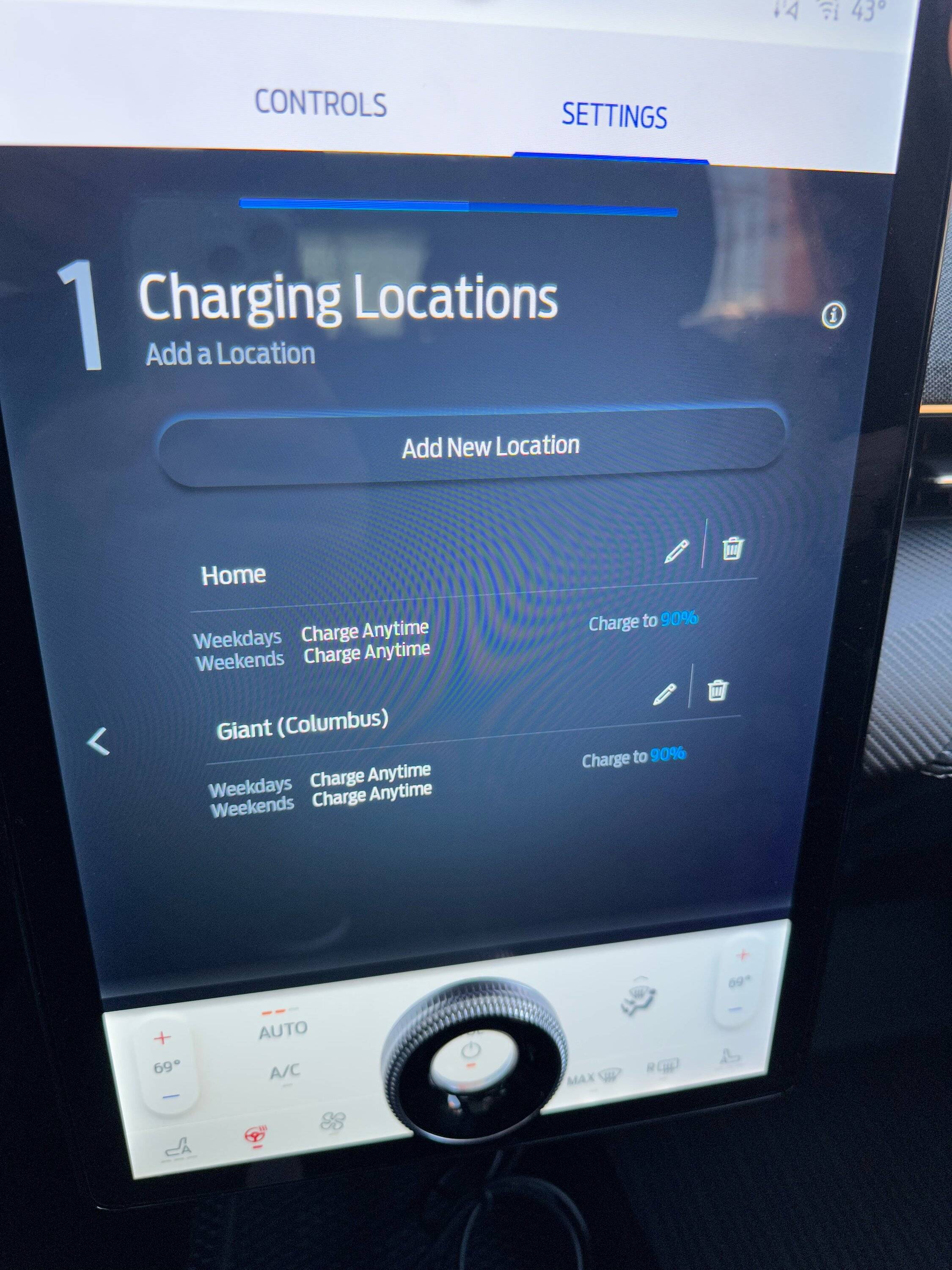

Not sure what's happening here, but I have my charge limit set to 90% both in the car and in the app (both at my home location and without a location specified) but yet the car charges to 100%. Any advice on how to make sure it doesn't exceed the limit I've set?

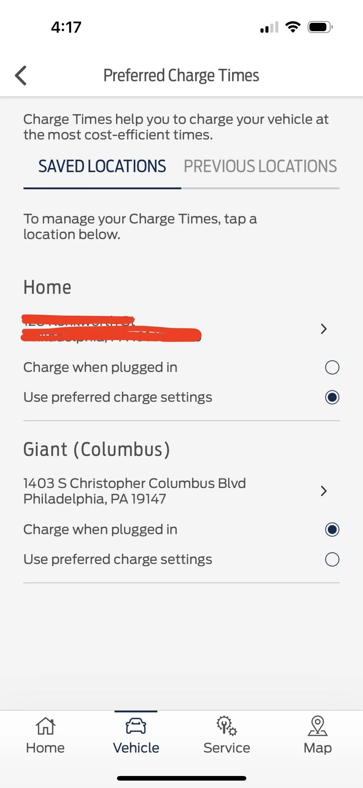

Make sure you have the app set to "Use preferred charge settings" and not "Charge when plugged in"

Yes, that's how its set at Home. I do have it the opposite for a public charger at a local supermarket since whenever I plug in there, I want it to charge. But the 100% charge override happened at home.

You can try removing your home location and plugging in again so that you can re-add it. I've never had to do that, but others have reported having that issue.
That’s what I have to do after pretty much every OTA update. It works.

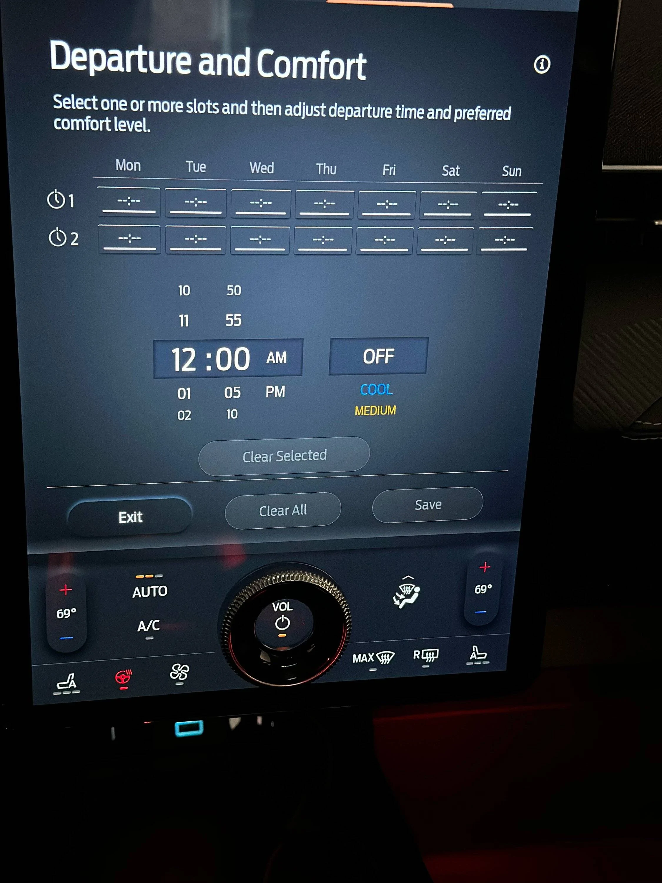

You might also want to enter a schedule rather than "Charge Anytime". There were reports a while back indicating that the car didn't like having so much freedom. ? Seriously though, only allowing charging 23 or 23.5 hours per day seemed to work for some users.

When I go inside the settings, it clearly shows 90% on the progress bar. See photo. That said, I have downloaded Optiwatt, which can integrate and control charging, but I have it set to "off" "do not control" so as not to interfere.
I will try that
