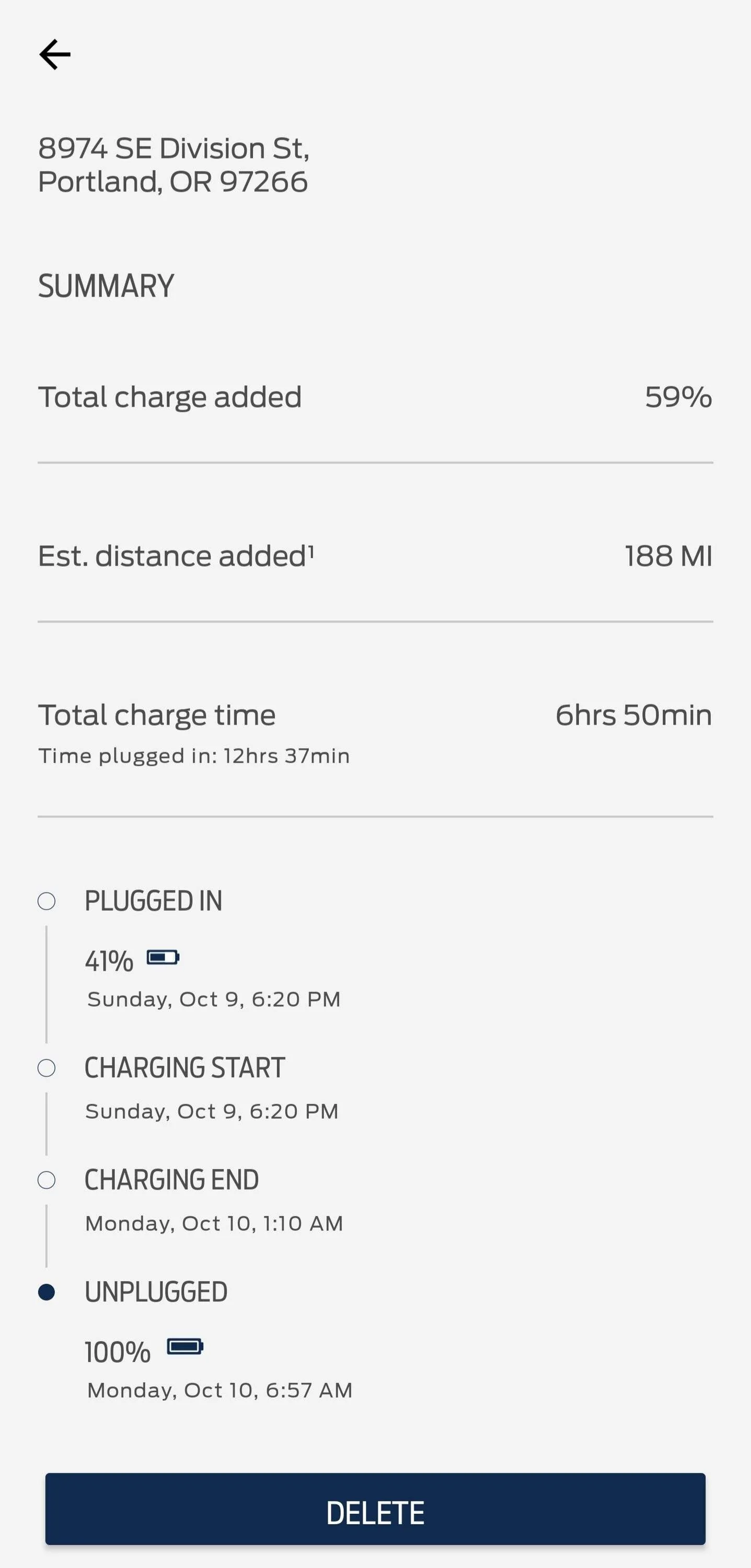

Happened again last night and I checked the logs. It registered my car on the other side of town at a store that I left 2 hours before I plugged in at home...
@Ford Motor Company able to check anything on the back end?
