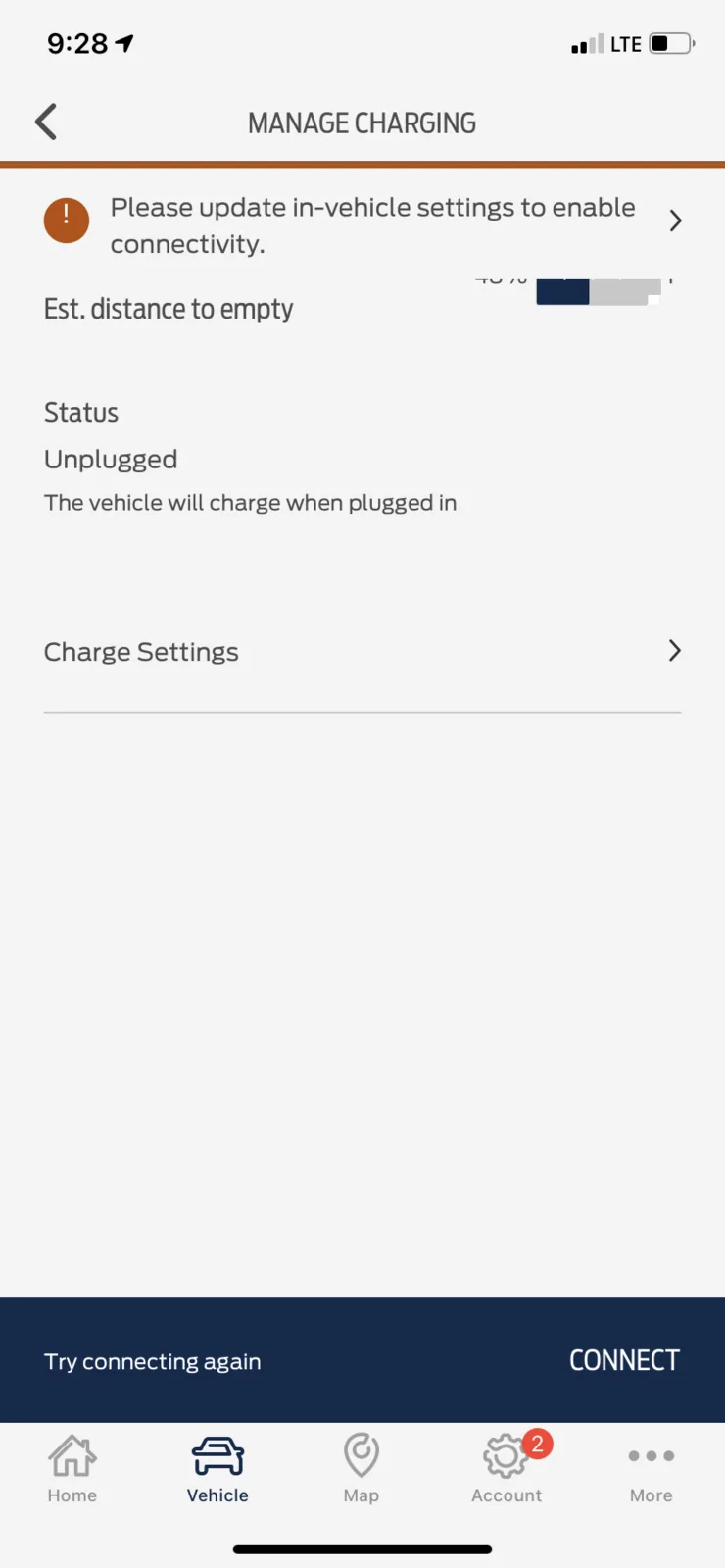

So I was trying to set a charge limit to 90% but can’t seem to do it.
When I go into FordPass I get this message....

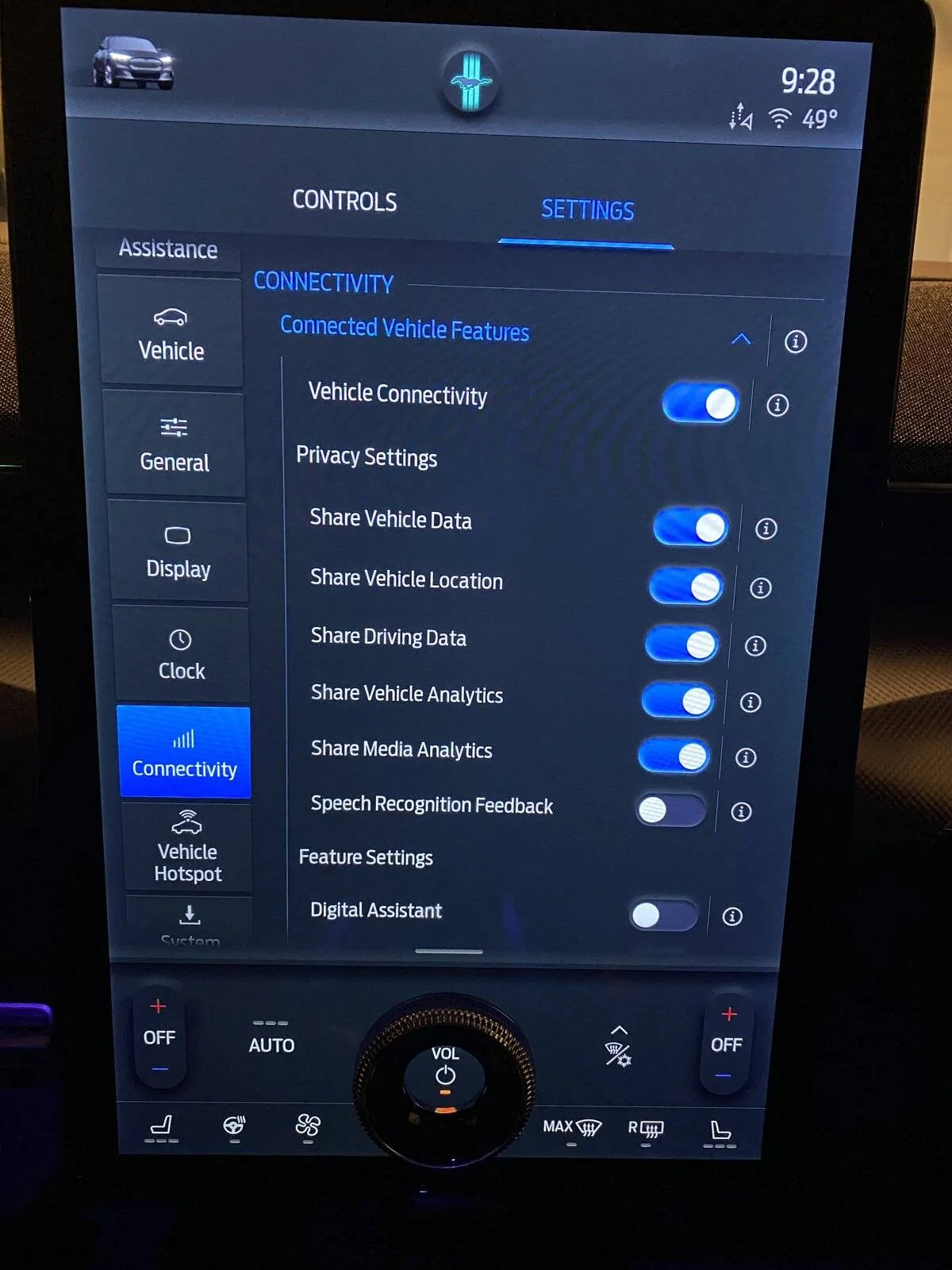

When I go into the Connectivity Settings in the car, I’ve toggled on everything imaginable, but that’s not fixing the issue.

FordPass is connected to the car because I can do things like lock my car etc. with FordPass.
I’ve tried closing and reopening FordPass but that didn’t help.
I can seem to do anything in FordPass re charging scheduling until I can get this connection issue resolved. Ideas?

So after posting this I did figure out how to set the charge limit in-vehicle. You just to Charge Settings and click on the edit button to create a charge schedule. Part of that schedule allows you to set a limit.
But I’d still like to figure out the problem with FordPass.

And of course, right after setting the charging schedule/limit in my car settings, FordPass started working. It’s almost like I had to start setting it up in the car before the app would work.
I observed the same thing with Profiles. Couldn’t create one through FordPass but could create one in the car settings - now I can edit the profile in FordPass.
