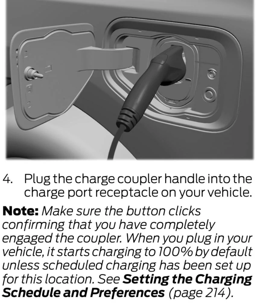

The Lightning has the capability to set a one-time limit that applies to your next charge regardless of location, but there is no permanent, location-agnostic limit.
273
18,289
28,787
I believe the Lightning has a pre-set 90% DC charging limit. The Mach-E doesn't have that.
Maquis
5,751
8,207
Is that for L2 or DC? Or both?
Edit….from the Lightning manual:
Ford Mustang Mach-E HVB Charge limit setting IMG_0644
