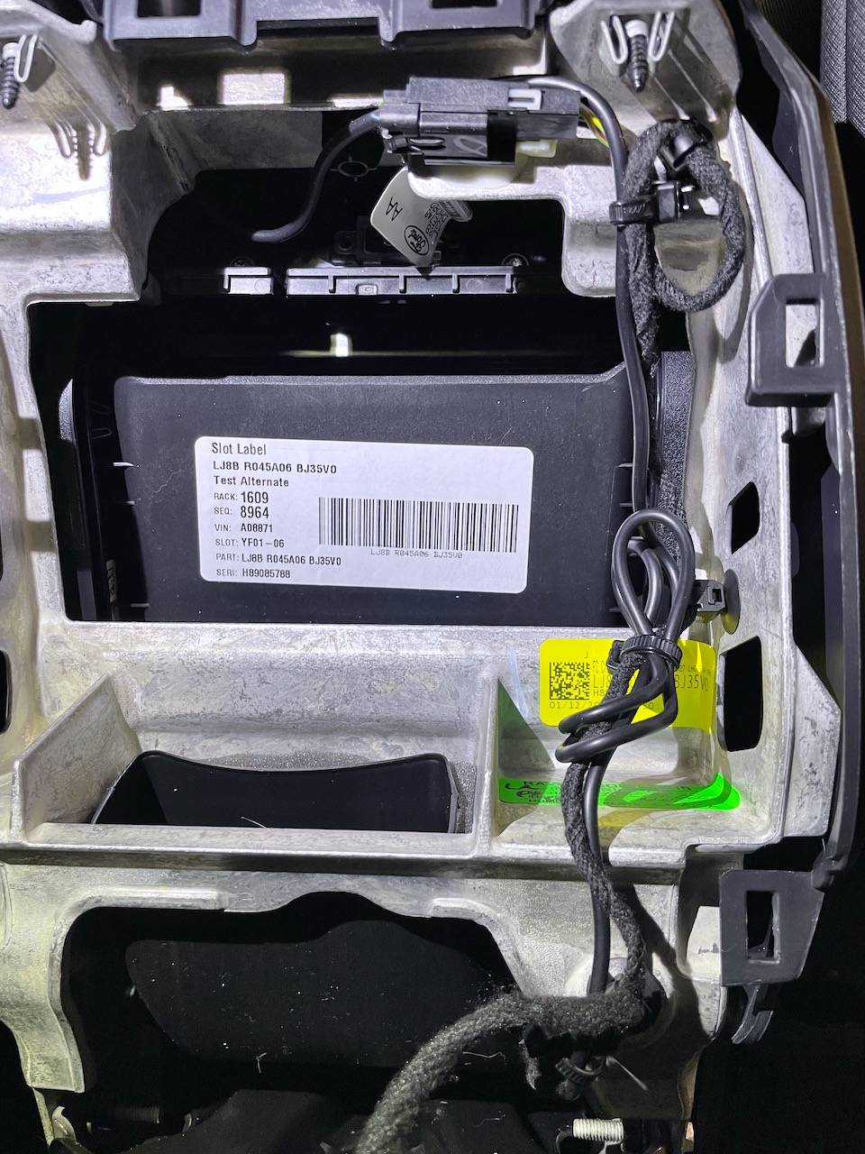

Anyone have 1) a pic of the inside back of the center console and 2) directions to tear it down if the slide cover thing is jammed and won't open? I am wondering if there is a wall along that back that it slides behind? or just a track into the cavern of the console?
Mine has been stuck/jammed stuck for several weeks and the dealership can't get me in for another month. Unfortunately, my dads handicap parking pass is stuck inside and I will need it next week.
I have tried all kinds of fancy driving maneuvers to try and dislodge anything that may be preventing it to slide with no luck whatsoever. It will only open/slide about 1/8".

Hi Leanne, below is a photo with the rear panel of the console removed. To remove it it just pulls straight out and away from the console. It is held in with 6 clips I believe. I took this photo over a year ago so cannot remember. You can see once it is off, the tracks on either side that the cover rolls down into. With a flashlight you should be able to look inside and see what is binding against the cover and hopefully can push it down with something flat so you can get in there.
Thank you!!! This will be my project on my day off Tuesday!

Literally took my 1 minute!! Nothing was stuck, there is a little roller in the 2 corners that seemed to be binding. I just gave it a few hard spins and it’s fine now!
And here I thought I was going to have a time capsule for ever!!

hi, I have the same problem and I think it’s something I put in there that is causing it to be stuck. My car is a 2025, can you tell me how to get that back cover off? Am I just supposed to pull on it?

Look at my post #5 in this thread.

Thank you for this. I didn't have any luck just pulling up off the cover, but I did pull on it enough to create a gap against the credit card in it and then just started to separate the cover and that worked. Thanks for this!
Also, really terrible design by Ford on this. The inside of the storage cover actually has ridges on it where it can catch stuff. It should be simple enough to just make it regular, smooth plastic
