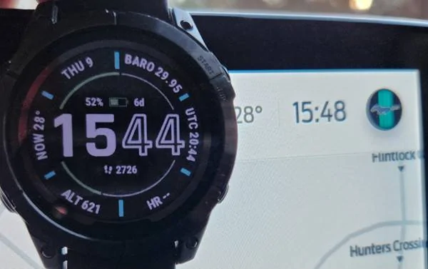

Short version: 2024 Mach-E Premium Center Display shows incorrect time in status bar. See photo of display time and the actual time from a GPS-timed watch...4 minute difference here, and sometimes it was 5.

Imagine my surprise to see that the big center display shows the incorrect time (off by 4 minutes in this picture with a GPS-timed watch).

Shut off auto time sync, then turn it back on again. Cycling should fix it.
I just went through the user guide...found 500+ instances of "time"... but none adjacent to "automatic" or "sync"...
is this in the controls menu someplace?
11,410
25,166
To enable automatic time synchronization in the vehicle, follow these steps:
1. From the settings menu, press General.
2. Scroll to Clock.
3. Switch Auto Time Update off and then on.
2. Scroll to Clock.

This corrected the time display..
Thanks!
