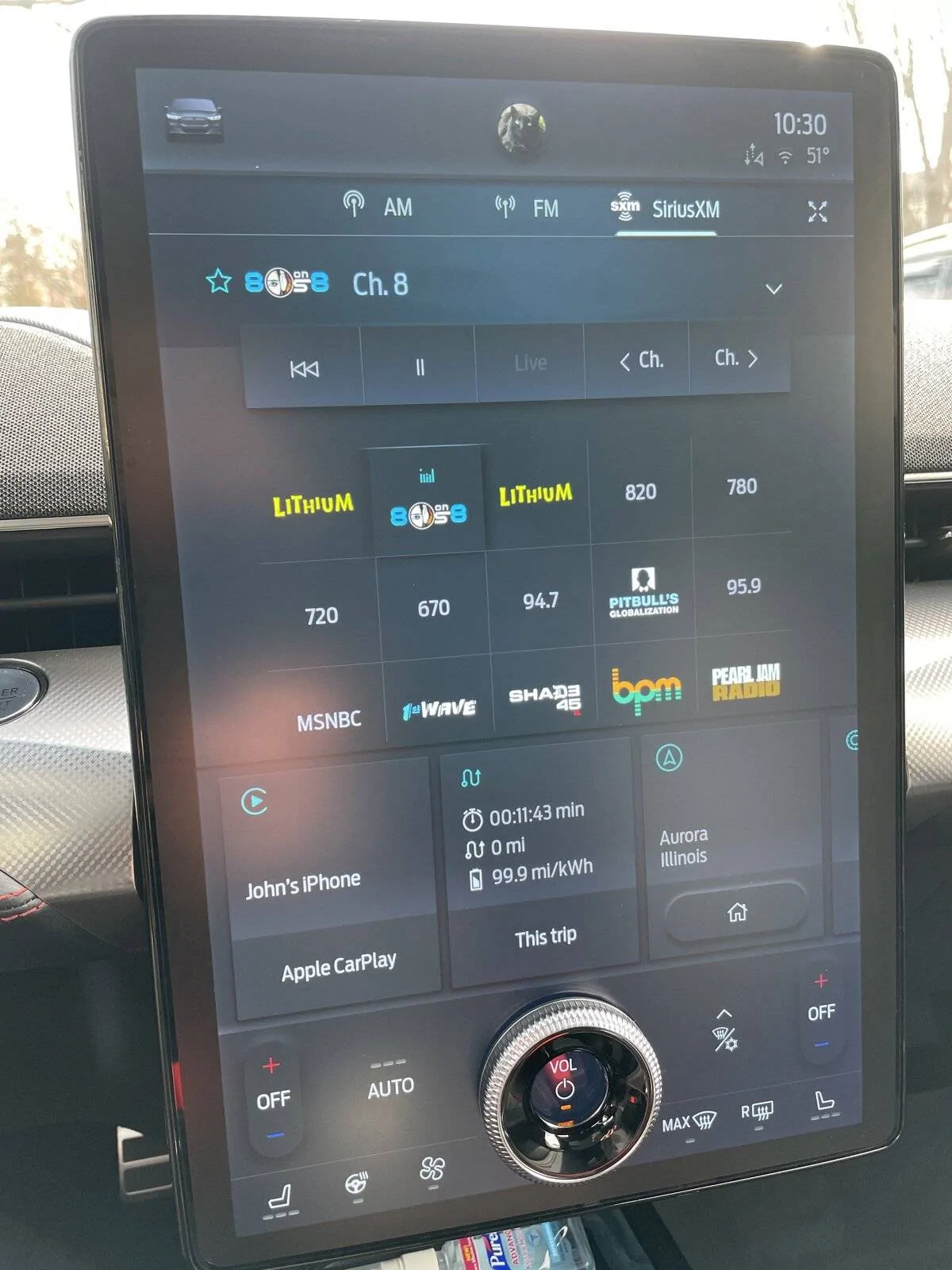

@Liv, watching your video was very helpful and appreciated, but it actually had the opposite effect on me at first than others here. I ordered the OCD protection before I watched and thought it would be good. Once I saw your video, I got extremely hung up about bubbles and streaks on the screens. Watching you working with the little spray bottle looked tedious too. I just couldn’t bring myself to install the film. Last weekend I was working on applying XPel door sill trim on our Subaru. I used Griot’s Garage interior cleaner to moisten the film. It went on great with no bubbles or streaks. That got me thinking about the screen again. I pulled the MME out this morning and sprayed the screen lightly with the cleaner, wet my fingers, then did the same with the film. Like others here, working around the dial was the worst part, but I was able to nearly perfectly center the film and got all the bubbles out. All said and done, no streaks, either. Same for the driver display. Forty minutes of work in total. Thank you for this and your other contributions to the forums.
Ford Mustang Mach-E Display protection ECE3E468-F4B3-4B4D-9218-FC9F5EC14050
Ford Mustang Mach-E Display protection AF867AEE-D495-42E1-8B4D-2B8CF09816EF

Oh no I'm so sorry it made you hold off! I think maybe my excessive liquid use should be a cautionary tale! Yours looks absolutely amazing! Well done!
They were kind enough to send us the dash screen protector and the dot for inside the dial BUT it arrived the day after we had to drop Blucifer off at the shop. So I'll be doing a short update as soon as we get it back and do the dash screen with waaaay less liquid!
Thanks for sharing! Looks so good!

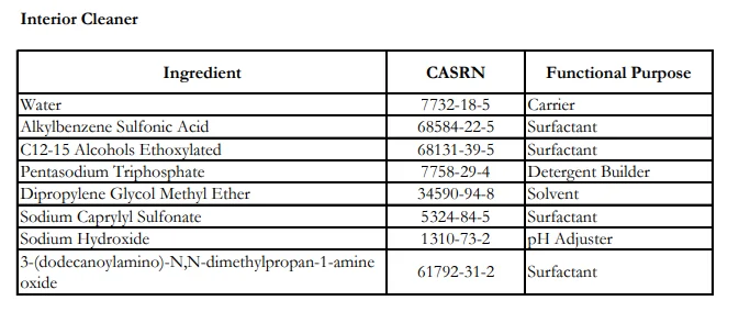

What was in the cleaner? Was it water based (polar)? They recommend soapy water, correct? I have the film on order so I will be doing this too (except for the driver display).
Griot's Garage Interior Cleaner
Ingredient List
Ford Mustang Mach-E Display protection 1618708673725
A drop or so of Dawn might work just as well. I happen to use Griot's Interior Cleaner, so I might try that. Just depends upon my mood at the time I decide to apply it. ;)

Thanks. I was just wondering if there might be a solvent that reacted with the screen. Apparently it did not react or damage the screen protector.
Yeah like @Kamuelaflyer said, just one drop of dish soap in a sprayer full of water should work perfectly. I feel super confident about applying the driver screen when we get the car back, now that I know to use less soap!
