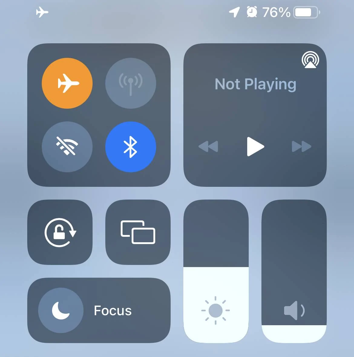

Its an iOS 15 thing regarding bluetooth. Apple has made it so turning airplane mode on now only turns off WiFi and cellular but leaves bluetooth on.
Correct to an extent. When you do a major OS upgrade it will default to Airplane mode with BT on. However if you push the BT button it turns it off, and any other times you push Airplane mode BT will be off. It works the same way in Android, been that way for as long as I can remember.
Ford Mustang Mach-E Change in FordPass Functionality IMG_1298
Ford Mustang Mach-E Change in FordPass Functionality IMG_1297

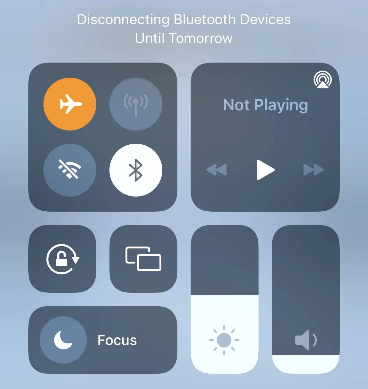

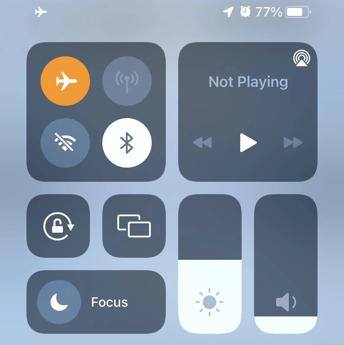

Bluetooth ON - - Bluetooth OFF
And I toggled it here just so you can see it does "apparently" shut off.
