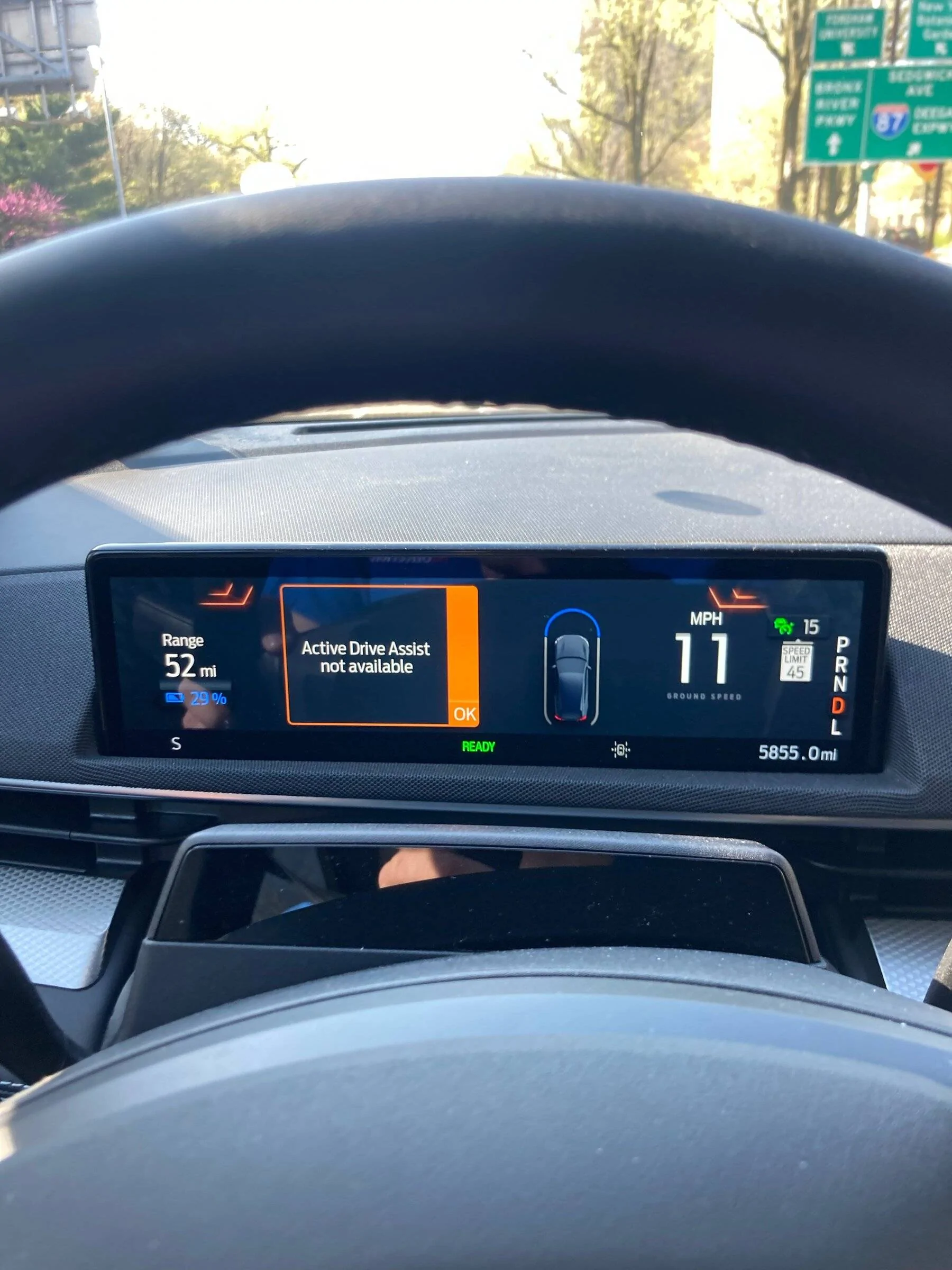

I am having the same issue, and frankly, I am extremely disheartened by my experience with the dealerships. I work daily, and dropping off the car is a big deal, and majorly increases my stress and makes my days difficult. I dropped off the car for Blue Cruise software updates. They had no idea what Blue Cruise even was. Eventually, after calling Ford and arguing with the service advisor for an hour, and having Ford put a message on my account for the dealership to see, they agreed to do the update, but acted like they were doing me some sort of huge favor.
When I came to pick up the car ( they did not pick up the phone so I had no idea whether it was done), they said they needed another day, so I took yet another cab home. The next day I come to get the car, not only does it not have Blue Cruise, but I do not have any active drive assist at all, no blue bubble, only the error message "Active Drive assist not Available". I also no longer have intelligent cruise control, which no one could explain to me.
I cleaned the sensors, did multiple full-reboots, called Ford for hours, was transferred around to the service department, the Ford Pass department, the over the air updates department, tech support department, and all anyone could tell me was to go back to the dealership. When I went to the dealership, they told me there was nothing they could do, that they regret getting involved in my issue, and to call Ford, and ask for my money back for the Blue Cruise prep-package.... Eventually the service manager told me to come back Monday, but they are really pulling every trick out of the book trying to get rid of me, as if I am just a problem they want to be done with.
The dealership service center is treating me like absolute garbage. They know absolutely nothing about this car or its software. The guy helping me told another customer I was a "crazy person". Meanwhile, I handed them the car to update my active drive assist system, and was handed back a car with 0 drive assist system. Blue Cruise was a major determining factor in my decision to purchase this car over competitors, and telling me to ask for my money back is a huge slap in the face and dismissal of the extensive efforts I went through to finance this car. I do not have time to sell this car and try to purchase another one. I work full time and have already spent months on this transaction.
The dealership told me to come back Monday, but I am absolutely dreading going back there so that they can hold my car, mess up my week, and hand it back broken.
This has been super stressful, an absolute nightmare, and I am so much hoping that Ford will help me solve this problem as quickly as possible.
VIN: 3FMTK1SS5MMA41024. Vehicle is Job-1 , and should be eligible for Blue Cruise.
