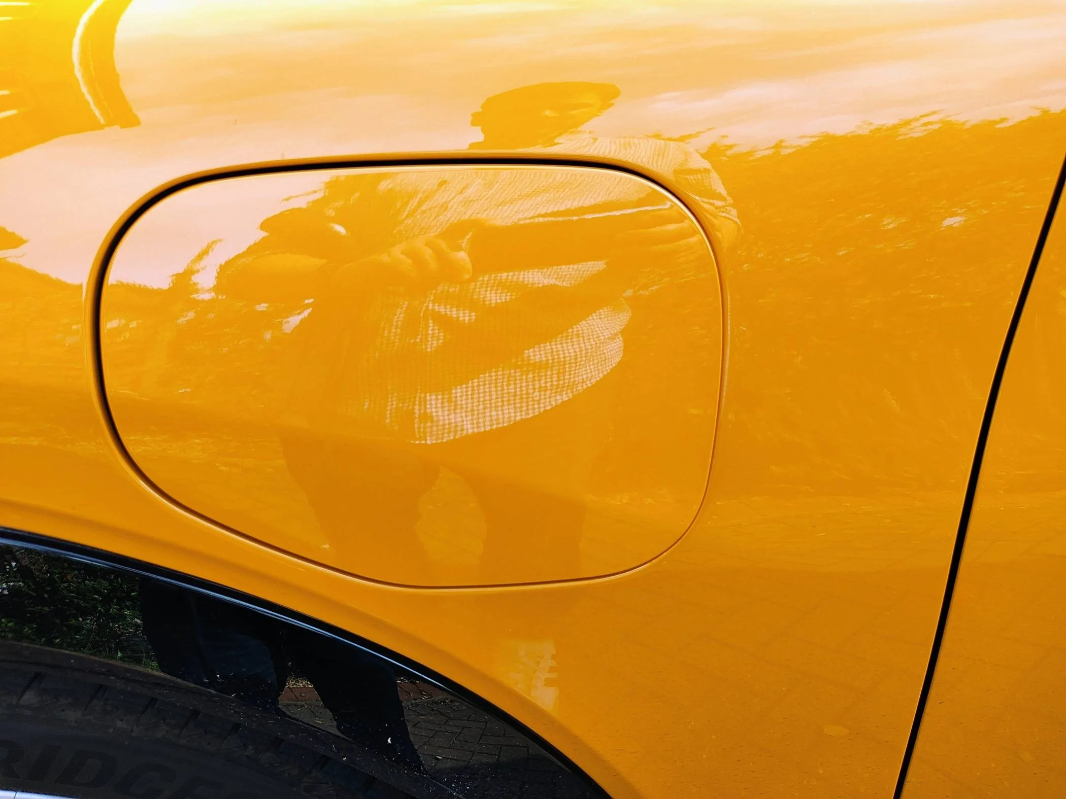

My electric filler flap or whatever it's called is a bit out of alignment as you can see by attached pic. Just needs moving left a bit, or shortening the hinge if you like.
Does anyone know how it's attached or if it could be adjusted?

The painted cover slides onto the plastic mount. Take it to the dealer, they should adjust it in minutes.

Or you could slide it toward the hinge yourself. It has a little detent and a spring loaded lever that should lock it in correct position. It looks like the lever and detent are not engaged with each other. ?‍♂?

Hmm. It's clipped in properly. Wonder if there's any adjustment on the hinge itself.....? Anyone know?

Here's why I said to go to the dealership. They've done these many times. If they break something, or chip the paint, it's on them.

Perhaps you have a good dealer. My local is a 5 week wait to book in and not particularly helpful when it's there. So simple things I'll take the risk on and sort myself.
