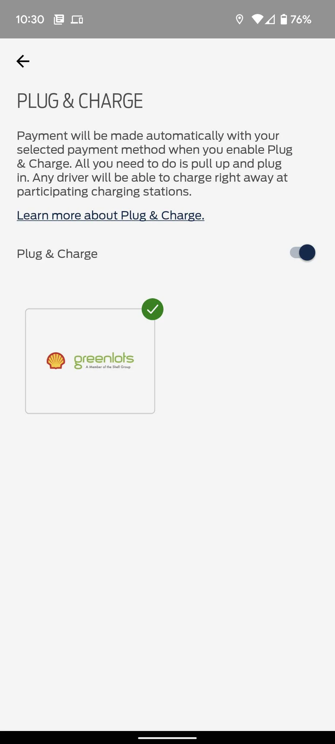

Yes? But it only shows GreenLots and not EA. No option to add it.
Welcome to Canada! ?? lol.. I'm assuming your a Canadian Mach-E owner like myself based on the options shown in your screenshot? In Canada we only get Green lots listed, and there is no Electrify America or Electrify Canada support for plug and charge (yet).
