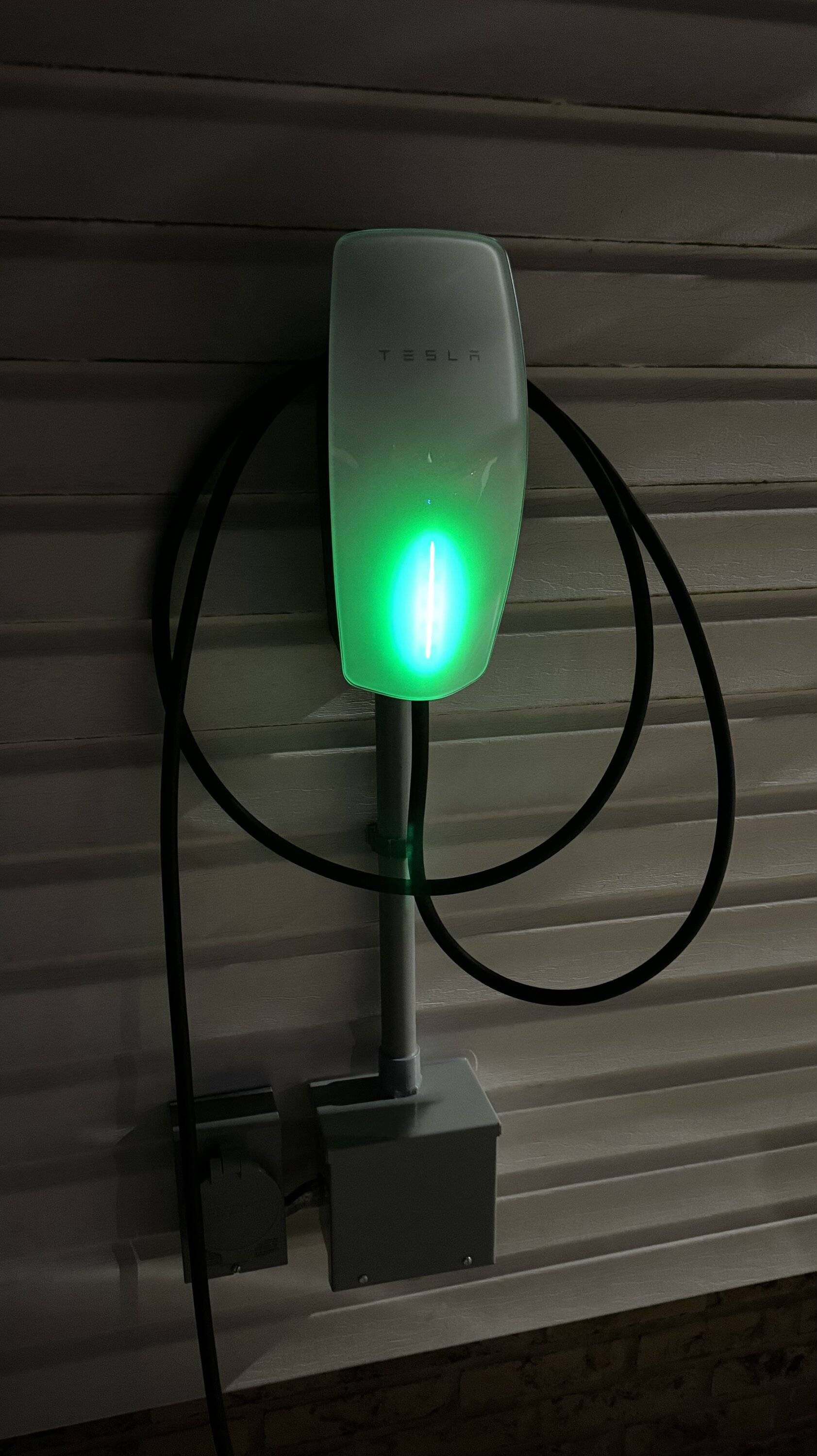

New (Yesterday) install for my truck that I park outside, that I was using an extension under the garage door until last night.
ONLY Tesla I will ever buy - Universal Wall charger to be ready for NACS someday. ?
Ford Mustang Mach-E Charger installed outside. IMG_3542
