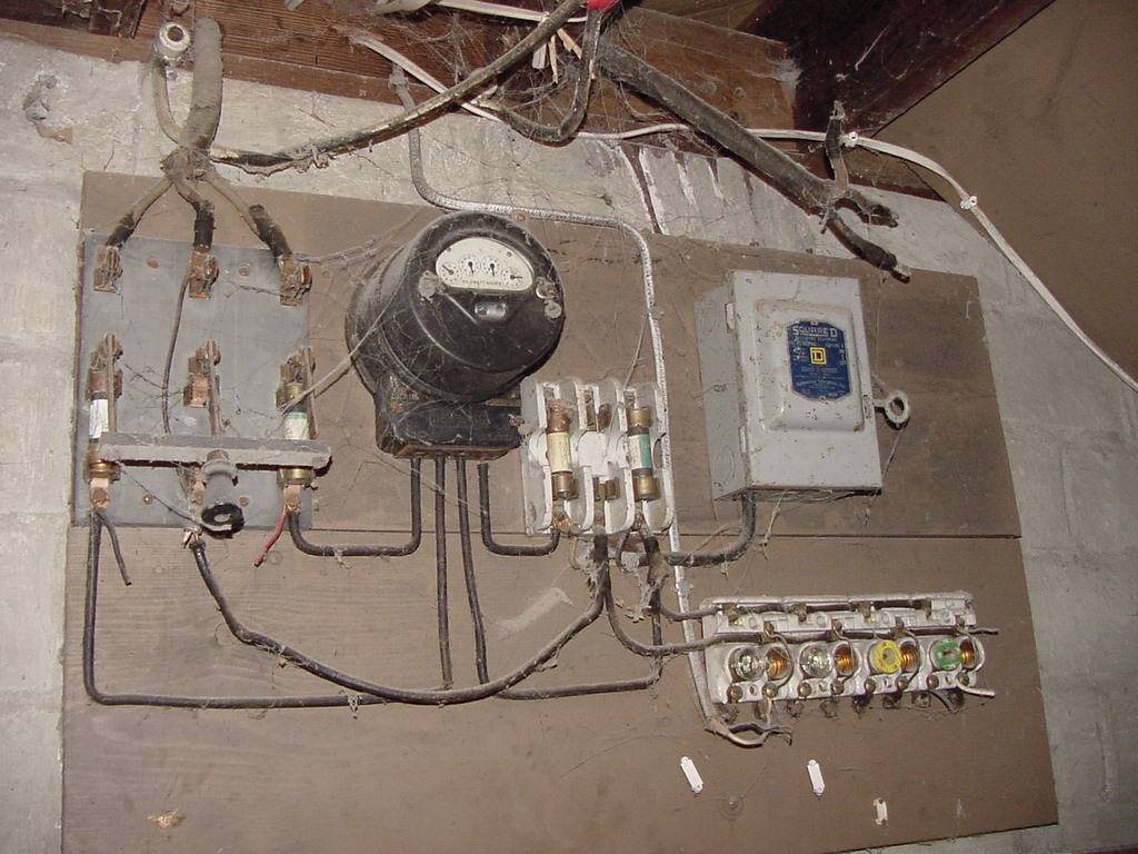

Coulda been worse!
There could have been a clearance sale on vintage knob and tube...

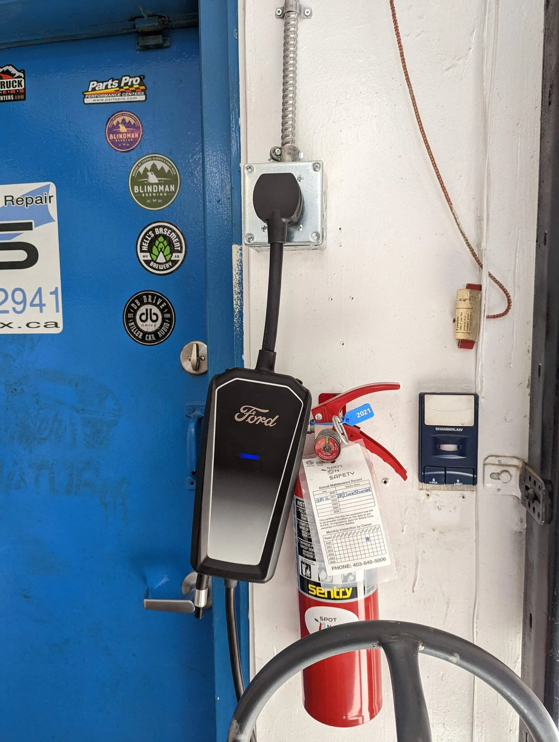

Just had a local electrical contractor install 2 NEMA 14-50 outlets (one at work, one at home) The first two I contacted were too busy, but no drama with the one we used. Telling them it's a 4 wire, electric stove outlet, gives them the right frame of mind, as then the 50AMP breaker makes sense.

Is it bad to leave the mobile charger just hanging off the outlet like that?

I probably wouldn't do it more than a few days here or there. If it were hanging there regularly, I'd use the bracket to take the stress off the pigtail and the plug.
The pigtail is just a friction fit into the main unit. It's a tight fit, so it would likely hold for a while. But over time I'd wonder if it might loosen up with the weight of the EVSE pulling downward (especially if being seated/unseated regularly).
It's also a good idea not to keep much weight hanging from any outlet, as those contacts can loosen up over time too. It will also get jostled and pulled some every time you move the long cable to plug into the car.
