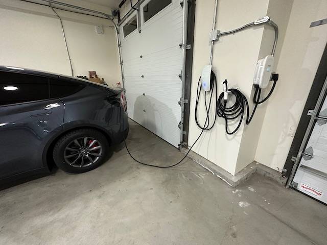

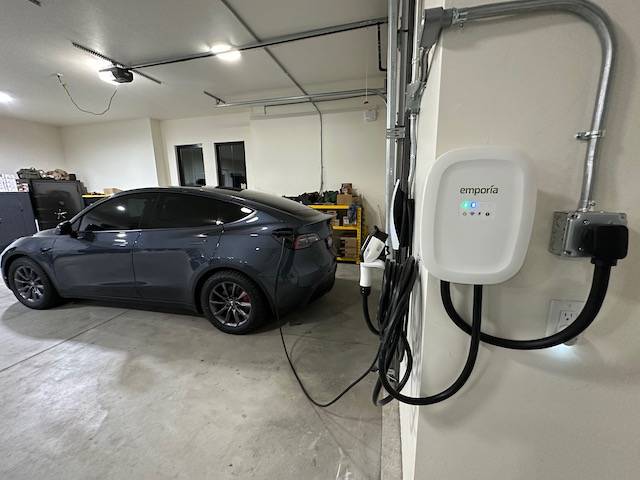

I too went with the Emporia, I liked all the reviews and the features etc. and the price was right. Still waiting for the Mach-E which should be here in two weeks. As of now it works great on my Tesla MYP but wanted the option to charge both EV's at the same time if needed.
Ford Mustang Mach-E 48A L2 Charger Comparison IMG_0059
Ford Mustang Mach-E 48A L2 Charger Comparison IMG_0060
