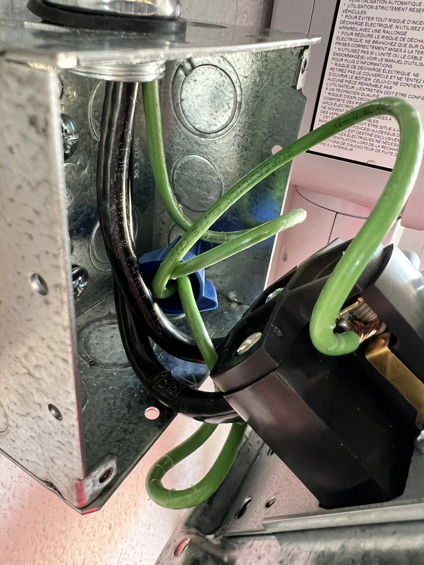

So it gets better.
Ford Mustang Mach-E Adventures having an L2 charger installed 4C9AB664-E7C1-4BA3-88FC-8745D297F671
Yes, that is ground and neutral tied together behind the outlet.
Let’s see how Qmerit handles this. One thing I guarantee, I’m not letting this guy anywhere near my house.

Ouch. I also do not see a red wire in there for the second live wire. Looks like homie used black for both L1 and L2. ?☹?
I'm a licensed master electrician and an electrical engineer, the NEC doesn't dictate wire colors.
Maquis
5,694
8,081
There are some restrictions about ground & grounded conductors.
There are also some oddball exceptions, such as a high-leg delta.
