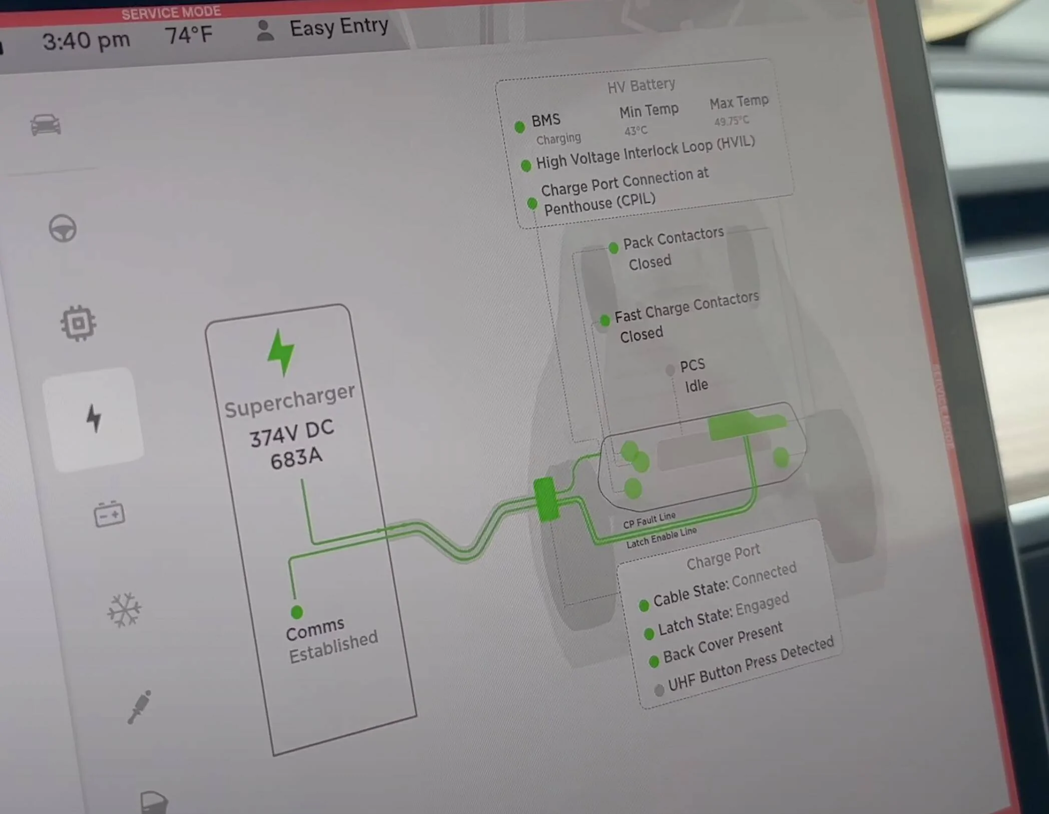

Tesla does amazing things and finds the limit the hardware is actually capable of. Our peak charging rate is limited to only 400 amps, but here's a Model Y pushing 683 amps (255 kW) into the pack for comparison:
Ford Mustang Mach-E Charging Curve...hacking? Model Y DCFC peak
Ford found the absolute limit of what the pack was capable of outputting with the GTPE, I wish they would apply that same derate logic to the DCFC curve to get the max the hardware is capable of doing.

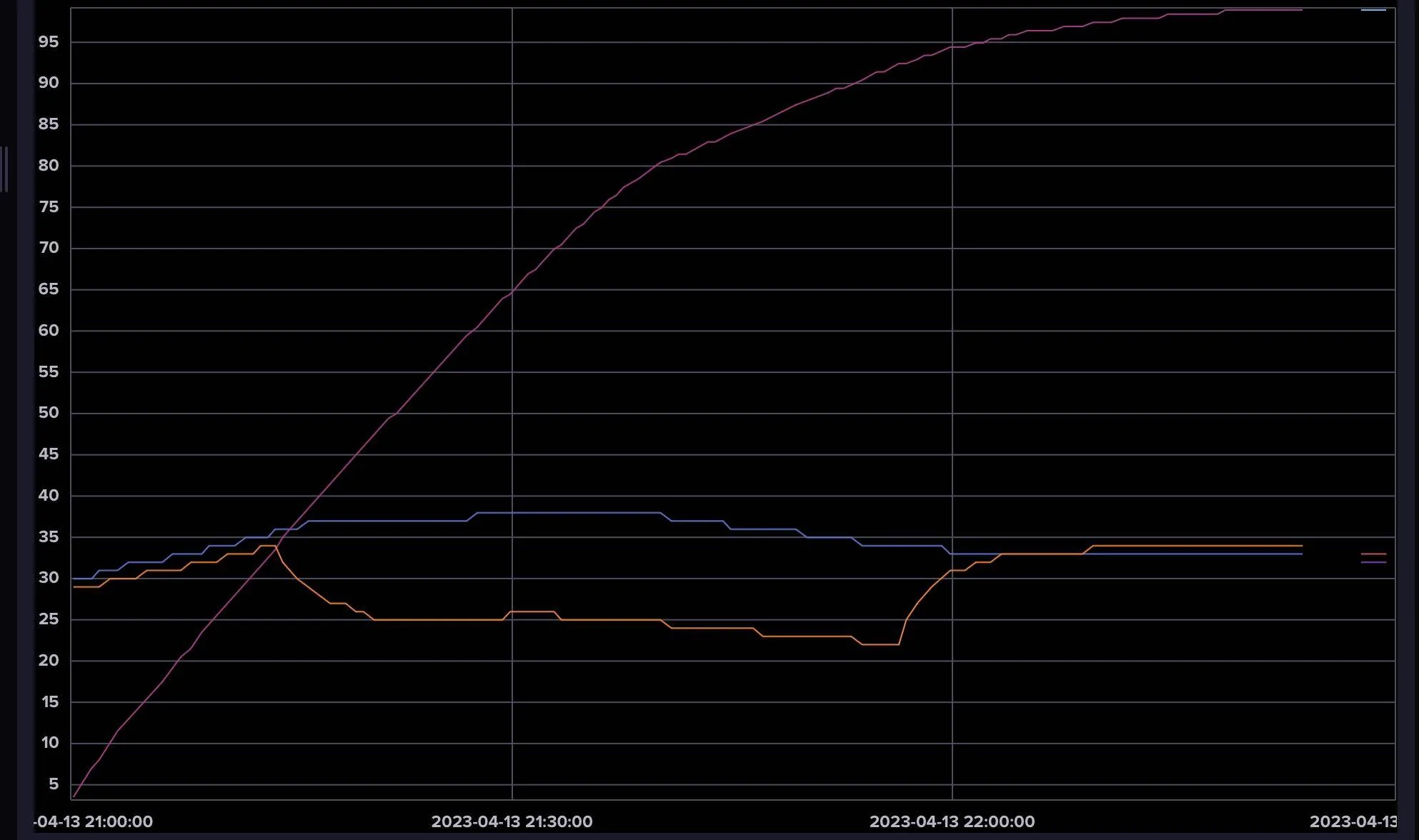

I won't comment on hacking and there isn't anything new here on charging but I am proud of my new DCFC support in OBD Record. Someone wanted to see what a DCFC charge curve looked like and while it can't yet be viewed in OBD Play you can peek at it in the database until I can push an update with the detailed charge views.
This was recorded at an Electrify America 150kW charger, with no preconditioning, looking closely you can see that the battery temperature increase was due to charging and that at about 35% SoC the MME started cooling the battery (purple SoC in %, blue HVB temp ℃, orange HVB coolant inlet temp ℃).

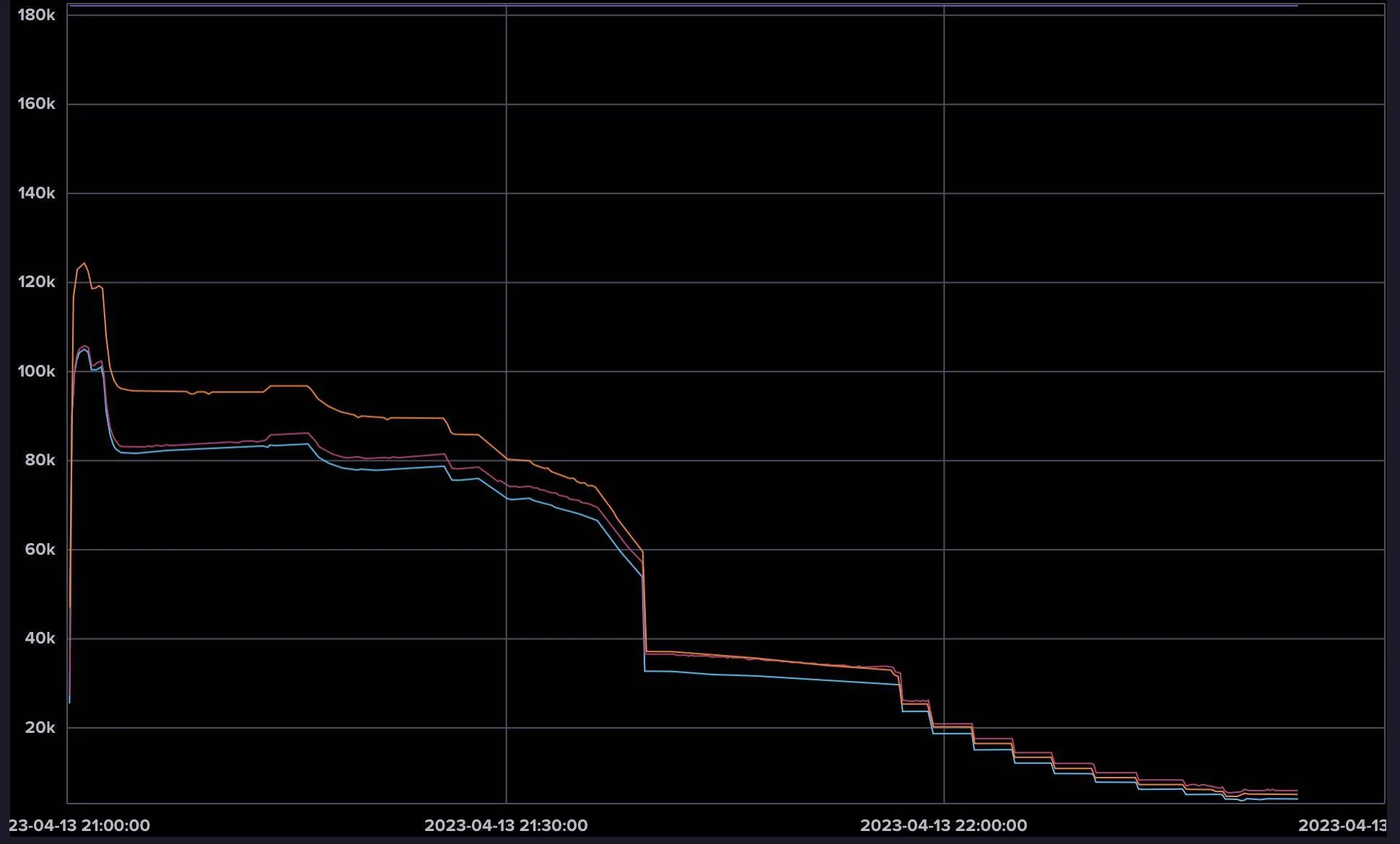

The charge power curves are here:
purpleEA advertised power (constant 180kW)
orangekW requested by MME
purplekW at output of MME charger module
bluekW delivered to HVB
Ford Mustang Mach-E Charging Curve...hacking? 1681511226456
Starts off requesting 125kW but within 3 minutes it has dropped to below 100kW where it stays for the next 14 minutes. The big step down occurs at 80% SoC where the requested power drops from 60kW to 37kW.
39 minutes to get from 3% SoC to 80% SoC, 44 more minutes to go from 80% SoC to 100 SoC.

Why is there a ~20 kW discrepancy between requested and delivered power that decreases with time? Are you using actual pack voltage or target pack voltage to calculate the kW? The traces should all be very close <6 kW difference or there's some kind of problem. You should graph the amperage curves and make sure they have the same pattern as the power curves.

39 minutes? Based on this curve, this must be a SR pack not your GT?
