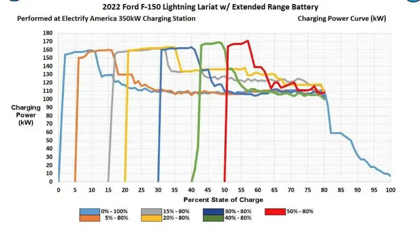

Ford seems to have a current*time based curve. If you plugin at 5%, 10%, 20% ... 50% do you get the same basic curve (up to 80%) despite higher starting SOC? This is true for the lightning.
Also, has anyone tried unplugging and replugging in the same session to see if you can get higher rates? Doesn't seem like it should be possible, but maybe?
EDIT; Found this video, maybe supporting this idea? He re-plugs at various SOC's and power changes each time.
