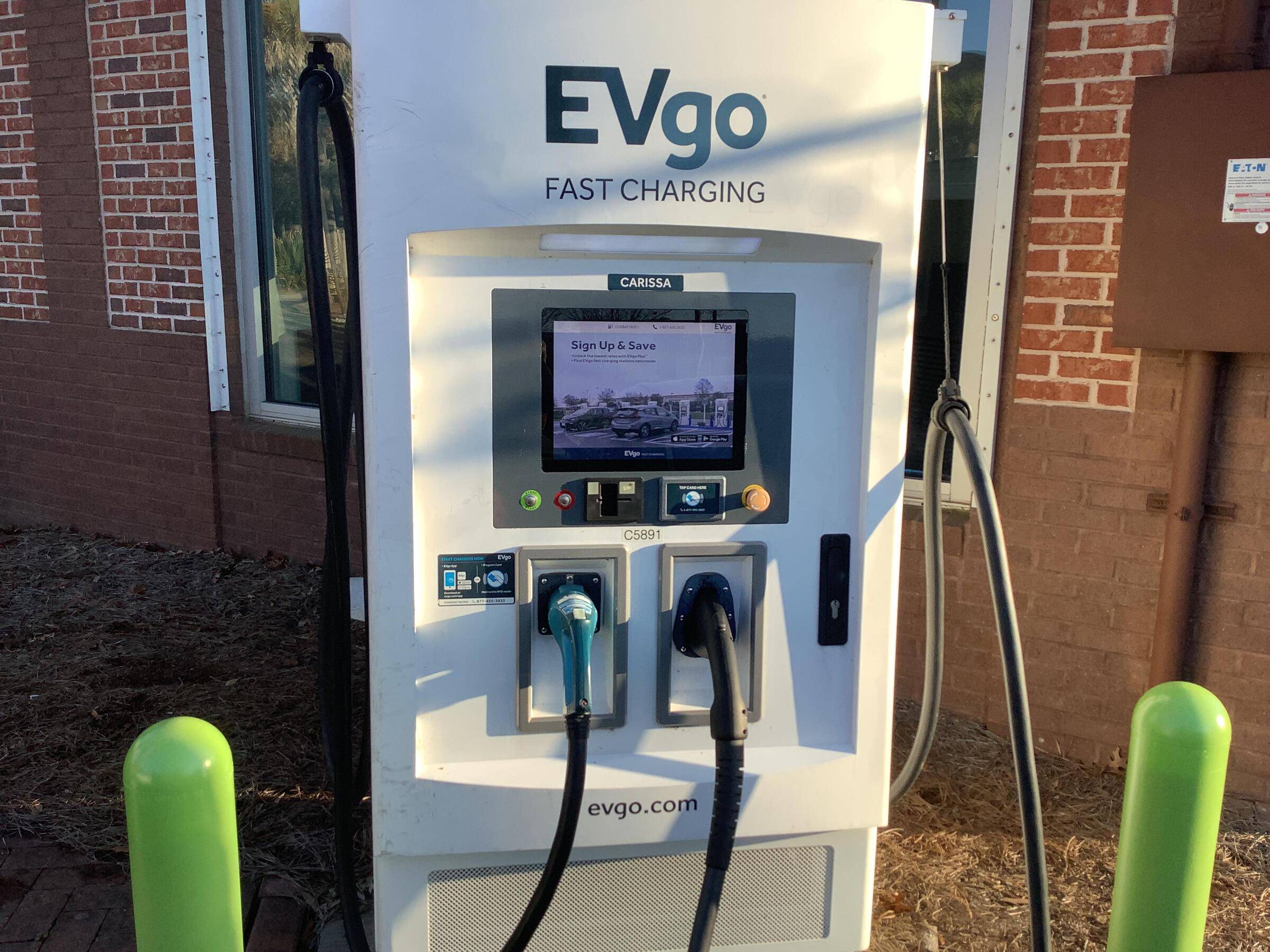

titan2220
Matt
Nov 7, 2021
52
Hartford, CT, United States
2021 Mach E AWD SR
This is the model EVgo charger that constantly fails on me. I had a 100kwh newer one work just fine. Frustrating that these are the most prevalent around me.
