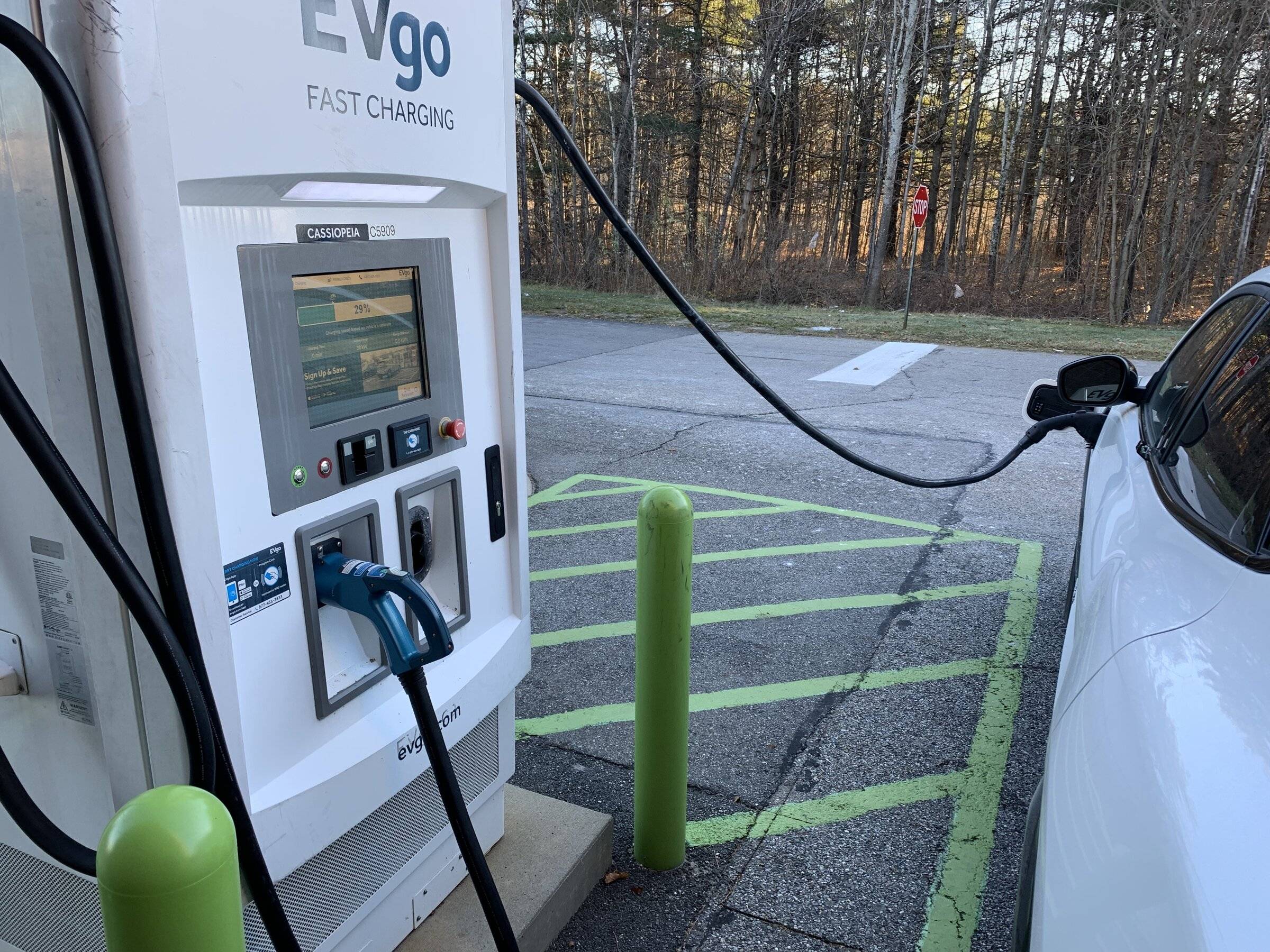

This EVGo type works with my Mach E. Not super speedy.
