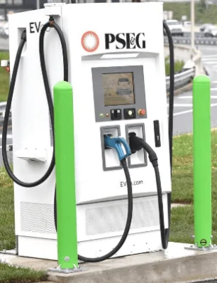

No they look like this, minus the logo

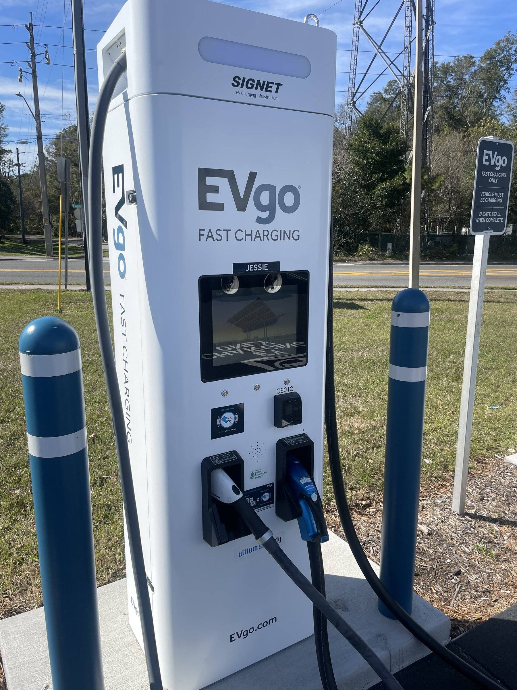

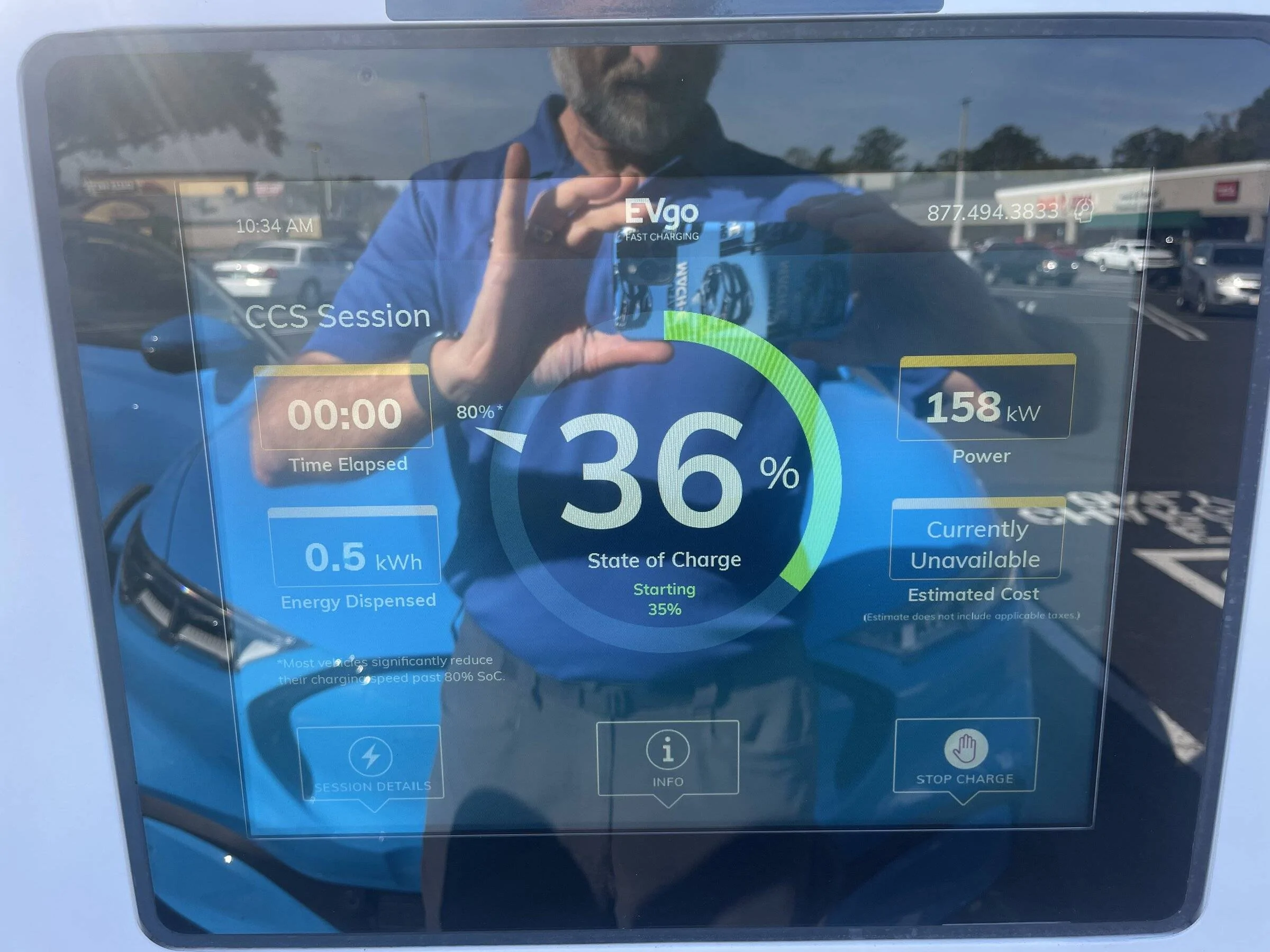

There are some really great new EVGo chargers that are very high power. I used a multi-network RFID card to start the charging session.
Ford Mustang Mach-E Charging @ EVGo IMG_9470

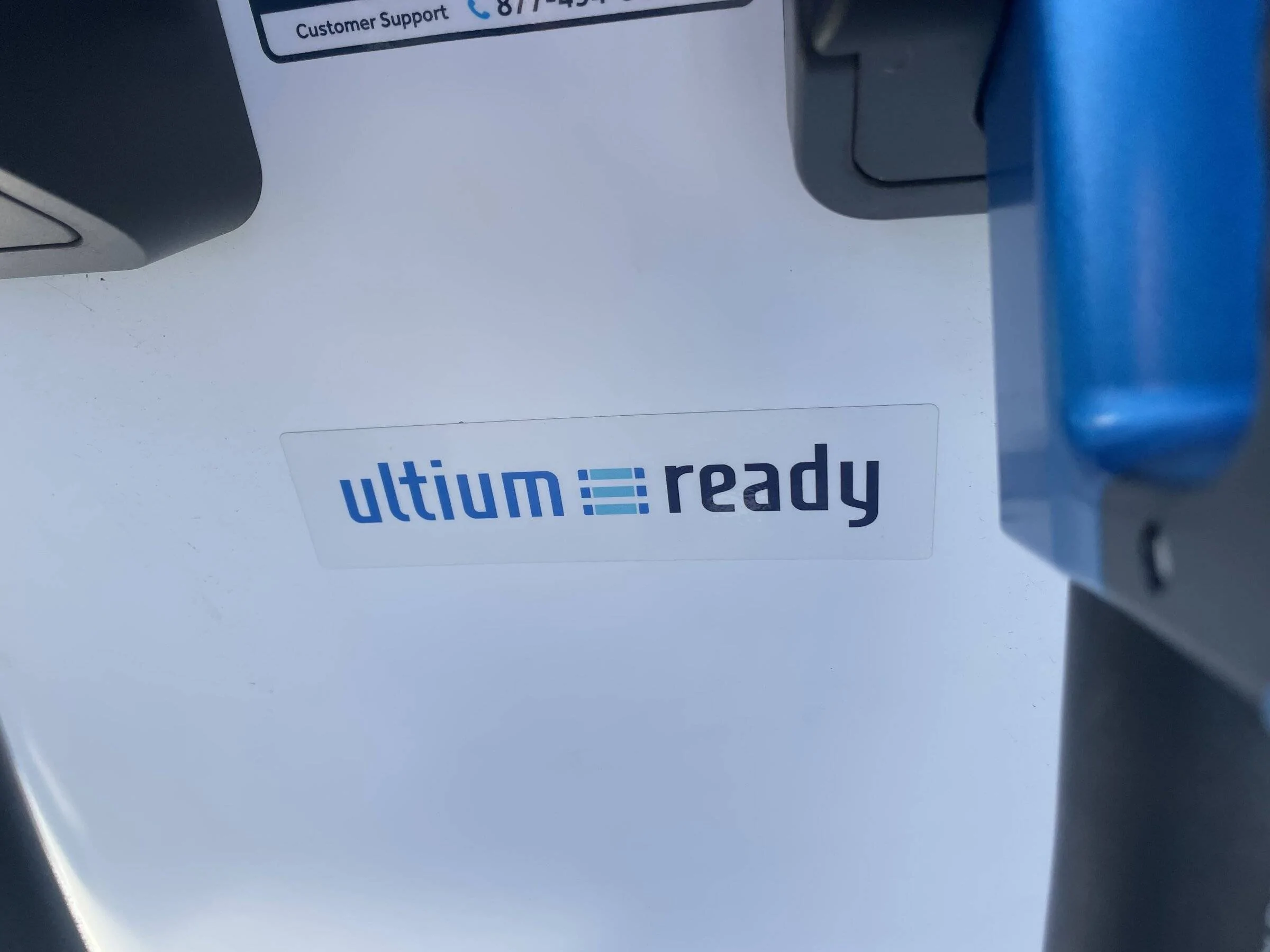

These SIGNET units near Jacksonville are listed as "Ultium Ready", which I assume means they can handle 800v charging.
Ford Mustang Mach-E Charging @ EVGo IMG_9471

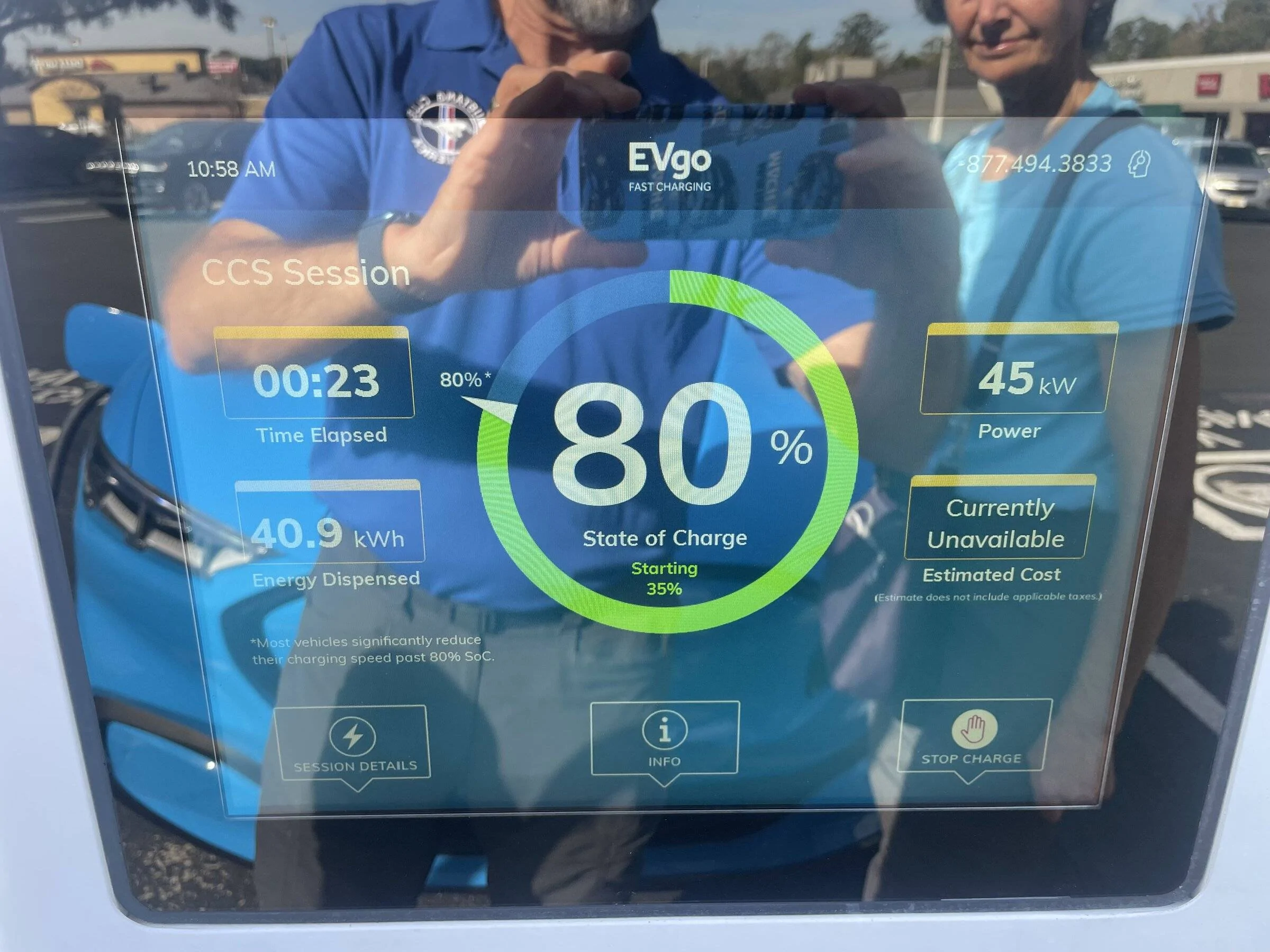

They are definitely fast and peaked at over 150kW for the initial burst.
Ford Mustang Mach-E Charging @ EVGo IMG_9473
They also held at 45kW above 80% for Marlin with the new 21P22 software update
Ford Mustang Mach-E Charging @ EVGo IMG_9476

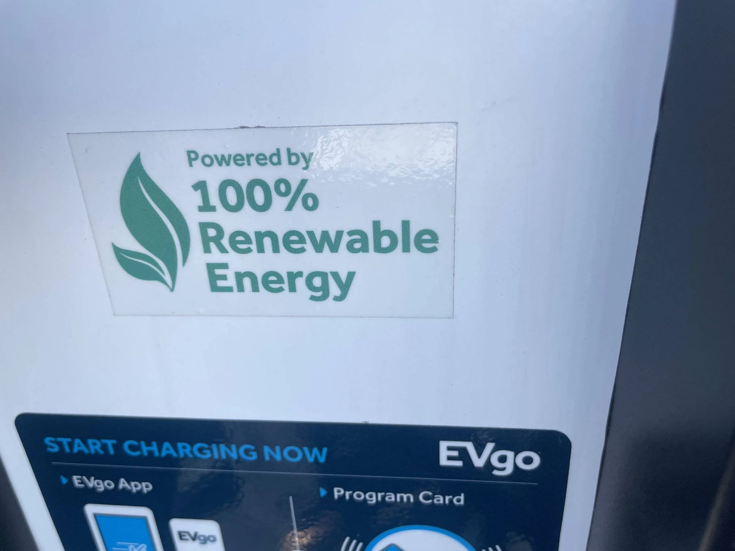

In a nice environmental touch, they purchase renewable power for them.
Yep I got 164kw peak charging on Mario at Volusia Mall EVGo

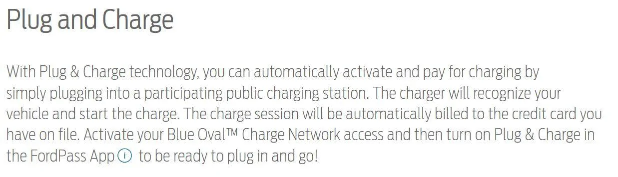

You have me thoroughly confused. EVGo isn't part of Plug & Charge. So, am I just reading this wrong?

Ok but that's not Plug & Charge. That's plug, go into the app, select the charger, hit activate and pay through your Ford Account, which is just an "In-Network" charge. This would be identical to using the native EVGo app if you have it.
Plug & Charge is charging just by plugging in, no app needed. My confusion is because @connoisseurr is using EVGo and Plug & Charge in the same breath.
