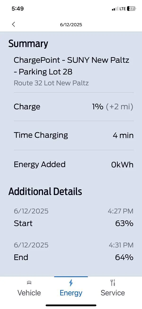

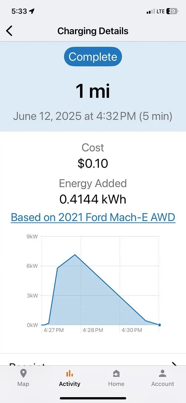

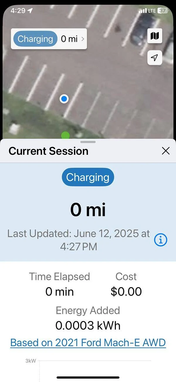

I know you like a good mystery, so I'll continue on....
After exchanging information with Grizzl-e support, they concluded that the error was not in the EVSE, the error is with the car. Eager to prove them wrong, I headed to one of the local ChargePoint stations.
The car started charging. I sat down to read the news. And then the car stopped charging. No errors... just stopped.
