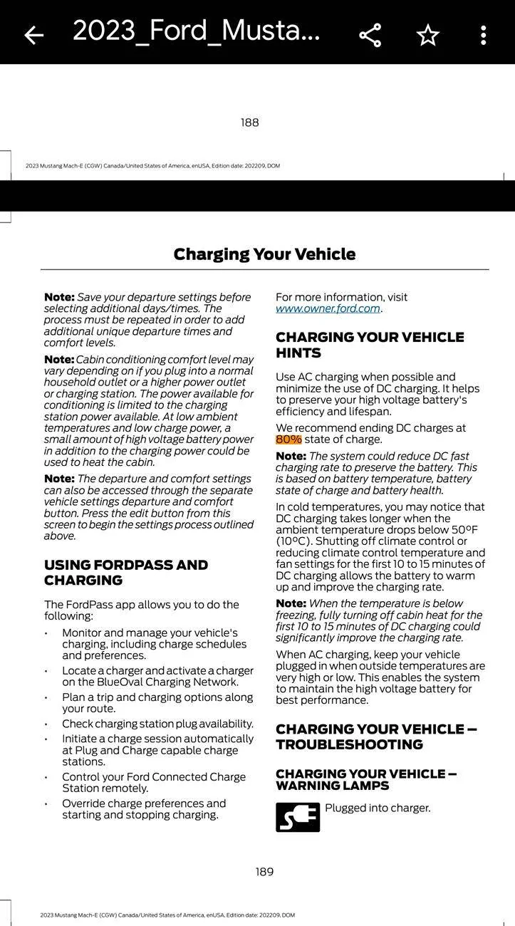

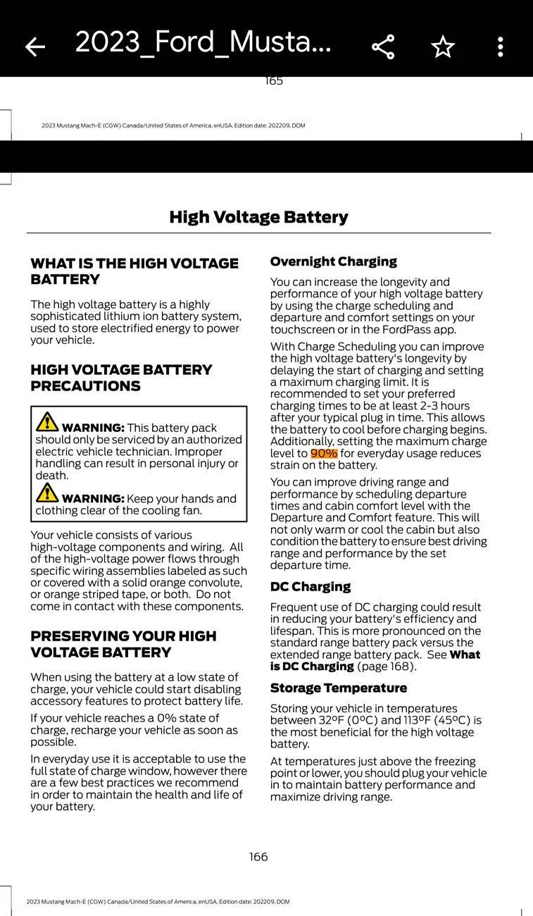

I own the print version manual in addition to keeping the digital copy on my phone for easy reference. I read it when I don't know something but ask here if I can't easily find it in the manual or a search of the forums first.
Not sure if my 23 manual has been revised since, but here's what I could find on charging.
The way I understand is is if we had full use of all the battery capacity, 80% would be the limit. With us not having full access, 90% is recommended for L2 and 80% for DCFC but of course this topic has been discussed a lot... So charge the way you want? ?‍♂

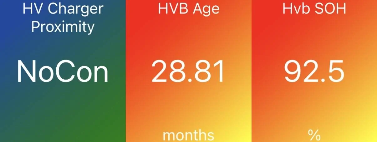

I’ve seen all sorts of recommendations out there. I tried only charging to 80%, and charging every day recommendation on one the hundreds of threads on this topic. I checked the battery health in Dec after owning my 23 GTPE for 2 years and it was down to 88%. I used my Emporia charger at 48A when charging. I have only DCFC a handful of times since I use the Mach E for commuting back and forth to work (45 mile round trip).
I saw another thread that said you can get your battery heath up by limiting charging amperage, cycling the battery down to a lower percentage before charging. Also, every once in a while charge to 100% to do the ”cell leveling.” I have backed the My Emporia EVSE to 28A. I now charge only once or twice per week. My battery SoH is now over 92%. So my answer to you is you do you. Find something that works, and go with it. Don’t sweat it.
