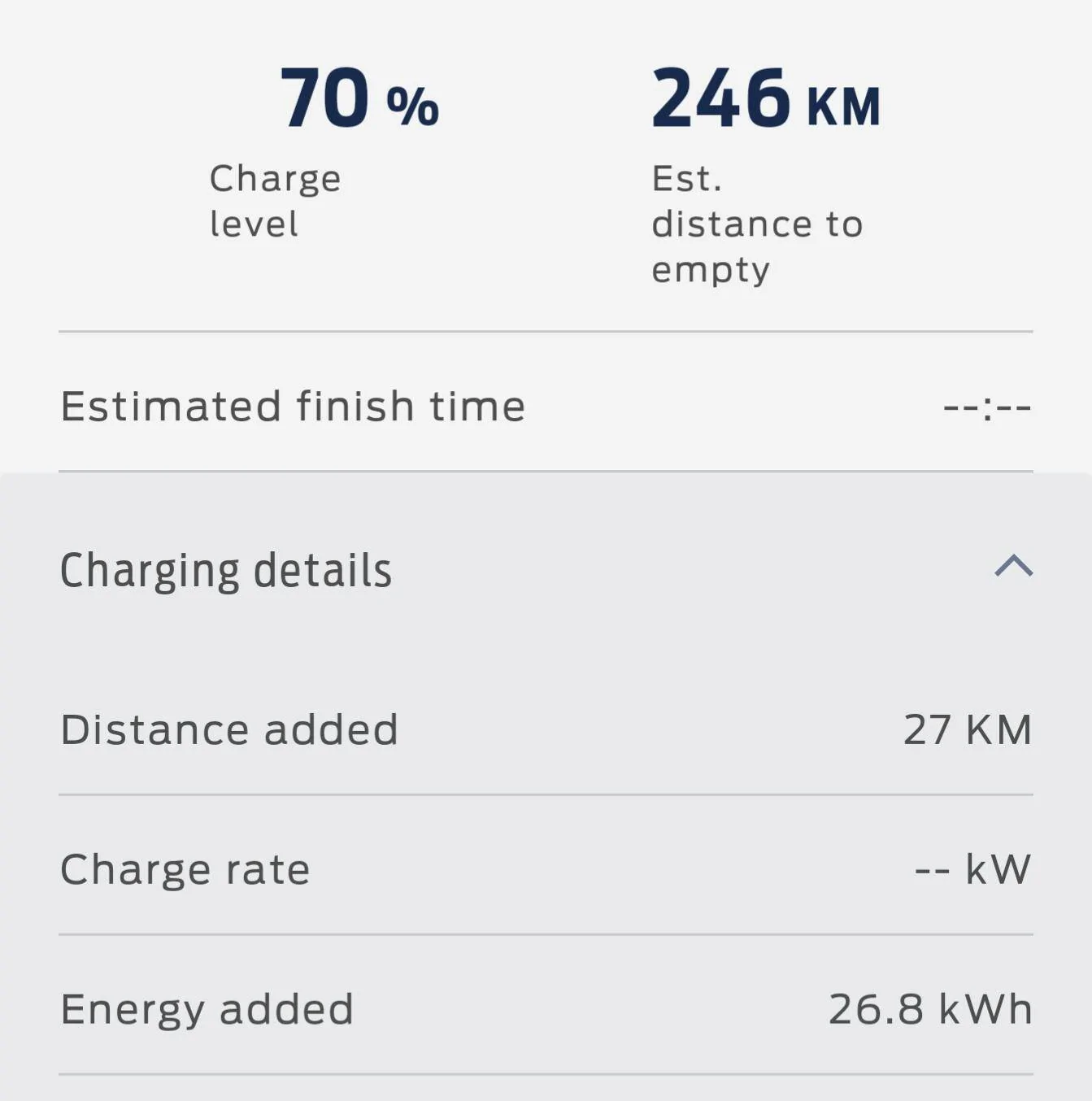

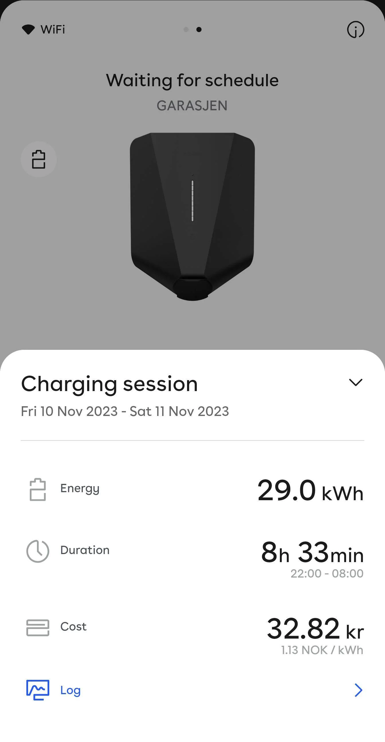

Do anyone know if the FordPass reported charging statistic is somewhat accurate for energy added to the HVB?
Ford Mustang Mach-E Charging efficiency (home charging) Screenshot_20231111-140121
Ford Mustang Mach-E Charging efficiency (home charging) Screenshot_20231111-140112~2
Latest session, without preparing for drive.
This give a approximate loss of 2.2kwh for the session - witch makes the loss in the range of 7-8% (7,59% if you believe that the decimals make sense ?)
It's not that important, but I'd like to know approximately how efficient the Mach e is ...
It will probably vary from SOC, battery and ambient temperature, etc. but still ?
This is ”Normal charging", that in ?? is known as L2 charging (230V/32A single phase) BTW

26.8 kWh / 29.0 kWh = 92.4% efficient charging. Normal.
