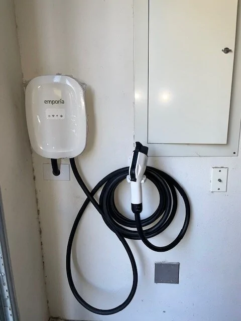

My Emporia is 48A hardwired to 60A breakers and provides 11kW of power.
18 months of use and never a hiccup.
Perfect and fast enough for a L2 home charger.
Shared between 2 EVs.
