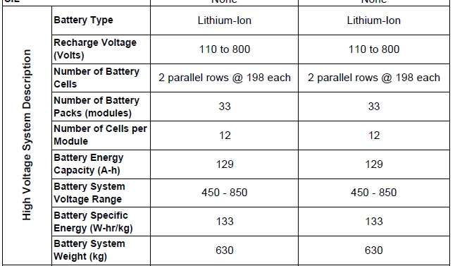

Yes - to get higher charge rates with 400 A current limit (SAE DCFC standard) requires higher voltage batteries; the Audi, and iD4 I think, have ~ 400 V nominal battery packs - 110 cells in series? Rather than 94S / 342 V (ER) or 96S / 350 V (SR) nominal in the MME. The Taycan has 198 cells in series for about 720 V nominal. From the EPA cert data document:
Ford Mustang Mach-E Mach-E Extended Range Battery buffers and DCFC limits 1613842314651
The VW group seems to be the only one exceeding max DC voltage of ~ 400 - 425V so far.
There are good (human) safety reasons and common electrical component rating reasons to stay with ~ 350 V nominal.

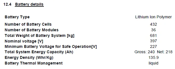

Edit - correction, Audi probably uses 108S. There is a lot of mixing of max vs nominal voltage for battery packs by manufactures. From the EPA cert data: (4 modules in parallel, 9 modules in series, 12 60 Ah cells in series per module)

Yes - to get higher charge rates with 400 A current limit (SAE DCFC standard) requires higher voltage batteries; the Audi, and iD4 I think, have ~ 400 V nominal battery packs - 110 cells in series? Rather than 94S / 342 V nominal in the MME. The Taycan has 198 cells in series for about 720 V nominal. From the EPA cert data document:
Thanks. Agree with going over present nominal... most standard motor drive power supplies likely won't do more than 500VDC. Once over that, you are getting into low volume "custom" equipment, which costs $$$$. I'm sure it's why the Taycan price is what it is :rolleyes:.
