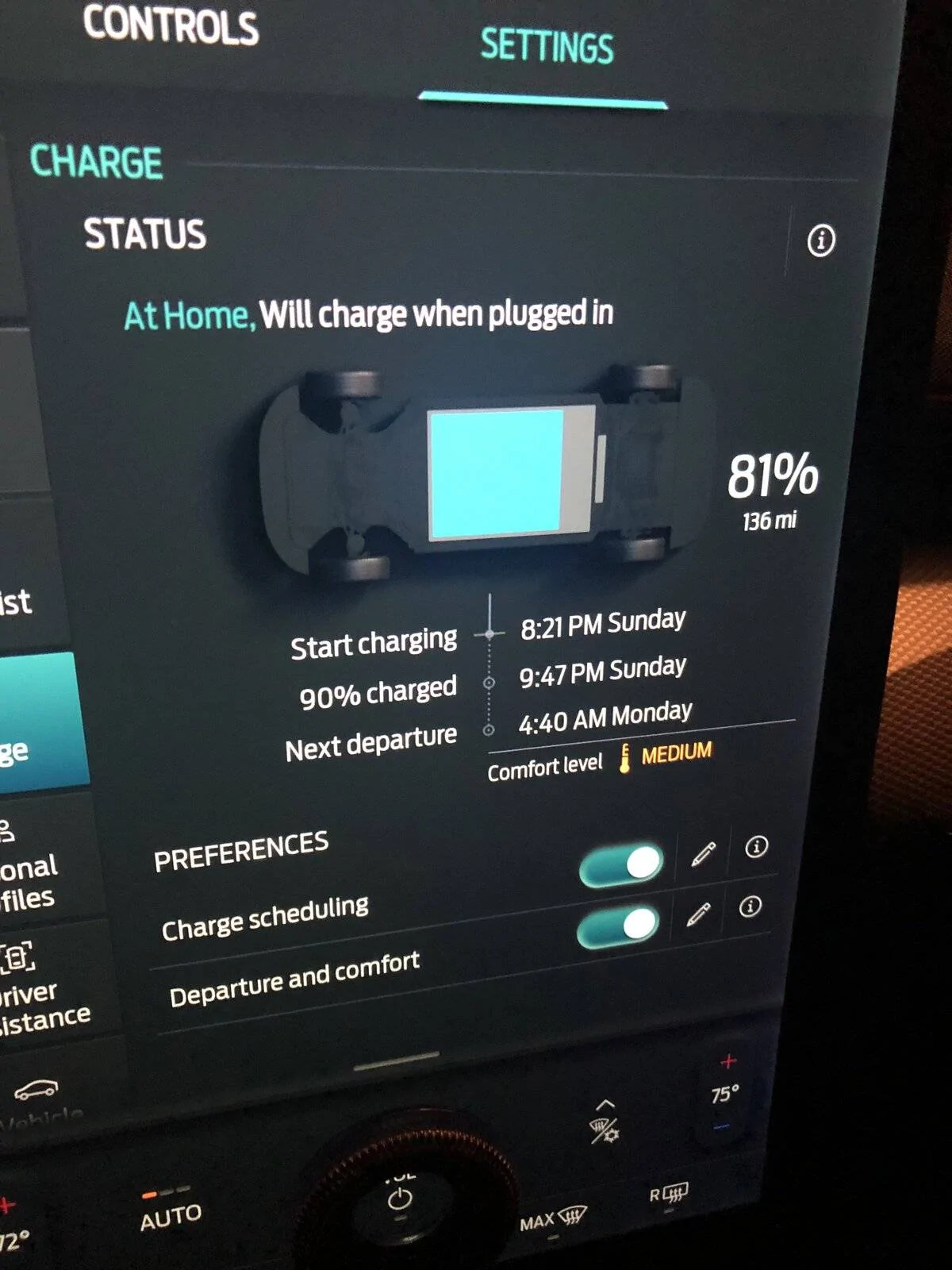

Judging by the screen shot.....
The car will charge when plugged in and will stop at 90% which would be around 9:47 pm. We can't see if a schedule window is set so it could be anytime or inside the window.
Looks like the OP has it set correctly to me. I have my car set to charge anytime during the weekends but only to 90% so setting a schedule shouldn't matter here. Does your car behave differently?
I've always used the scheduled times feature so I'm not sure. But @hybrid2bev and others have helped a lot of people out with the problem of charging to 100% while in "charge when plugged in" mode, even though the user's preference is to charge to less than 100%. It's either a confusing UI or a misbehaving one, I think?
I'm surprised yours works correctly but maybe it's because you've go the M-F schedule set up (as opposed to none).
Yes. For Home location, I currently have it set to charge weekdays 11pm to 7 am and weekends are anytime. 90% limit.
Oh wait.....I think you are talking about the setting in FordPass. Yes, if "Charge when Plugged In" is selected then it won't use the preferred charge settings.
That same phrase in Sync is different.
Yeah. Super confusing.
