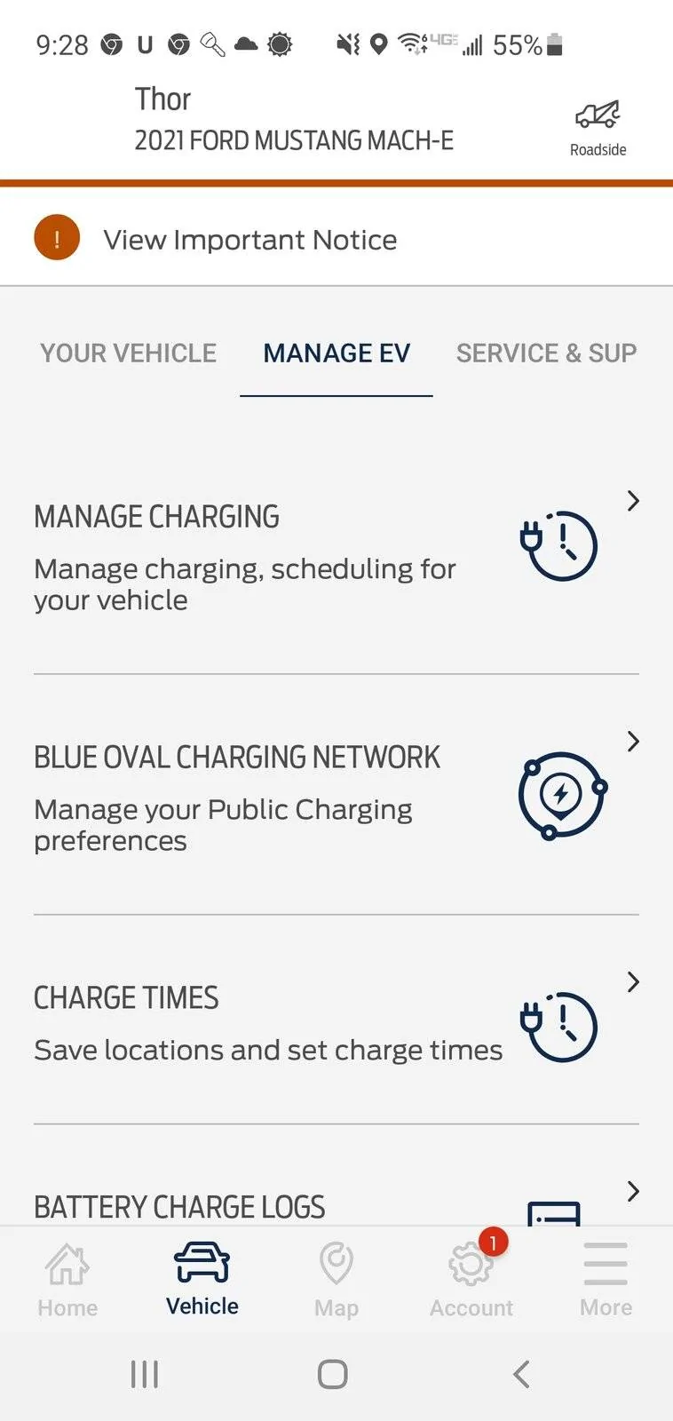

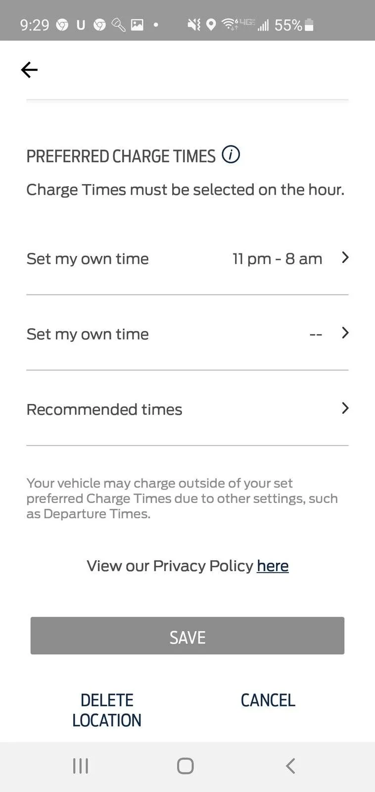

Some have experienced an issue where the car charges to 100% irregardless of the settings so you may be in that group.
Changing the settings in FP.
Vehicle page
Manage EV tab
Charge Times
Select your location >
Change percentage
Then scroll down to find the SAVE button. (That last part tripped me up for a while.....)

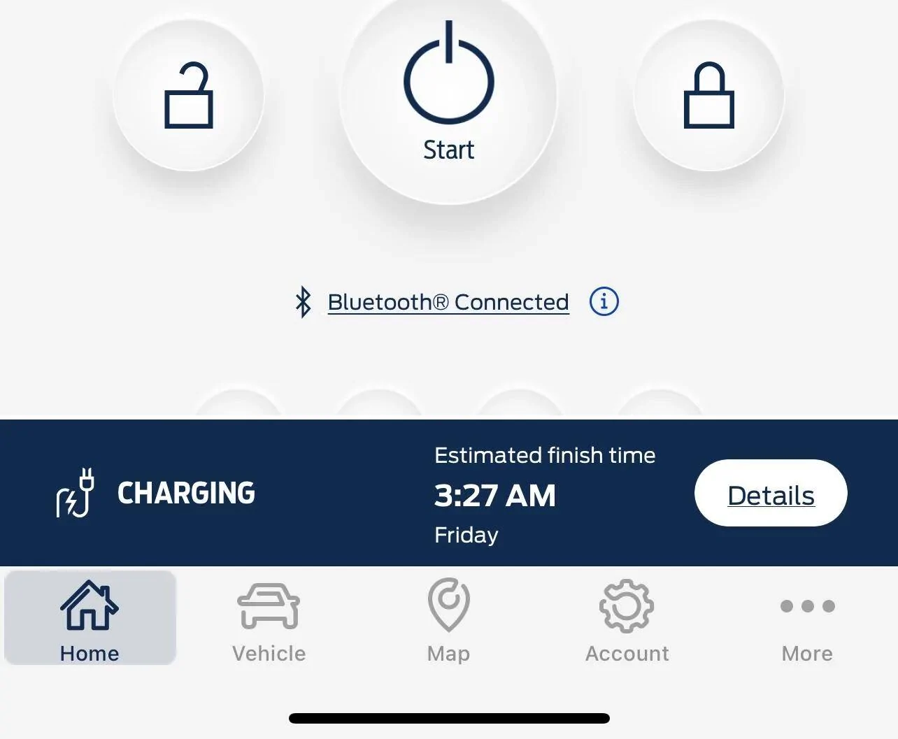

It's much simpler than that. When charging, you should see something like this:
Ford Mustang Mach-E Charging question 1627962668986

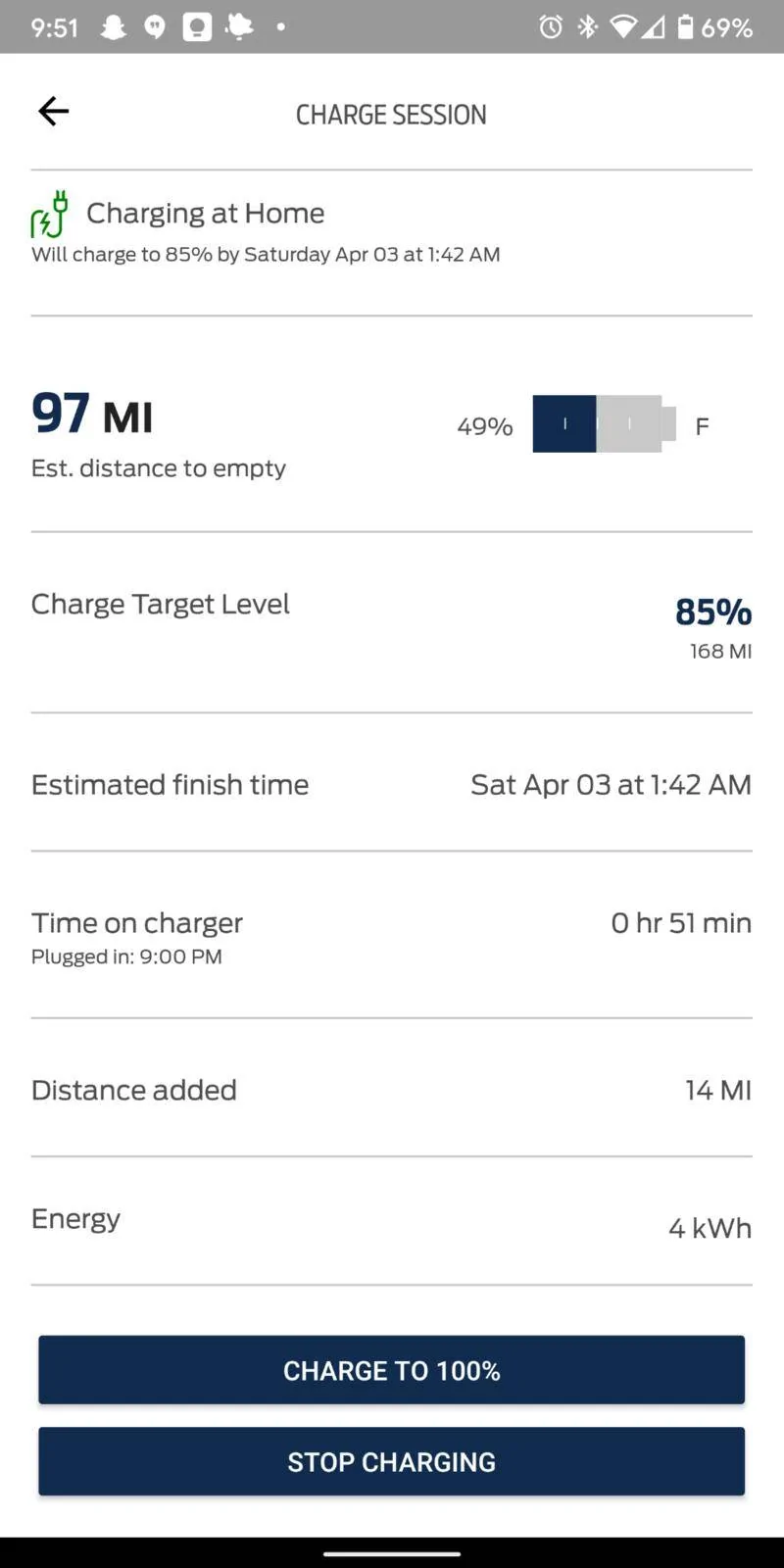

Click on details, then you should see this
Ford Mustang Mach-E Charging question 1627962744267
Click on Charge to 100%
That's it. It doesn't change your schedule and works every time for me.
