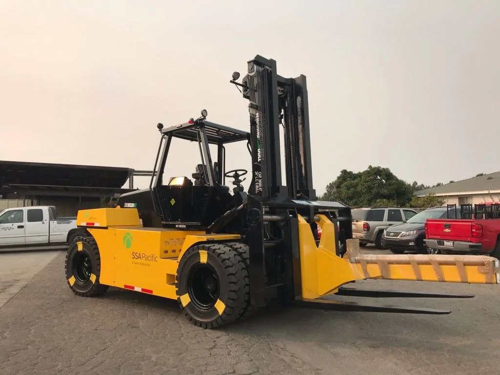

The 2 year old Wiggins eBull 36,000 lb capacity forklift also requires 800V charging (not available for public roads, though!). I convinced ChargePoint to move up their CPE-250 1000V charger development about 3 years ago, since Wiggins was delivering 18 units to the Port of Stockton and ABB was the only company offering 800V DCFC capabilities back then in the olden days (2018), and they had 6+ month lead times. ChargePoint came through in time. First unit was placed in service late 2019. Lots of truck and vehicle companies are following my lead now! LOL! The right side of the forklift used to be a diesel fuel tank, now has 2 of the 4 large battery boxes on board behind that sheet metal. The other two are in the center behind the operator. Each battery box weighs over 600 lbs.

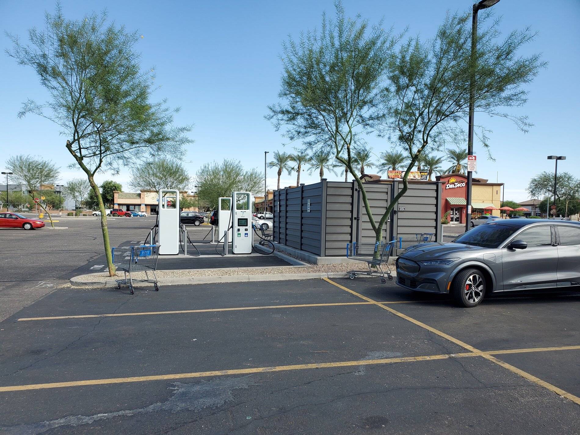

The EA out by 101 and Camelback has the capability to charge 800v EVs. I think it's just one of the dispenser units though. That one in the back, right hand side I think.
I think the way it works is the amps are about the same but since the voltage is higher than it can deliver more kW to the vehicle.

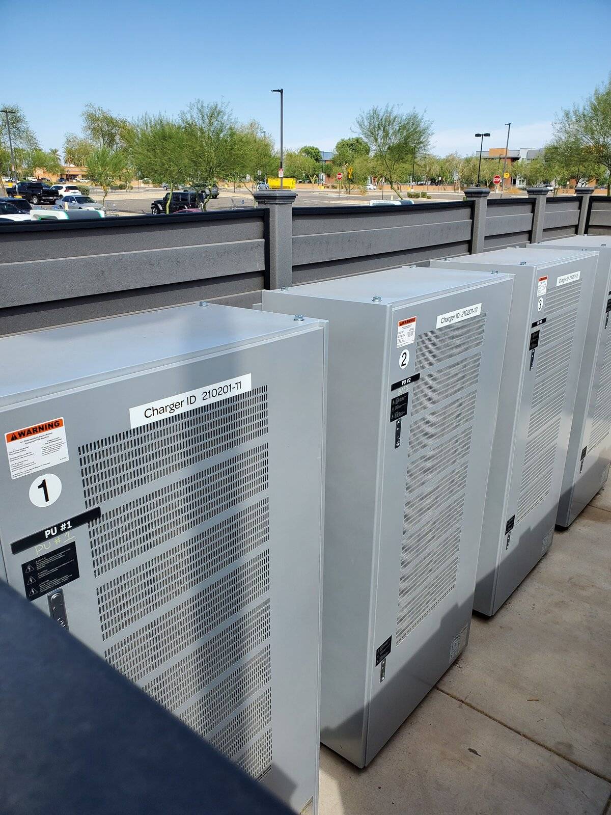

There are battery modules for each dispenser unit. They are located behind the enclosure. As best as I can tell, the battery modules are all 460 nominal units so in order to charge an 800V vehicle they need to pair two modules together. Not sure how they accomplish that exactly. There must be some massive contactors inside those modules stored inside the enclosure.
Standard transformer into those units is 480V AC. They rectify it to DC, then step it up to the necessary voltage. Those gray boxes are the power converters, not batteries.
I have charged at those units. They are all rated the same, 150KW output at those.
The units at the Walmart in Buckeye, I-10 and Watson Road, just got Tesla batteries installed, those are in addition to the power converter boxes. They have the older ABB units, two 350KW and two 150KW.
Interesting. Thought for sure those were power storage of some kind. Demand charges must be crazy there. All the DCFC devices that we have experienxe with contain energy storage devices to smooth the peak demand down to a manageable level. Those seem awfully large for transformer but then again....it's 500A so that isn't anything to sneeze at.

@AZBill is spot on with his comments about current, voltage, and charge rate. Our battery systems don't taper down much until 90% State of Charge, but it is due to limiting the charge rate to 0.85C or less until then. We have 100 kWH aboard, but the systems engineers limit the charge rate to retain longevity of capacity. Max charge rate is 85 kW on our system. So, a recharge from 10% to 90% takes about an hour (if you have a charger that can deliver 90+ kW). The batteries are expected to retain 80% of original capacity after 2500 to 3000 charge cycles - about 15 years for our forklifts. Warranty is for 70% at 7 years.

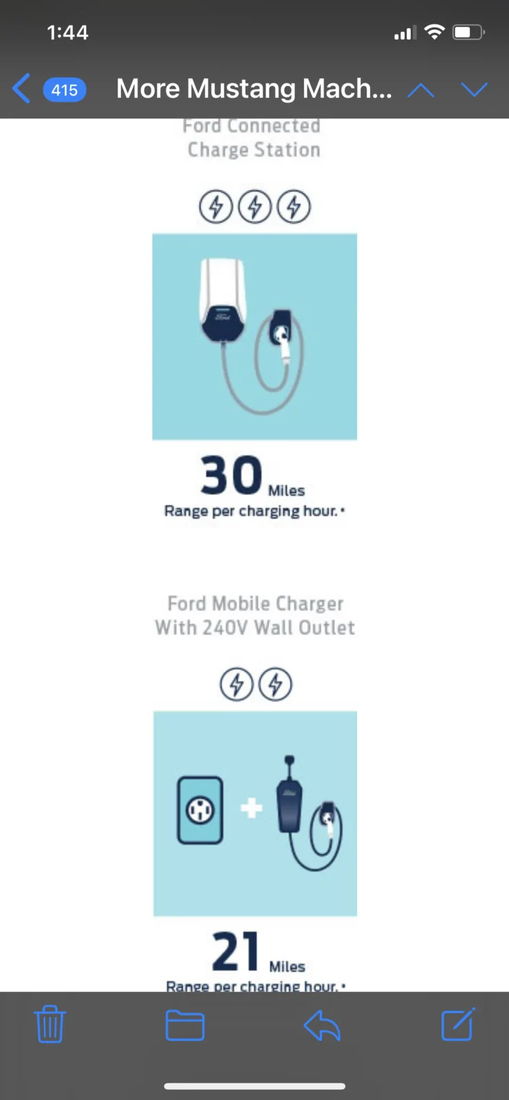

That is a good home level 2 charging rate. I put in the chargepoint home flex with 60 amp breaker and getting slightly above 30 miles in an hour of charging.
I also put in a ChargePoint Flex on a 60a circuit and I charged for the first time this w/e and only got about 11-12 miles per hour overnight. Does anyone know where I should start my troubleshooting? I did have the circuit installed by a certified electrician that I have worked with for years.
I have a ChargePoint at 60A, too. Did you configure it within the app? You can access it from the Menu-Home Charger-Settings. Pick Hardwired and 60A for your breaker. I do not doubt you or your electrician, but go look at the breaker to make sure it is 60A just to be safe.
Thanks - I did check the breaker. I can only configure up to 50a in the app since I am a plug in.
Yes, to get the max, it has to be hardwired. Hopefully, your electrician ran the appropriate gauge wire to the outlet. If not, I'm not sure I would be comfortable with a 60A breaker on 50A wiring and plug.
