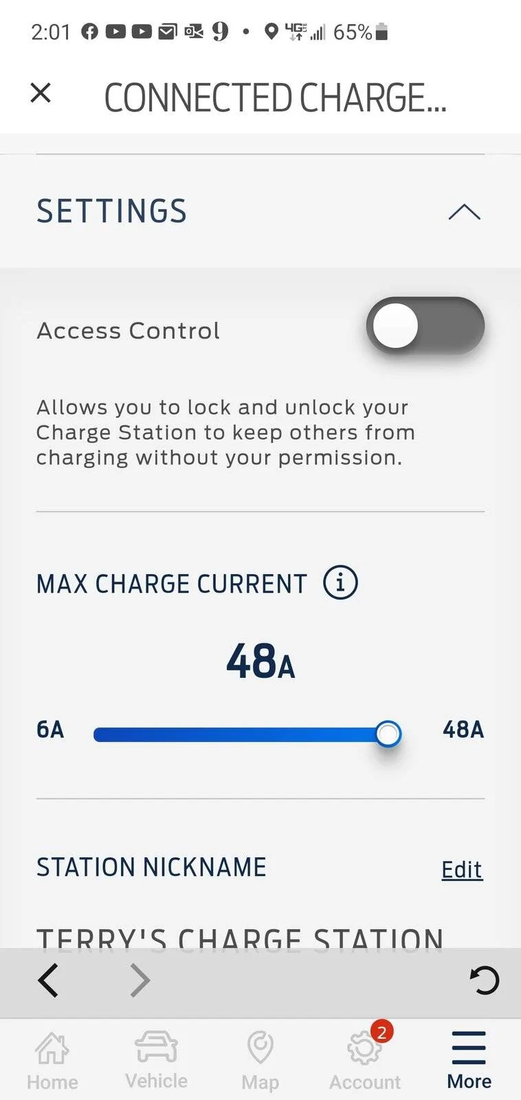

My Mach e sounds like there is a gas powered lawn mower in my garage when charging on my Ford Connected Charger. Like I could here it upstairs when I was trying to sleep. I just had it installed yesterday. I live in Florida and it was 90 degrees out yesterday and the garage was hot. There was only a low humming noise when it was plugged into the 120 V plug using the provided charger. I did notice today on the Ford Pass app there is a setting that says Max Current Charge with a bar that I can move to a lower amp. I may try that and see if it helps, but I bought the 48 Amp unit as I wanted to be able to charge faster.

I never said the noise was being made by my charger. I said "My Mach e sounds like a gas powered lawn mower". My point was that the mach e was much louder when charging with the Ford Connected Charger on 48 amp vs the one provided that was plugged into a 120 volt plug and in the app there is a slider bar where you can lower the amps so that might help.

I did not realize the Ford charging station was scalable like that. Certainly a cool feature. Thank You for sharing.
Got it. Yep, you can lower the current draw in the app. An advantage of the Ford Connected Charge Station - its integrated.
Your connected charging station, delivering 48a at 240v, is delivering 8 times as much power as the mobile charger can at 120v. That creates the potential for a lot more heat to be generated.
also, I was unaware that the Connected charging station was capable of throttling power delivery. That is very cool to know.

So. Today I set the Ford Charging station to 30 Amps as I am not in a hurry to charge. It has been charging for an hour with NO fan noise. I share a driveway with my neighbor and although he does not complain about the noise I will continue to charge at 30 Amps in the future, unless I am in a hurry, and the battery is really low.
