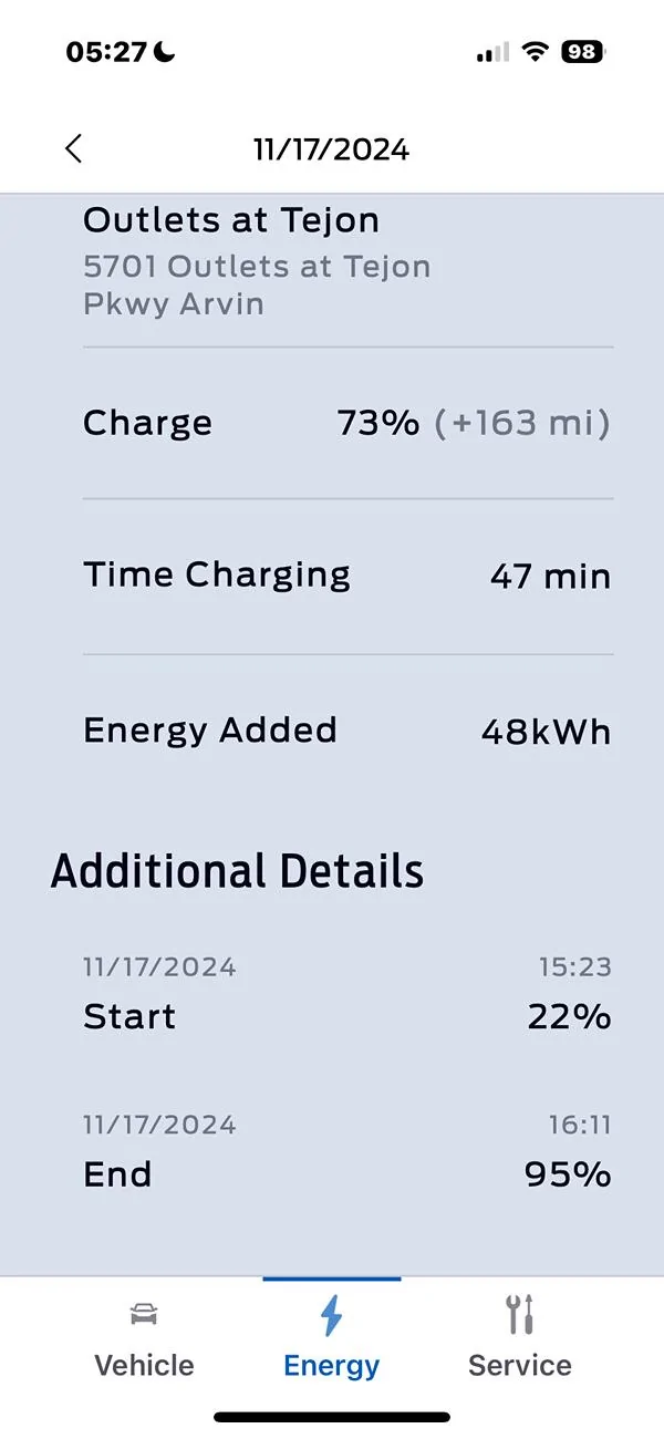

Not AC charging. Should keep full rate until it's almost 100%, then it slows down to balance the cells.
Correct.
L2 charging provides almost the full rate (10.5kW) up till 95% then it slows down as seen on my home charger app.
L3 charging slopes/tapers down after 80%.
Tesla Supercharger yesterday started at 130kW and then dropped to 30kW at 90%.
