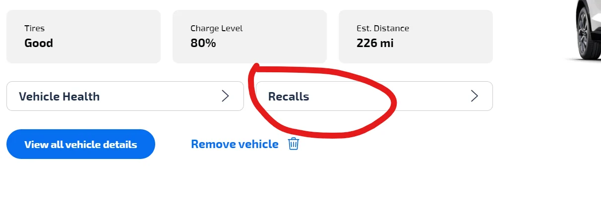

I just wanted to let you know you can check for recalls yourself on the official Ford website thereby bypassing the dealer.
From your 'account dashboard' -- https://www.ford.com/myaccount/account-dashboard, select 'Recalls'.
