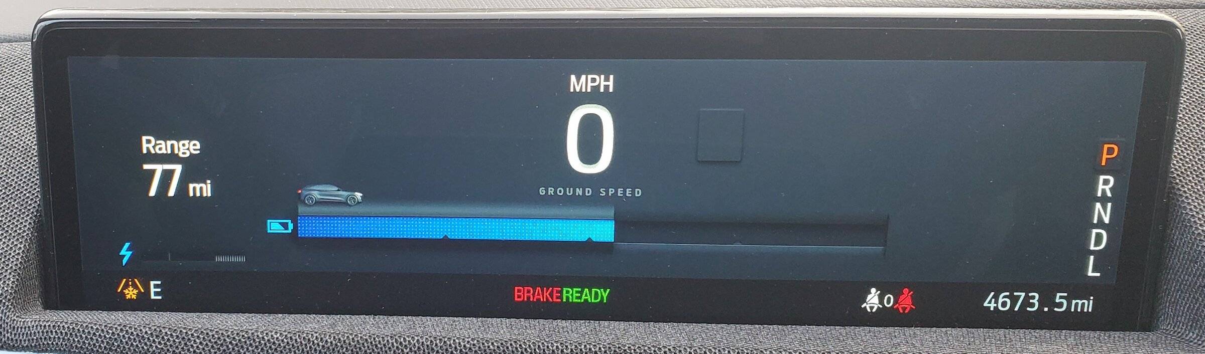

If you or anyone else who has this issue here gets the PCM update I would be curious if the issue remains. I believe Kevin is going to update his vehicle soon so we'll see if it's resolved in the latest version.I've seen the 10 gray bars show up on mine a couple times when parked outside, unplugged or on 120V power in below freezing weather for a day or two. Level 2 or 3 charging + preconditioning makes them go away.
