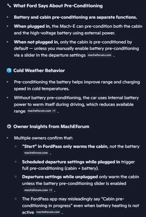

I have a 2025, but this is my first EV so I don't have a lot to compare to in terms of heat pump v. not. When I left for work yesterday morning and it was in the high 20s, my car was at 79% and I had 225 miles of range. Typically I would expect that to show closer to 250. My commute is about 15 miles but I was down to about 180 range when I arrived. So I did notice quite a dip in the range on the guess-o-meter, but nothing like I have seen stated from other EV owners so I take that as the heat pump is doing something?
I need to read more on how to optimize the heat pump usage -- I assume pre-warming the car is a big part of it, but not sure if there is something else I should be doing. I don't use departure times as my schedule varies a lot. If I remember to turn on remote climate, I probably don't do so in enough time to benefit the battery conditioning ... just the interior climate. Does the car have to be plugged in to benefit from battery pre-conditioning?
Ford Mustang Mach-E Cold Weather range is no joke 1762975649695-f1

thank you! Probably not something I will use often, as I never use departure times and only charge every 7-10 days. Takes me that long to get close to 50%, which is usually when I plug in.
I would use departure times more if I could schedule a one off more easily. I can't schedule a tomorrow at 8 a.m. departure, only a Thursdays at 8 a.m. so I would have to remember to cancel it before next Thursday.

There is no more "Start", it's now "Climate".
