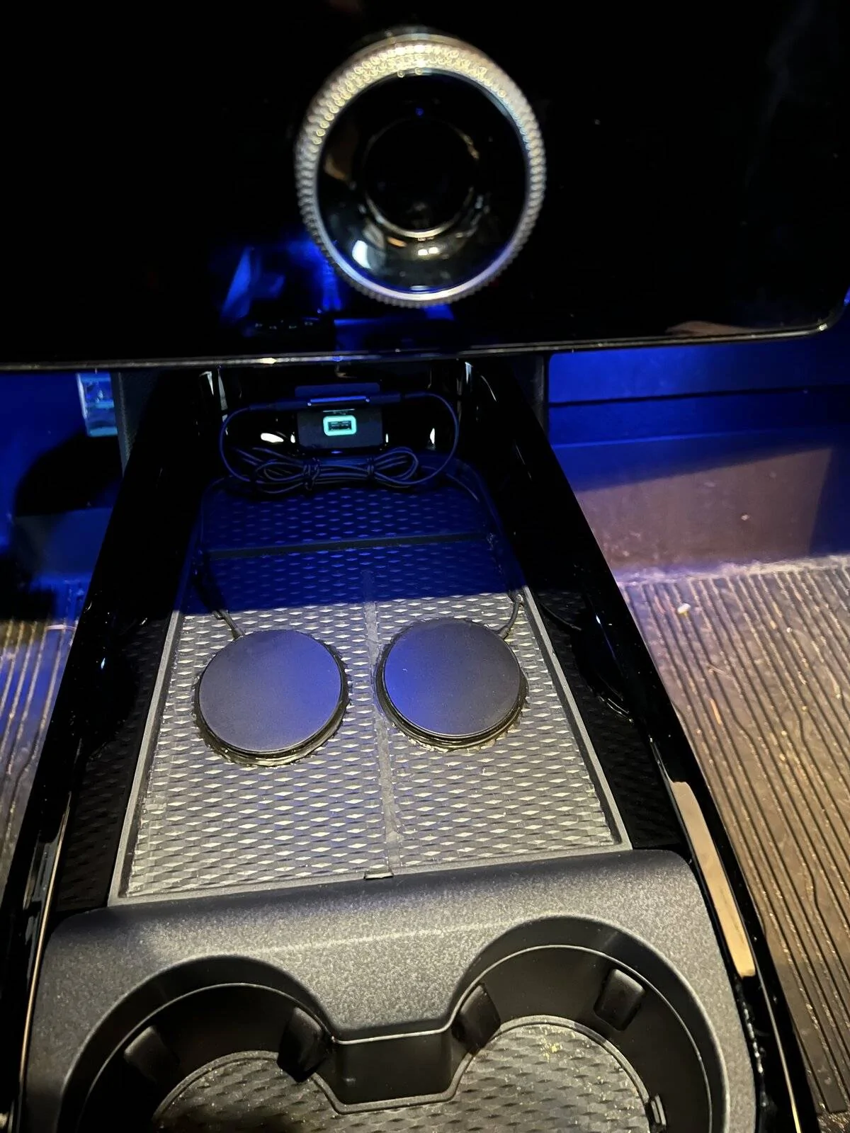

I hahad wireless charging issues with both an iPhone X and an iPhone 13 pro.
Charging starts with no issues. However charging randomly stops even though the position of the phone stays constant.
i have come up with a solution that works for me. Both my wife and I have iPhone 13 pros, both with MagSafe.
I purchased two very slim MagSafe charge pads and one USB-C splitter.
I glued the MagSafe charge pads to the rubber charging mat. And cut off the vertical rubber separator so both phones can sit in the charging well side by side.
Works perfectly.
