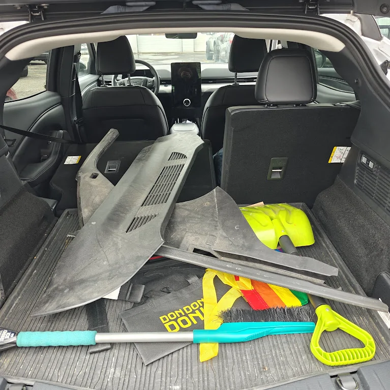

I'm all fixed up. This is the state the car was in when they handed me my keys and said it was ready for pick up. Throughout this entire process, I have spoken to my BEV Customer Experience Specialist zero times, after 3 ignored emails and phonecalls to a voicemail box that was full and not accepting messages.
I would have taken that picture and posted it on Facebook on the dealership's page, and emailed it to the GM. The tech should be FIRED for returning the car in that condition, as should the service person that handed you the keys.
At my dealership, the EV tech leaves dirty fingerprints everywhere. My service person has gotten to checking, and cleaning up after the tech. One time it broke the pins off the panels so badly that the service manager order me brand new parts (likely under warranty), then had a team meeting with all the techs, saying this was unacceptable.
