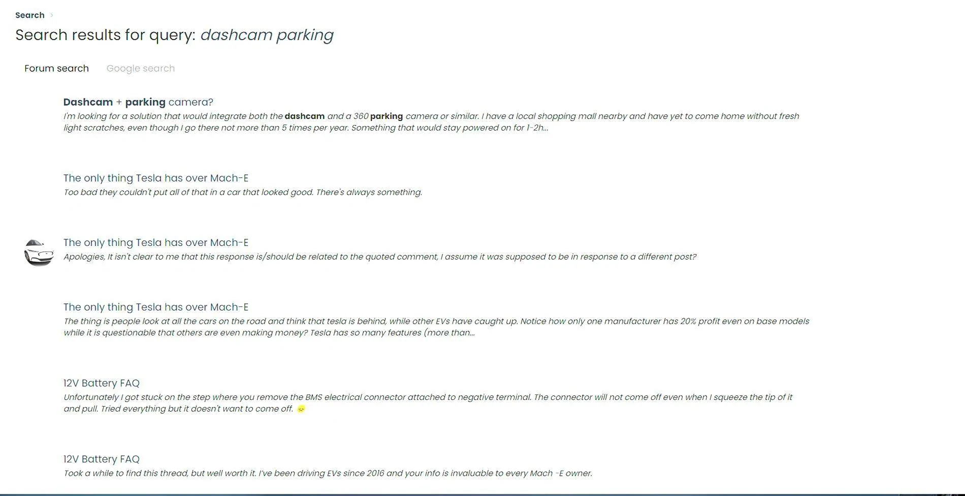

Good info in that thread, thanks. Couldn't find it with the forum search and cannot find anything else useful. Good thing that google at least can match a bit better:
https://www.macheforum.com/site/threads/security-cameras-for-mach-e-“canopy”.13494/
