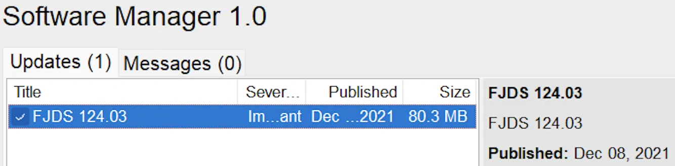

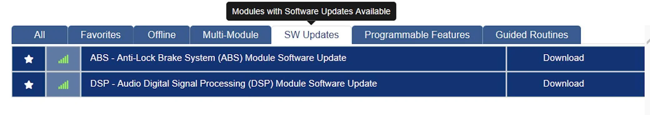

Since I did the last update Nov. 19 ( Customer Satisfaction Program 21P22 - Software Calibration Update ), I noticed two updates tonight, ABS and DSP. I am sure that everyone doing the 21P22 update now is getting the latest ABS update (and, it may not matter). (I suppose the version may not be new too, just part of it not dropping off my update list for some reason).

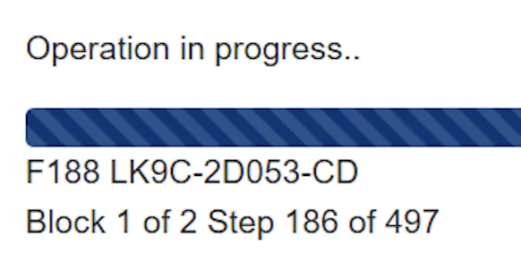

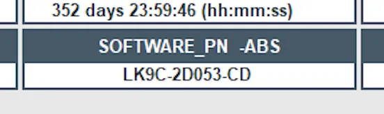

ABS installed without any problem and said finished okay, but does not drop off my update list for some reason. I ran it again, and same result. Data logger says I have the latest version, so not sure what the issue is. DSP installed fine and dropped right off the list. I got notices of a new FJDS while working, so installed it too, but no change, ABS still shows on the update list. Doubt it is an issue. All DTCs cleared okay and all modules are green. Total time (not including trying to get ABS to drop off my update list) was about 10 or 15 minutes.
Dec. 18 21 update: ABS dropped off the update list

I have the same issue with ABS.
I updated mine, and it doesnt drop off the list. The Software Calibration version did not change.

As to not dropping off the list it seems to be a Ford server bug. It will stay on that list until theres another ABS update. Then it may drop off after you update. I’ve noticed this across multiple vehicles.

The ABS is updated...its a known FDRS bug that happens all the time to various vehicles and various modules. Sounds like you have a different problem.
