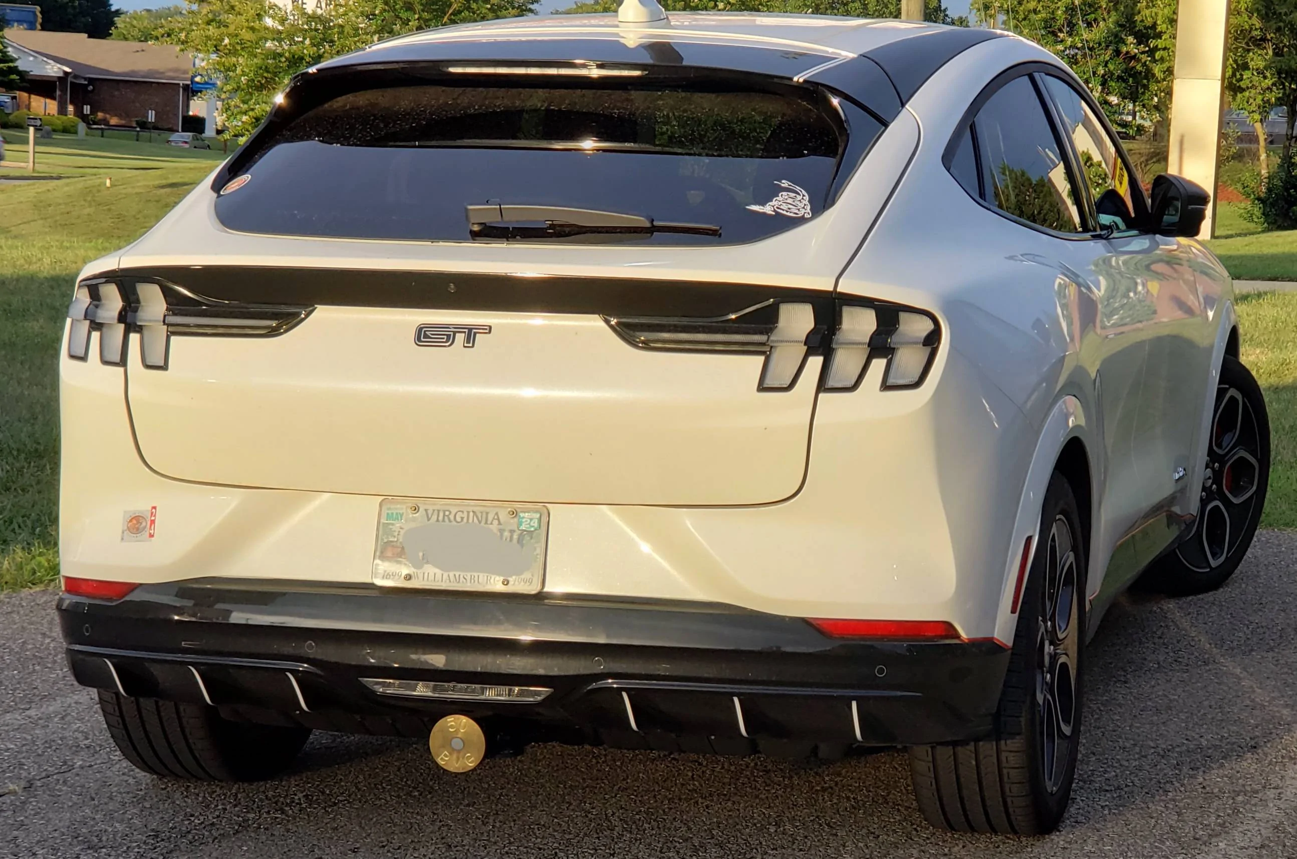

I don't mind my hitch extrusion. I put a big ass bullet cap on it, which is appropriate because my car takes off like a bullet.
Ford Mustang Mach-E Draw-tite Trailer Hitch Receiver Install 20220729_203957
