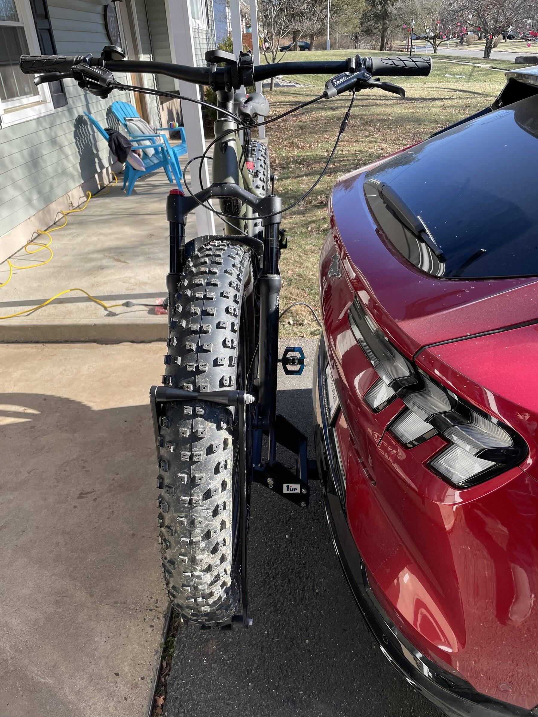

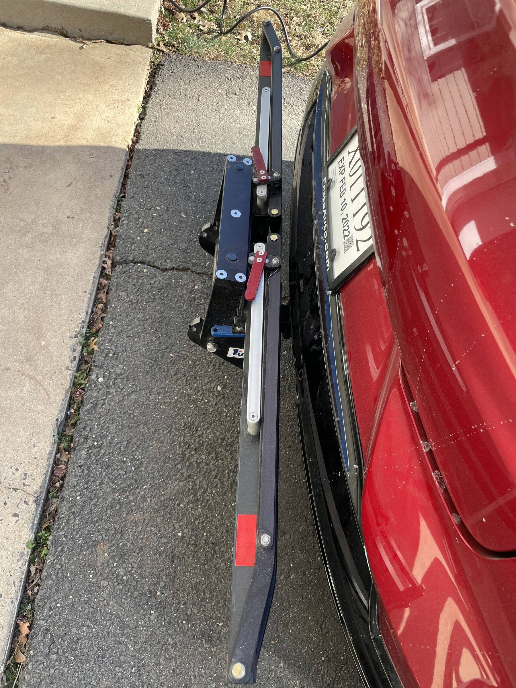

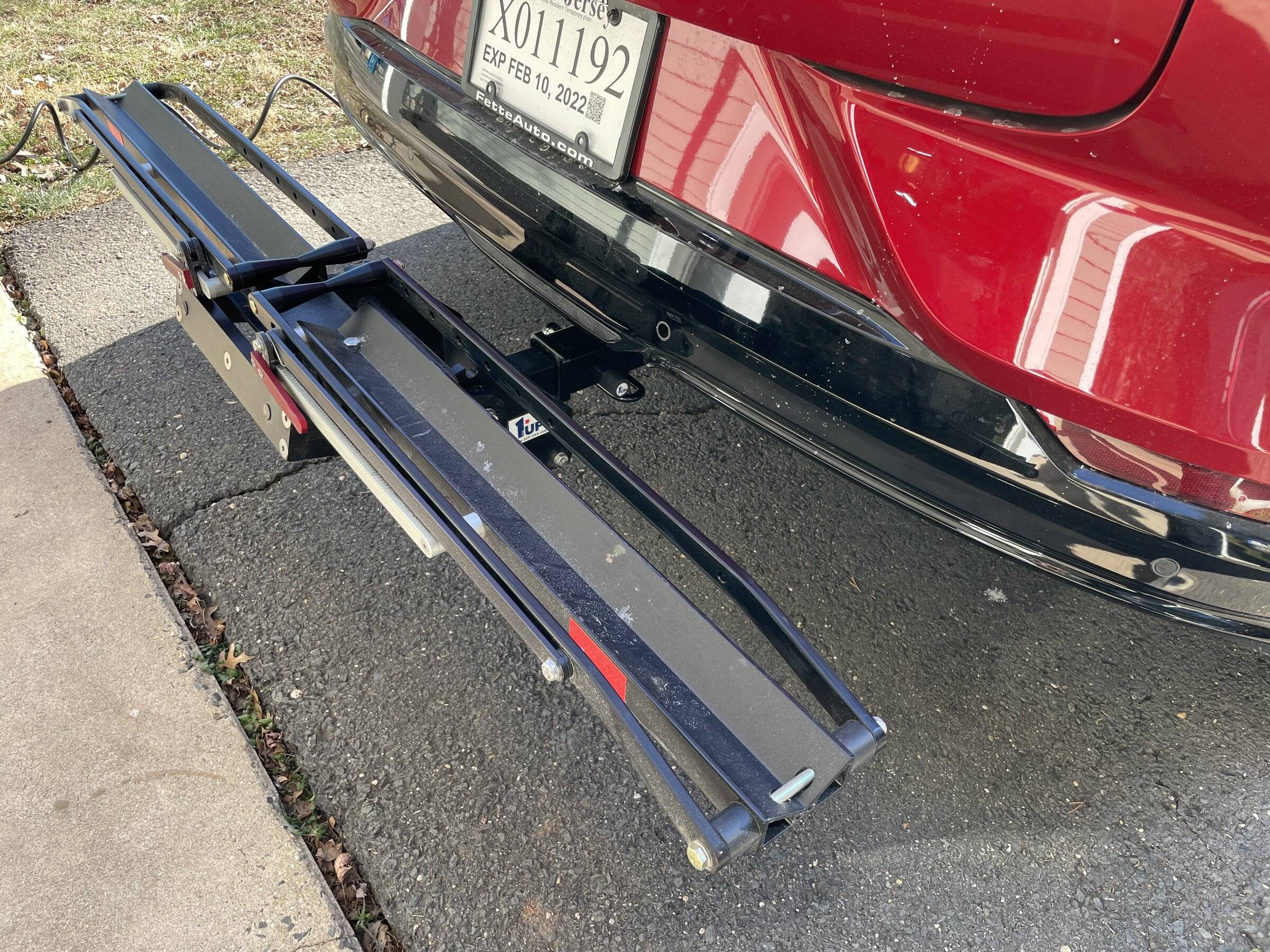

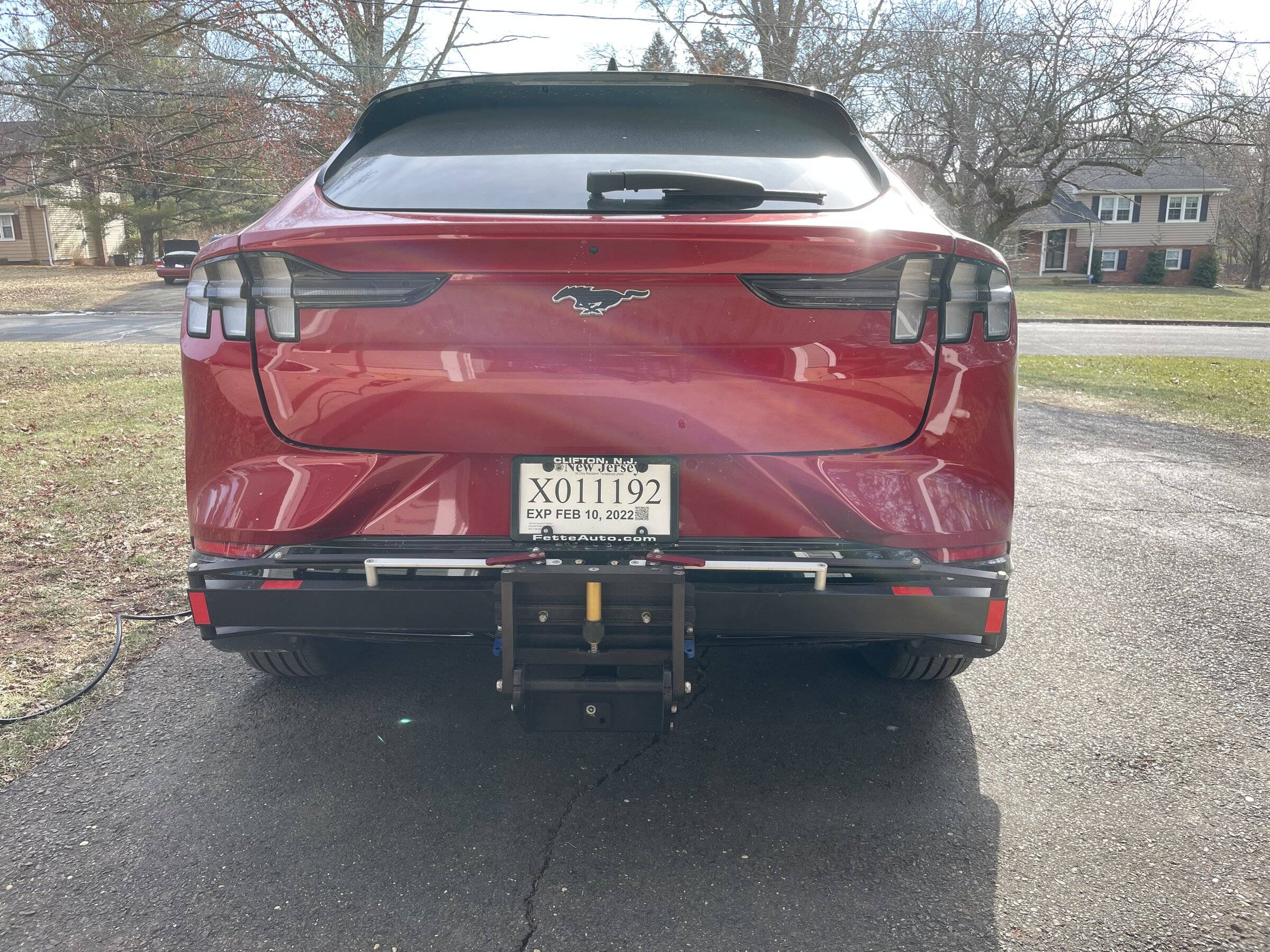

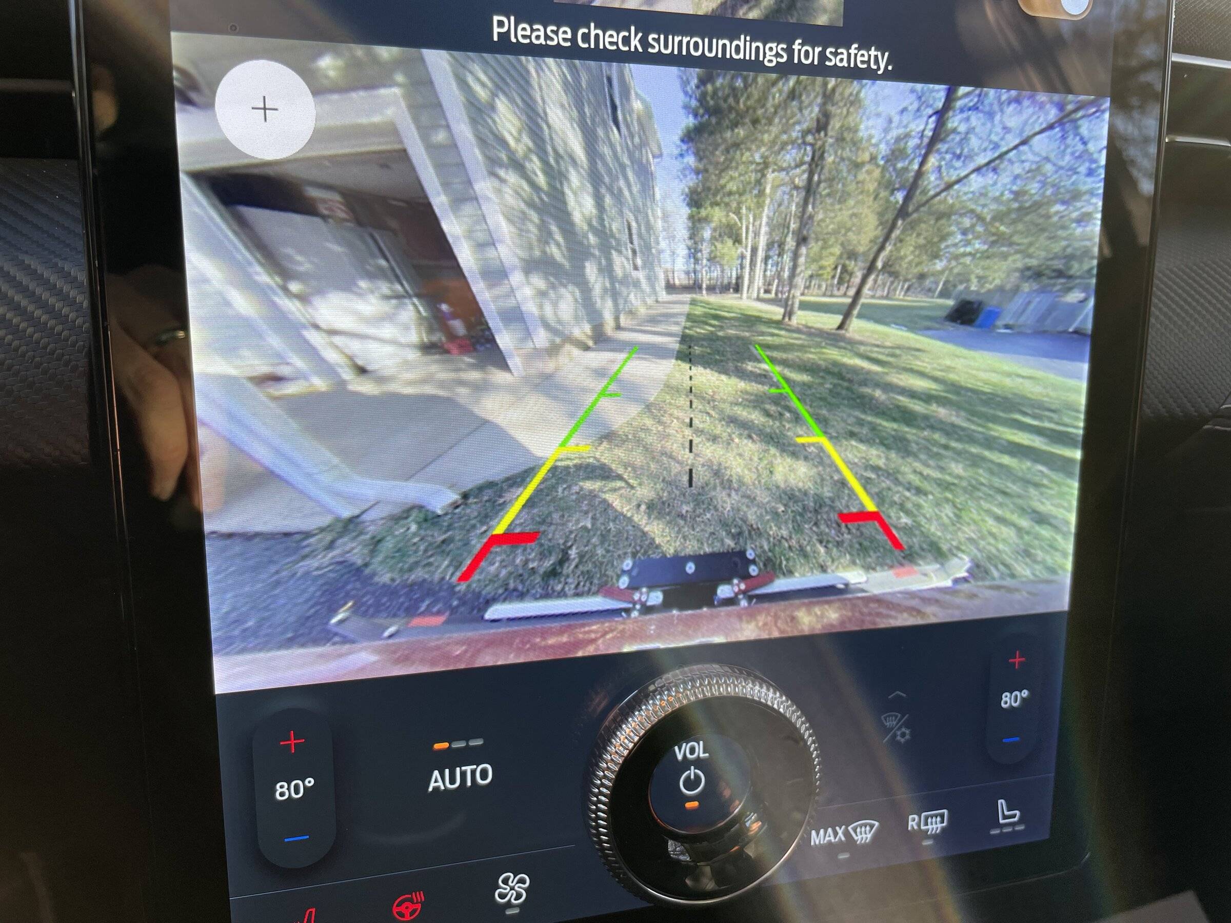

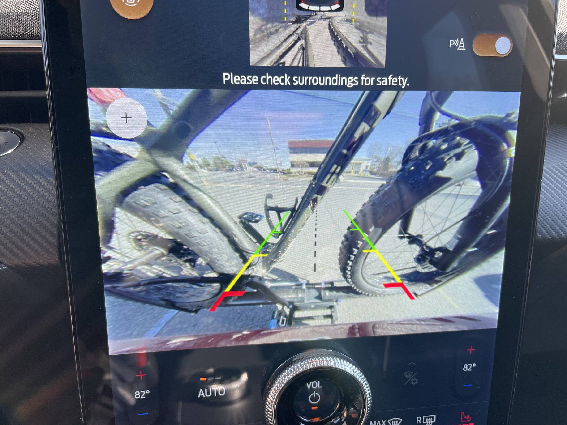

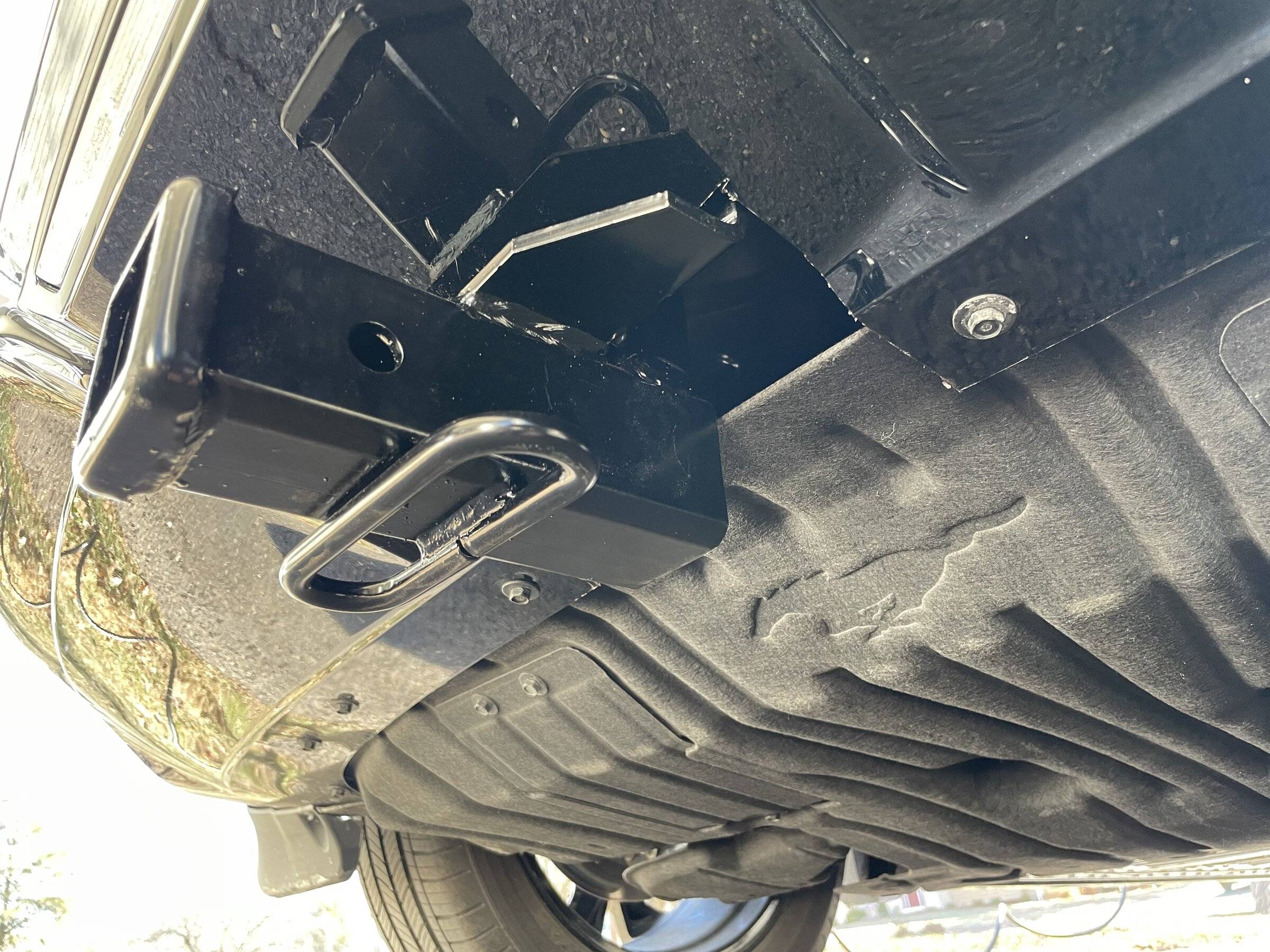

Here's a few pictures of the Draw-Tite hitch and my 1Up Rack installed... I couldn't be happier with how it came out.
I have the hitch about 1/2" from the bumper when closed.. the 1Up allows me to slide it about 3" if I needed to, I have it almost all of the way in. I love that when the hitch is up, its not really noticeable; its no higher than the black trim along the bottom of the car.
It does block the rear sensors, so I had to turn off active brake assist to keep it from beeping like crazy. I do get a warning on the screen that the rear sensors are blocked, but I have unobstructed visibility through the rear camera with the bike off, and still have great visibility with it on.
It does block the rear reverse spot light, but there is some reflection around it, so its not that theres nothing there, its just not as bright as it would be without the rack on. I had no problem backing into my driveway and seeing through the rear view camera; and with the outside beeps and regular reverse lights people will see, and hear, be backing up.
The foot sensor still works fine, although with the rack on, its a much more awkward stretch to get to it, so I won't really be using it anyway. The keyfob and button on the trunk are fine for me. For my biking gear I'll actually use the frunk or inside the cabin more than the trunk anyway.
You can see in the 2nd picture where the cutout is; I'd like to try and find something I can put in there to cover the opening, but I'm not sure how to go about doing that.
Like I said, overall I'm very happy with the Draw-Tite hitch and it is $280 that was very well spent!!

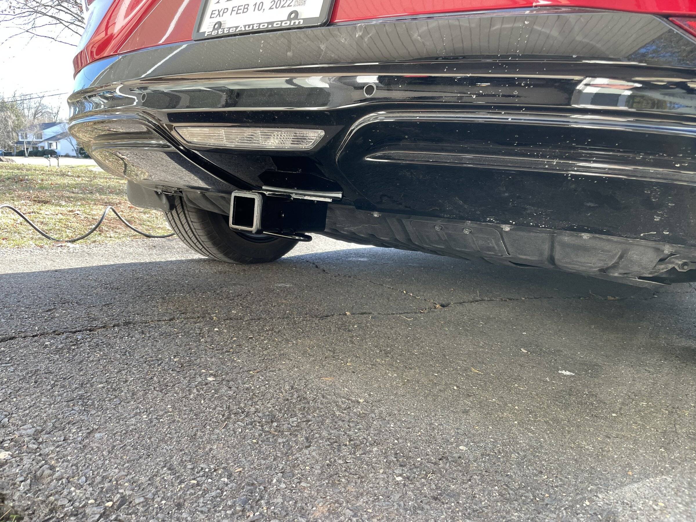

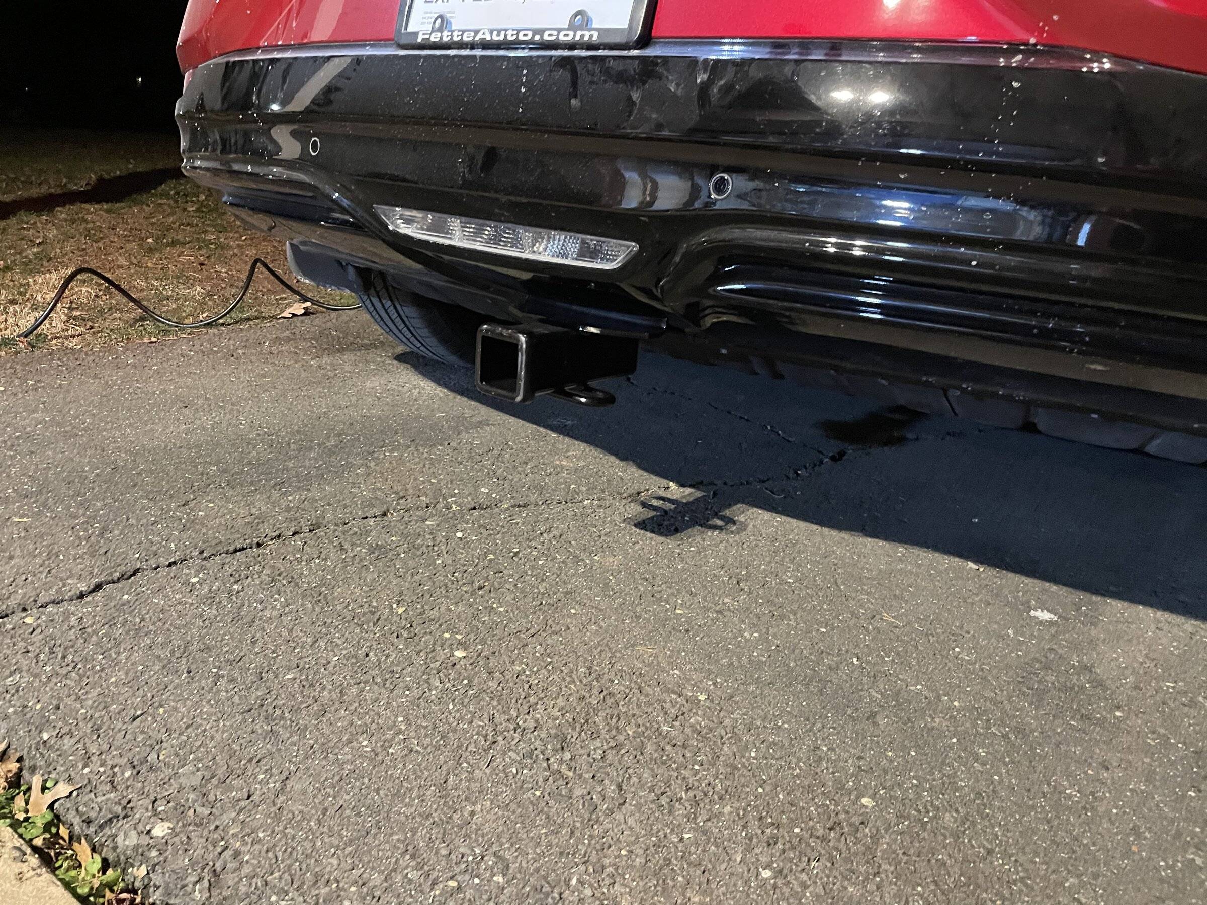

I did leave the other hitch on my car when I sold it, a nice surprise for the next buyer...
I don't have any other pics because its dark, but installation #2 is in the books!
It took about 20 minutes less than the first time, but I was also able to do this one myself. One thing I did differently was NOT use the ramps to lift the back of the car off the ground. Last time I struggled because of the height, I wasn't able to prop the hitch on anything while I got the bolts connected and ended up needing to have a friend come over to hold one side in place. This time, with the car being lower, it was more manageable. I got one bolt on pretty easily, then propped the other side up with a box and got a 2nd bolt in - that did take some time simply because I didn't have a good angle to hold the hitch, the washer and the bolt at the same time. But, once I got that 2nd one on the other 2 were simple.
Hopefully, this is the last one I have to put on for a while; I plan on keeping this MME a few years!
