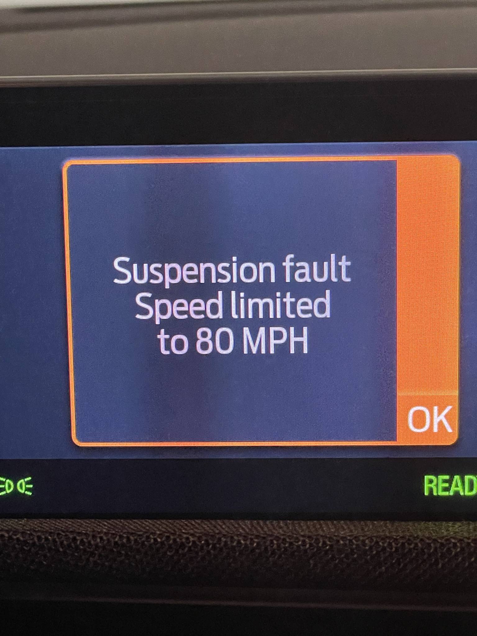

2023 GT PE, same thing happened to mine the last 2 days. Guess it’s still a thing. Speed limited to 80. Was it the module after all?

Good morning, Jim! I would be glad to help you out with suspension fault concern. Just shoot us a PM with your VIN and dealer name/location, and I'll get right on it. To send a private message, just click on our username and select "Start Conversation". Thank you!

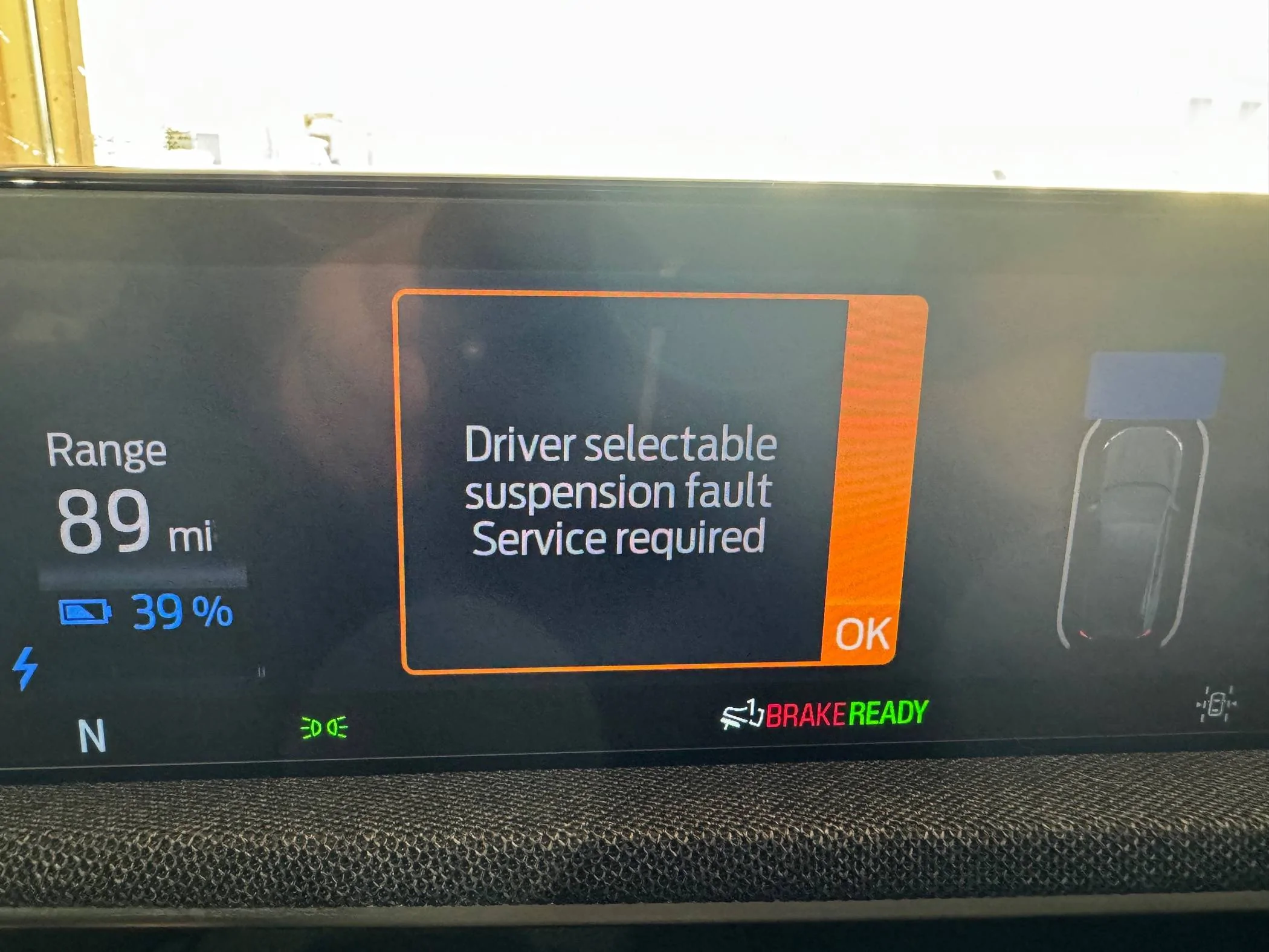

I got the same fault today. I drove it about 15 minutes and restarted it with the same fault. Drove it 5 mins and let it sit for an hour and it cleared. Is this going to be problematic? FWIW, it was 35* last night.
