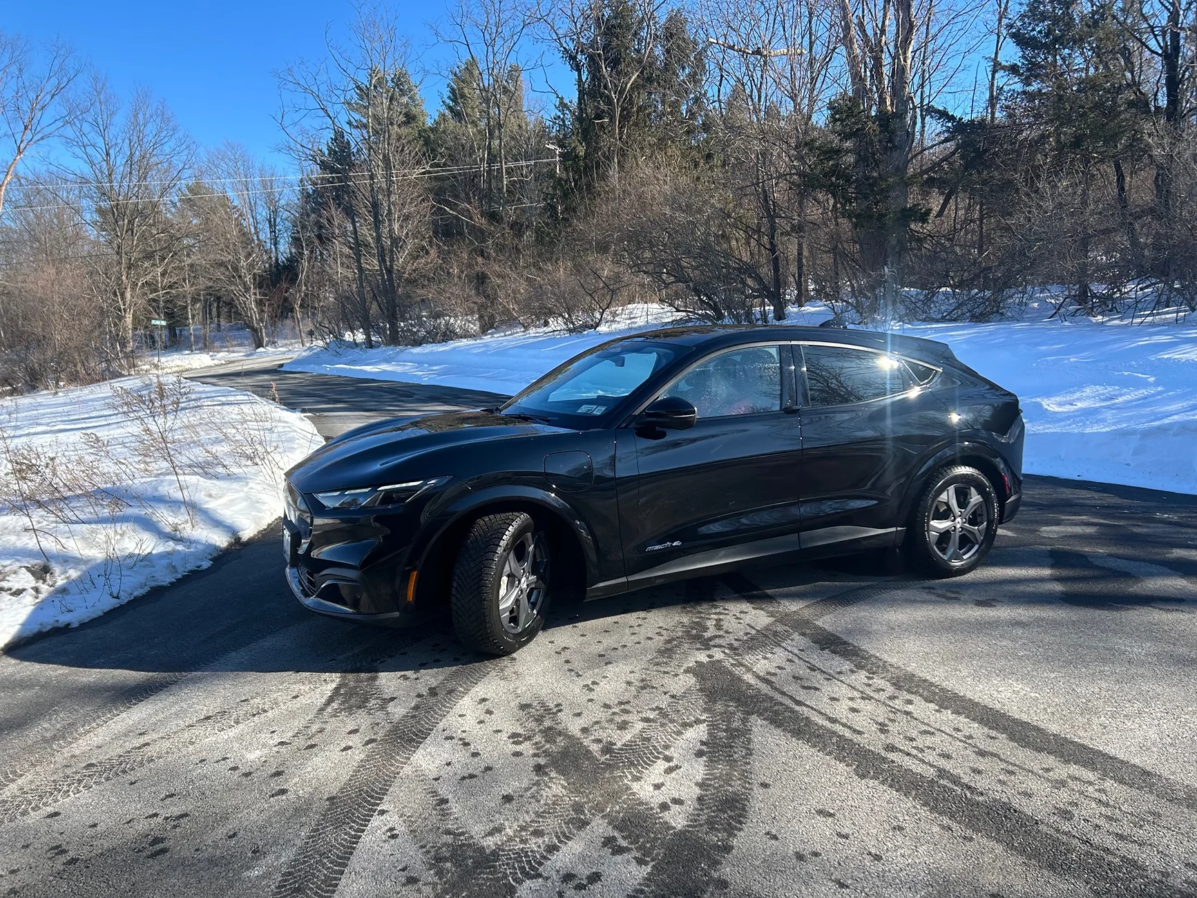

Sounds like you have made your snow tire selection already but I’ll add my observations so far on a set of Continental VikingContact 8 225/60 R18 snow tires I am running on my 2025 Mach E Premium. I put these on a used set of 18“ Ford OEM rims I sourced on FaceBook Marketplace so I can have a dedicated set of wheels to swap back and forth each winter. Only 6 weeks usage so far but they have been put to the test on a few occasions with snow and ice on hilly roads we drive in the northern Catskill Mountains. Very happy with their traction performance so far and I’ve not noticed any concerns with increased tire noise.
