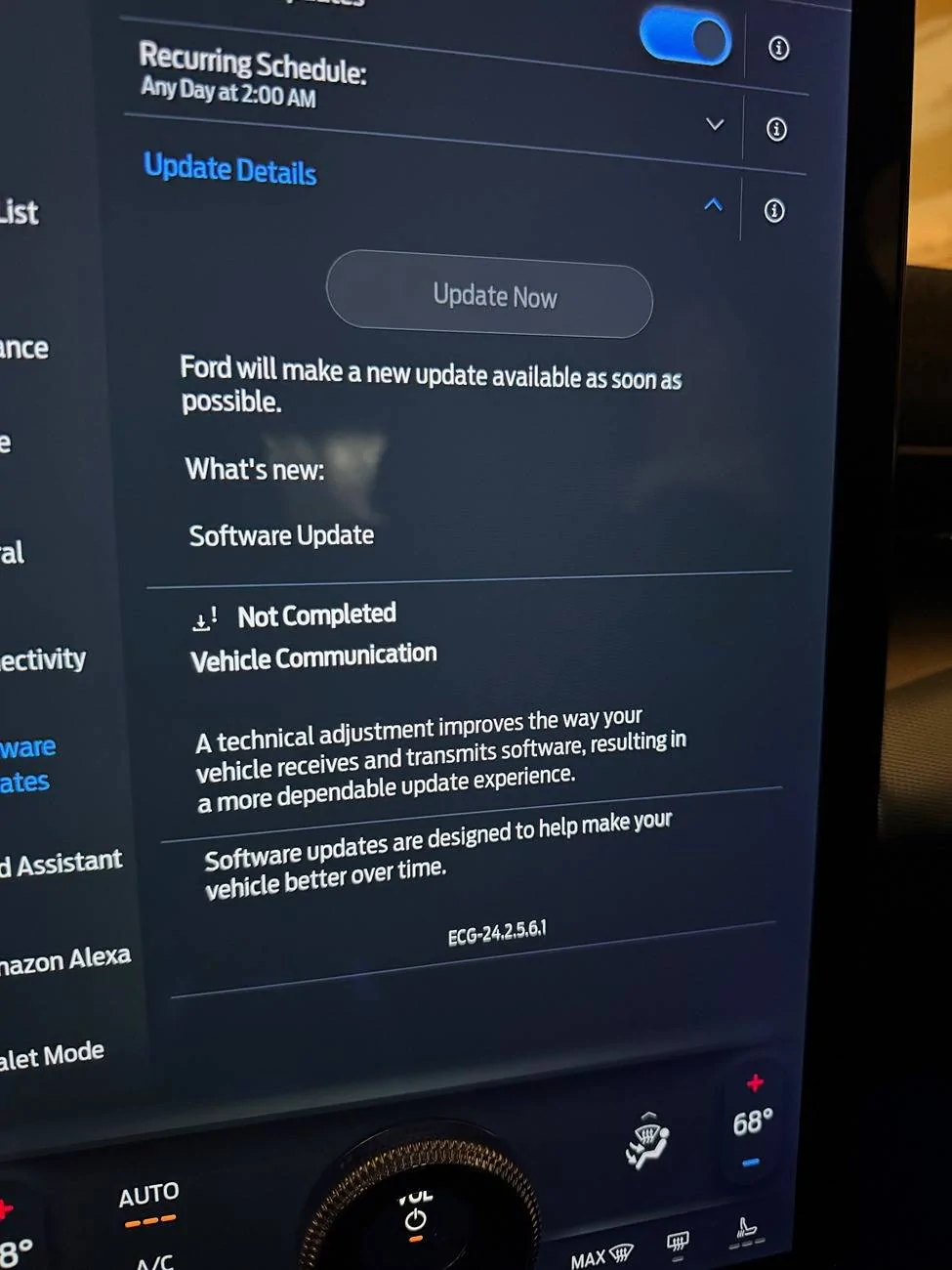

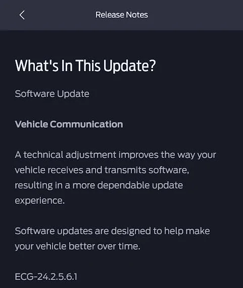

Any one with this update stuck in Not Completed?
It seems that the update did not go through in my car but I can’t retry updating it.
Mine is 'Not Completed' as well. I have a 2024 Premium.

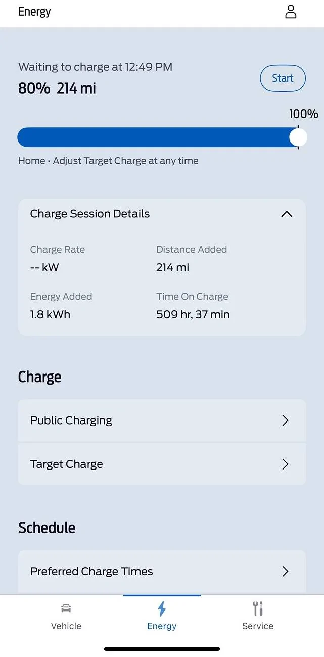

I know this thread is a month old or so, but mine has also been stuck at "not completed" since early October. Since then, it also seems like all of the charging session info and charging history in the FordPass app is screwed up and I've lost the ability to change charge times/limits, departure times, and use the "charge now" feature in the app as well. Not sure if they are related or not. A couple screenshots included below.
Did anyone that had the update fail eventually get it to go through?
