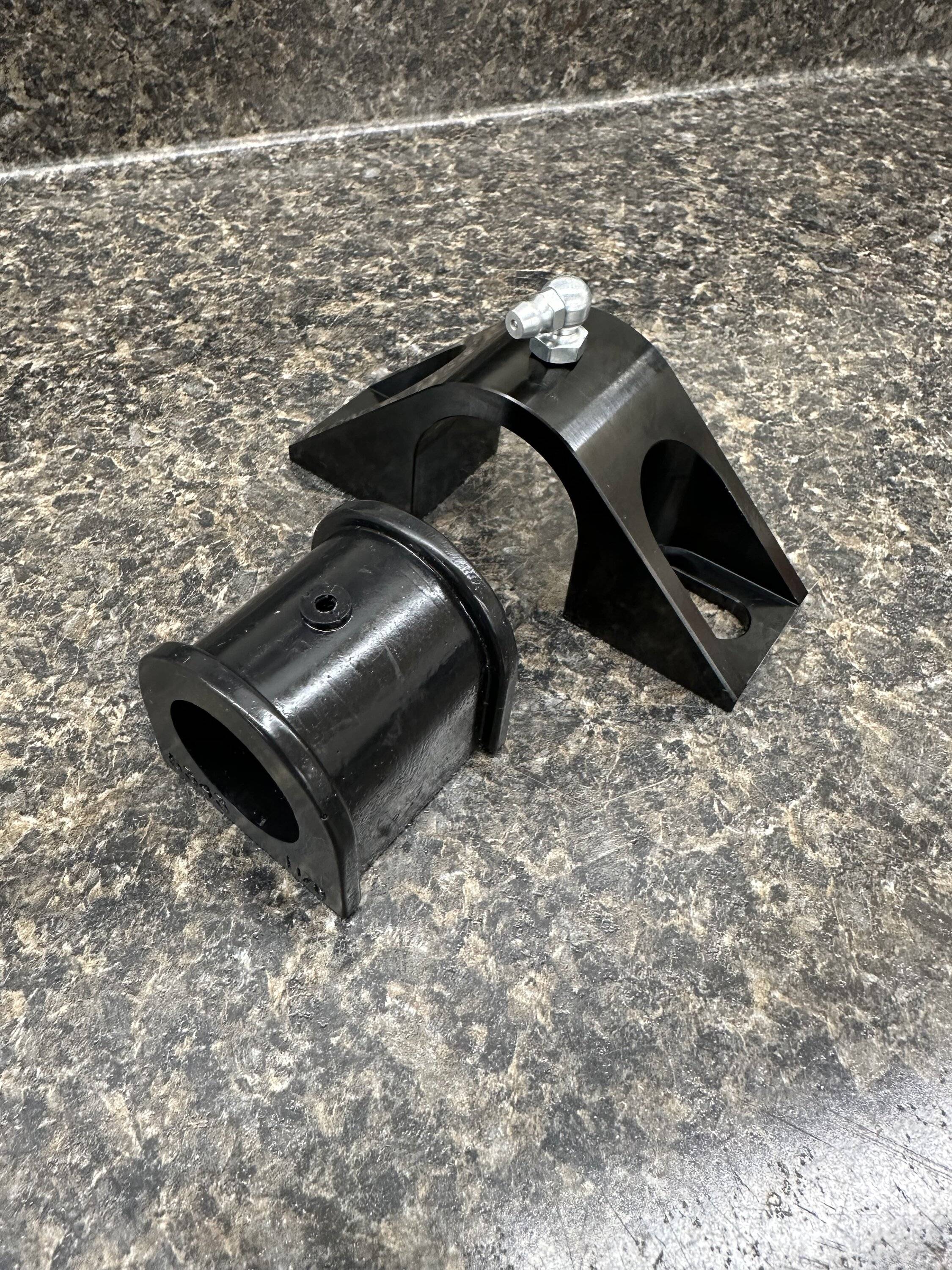

Did you notice if the bushings inside had pockets for the grease? (The ones for the Can-AM that wern't greasable had small lines for the grease, like a comb).

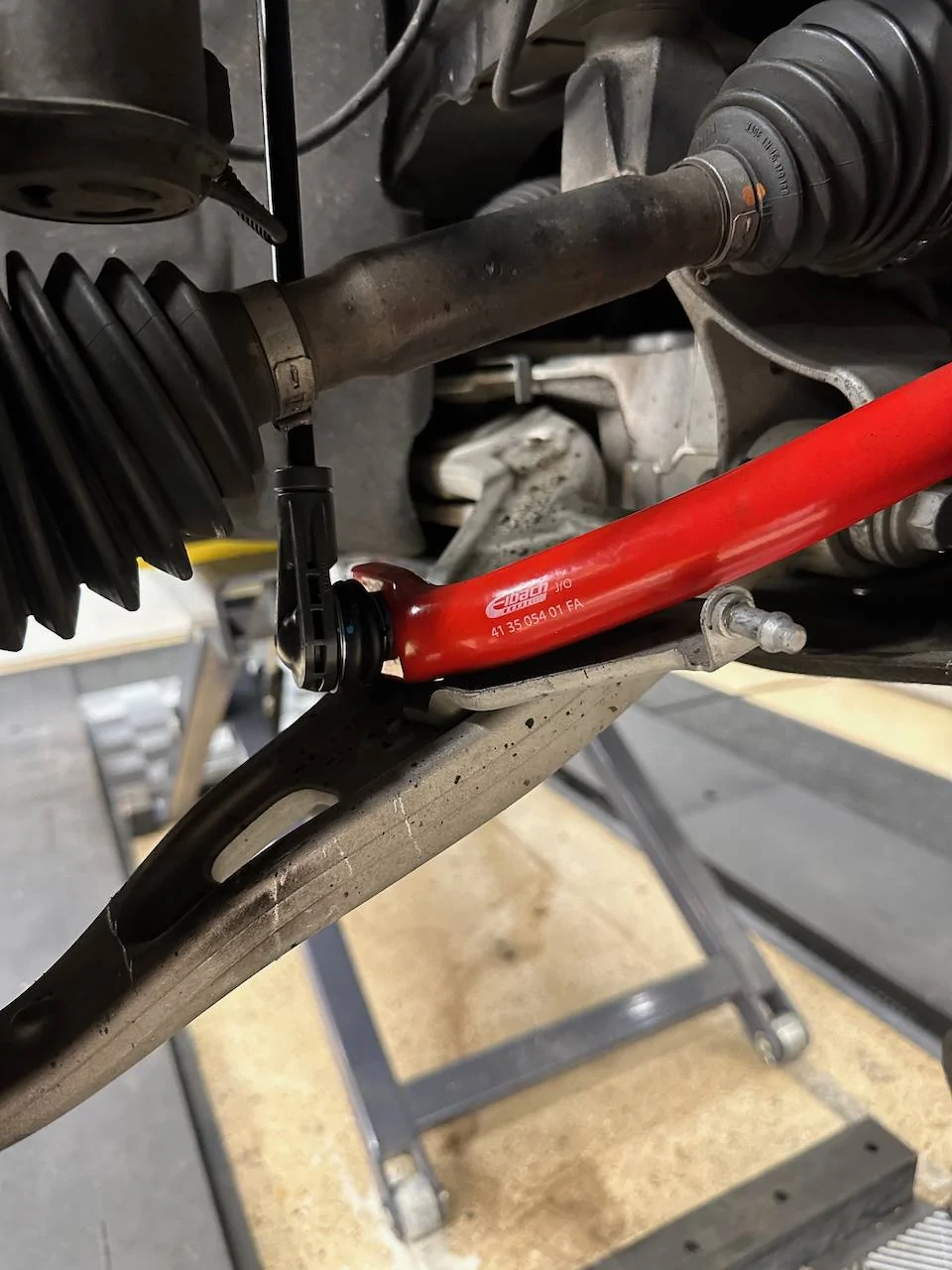

I didn't take many photos last night when I was doing this as I had just gotten home from out of town and was tired but excited to get this done so I could have today to take the car for a good drive. I won't have much more time to do anything else since I am leaving for Europe in two days for two weeks.

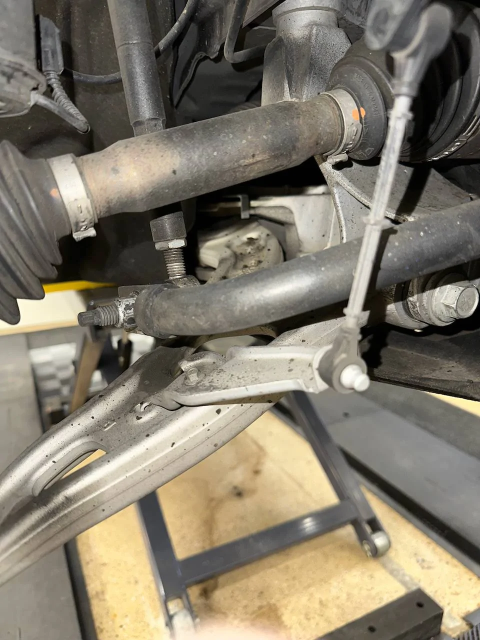

A couple of photos I did not post last night:
This is a comparison of the right front Steeda bar end link area and the same area with the Eibach bars installed. Because the angle at the end of the Eibach bar and the OEM end links being longer, there is much more room between the bar and the half shaft so doubt there will be any contact like there was with some members on their half shafts.
One note, you know you have the Eibach bars installed correctly as long as the Eibach name and model number on the bar are right side up.

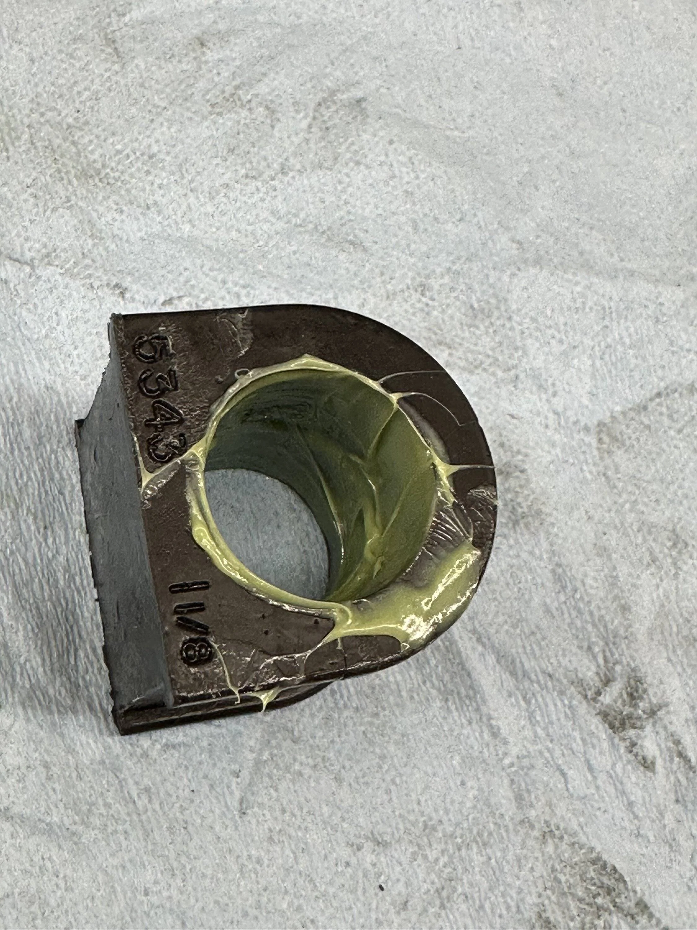

After pinching my Steeda brackets and driving on them for a week they're groaning. It's happening when weight is loaded or unloaded from stop and go. I'm headed north but this might be on my doorstep next week.
Yes the bushings have deep cuts in them.
You can’t really see them here with the grease I packed in them.

All four brackets are the same and are aluminum anodized in black. Not sure how heavy duty they are but I like the fact they have zirk fittings. I’ve never had to grease my bushings on any car using the green grease but there’s always a first time. The pictures in my first post on these bars shows one of the front brackets and one of the rear.

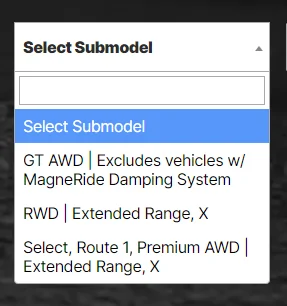

Maybe I'm missing something, but there's no option for the GT-PE. The only GT is the NON MagneRide option which is just the GT.

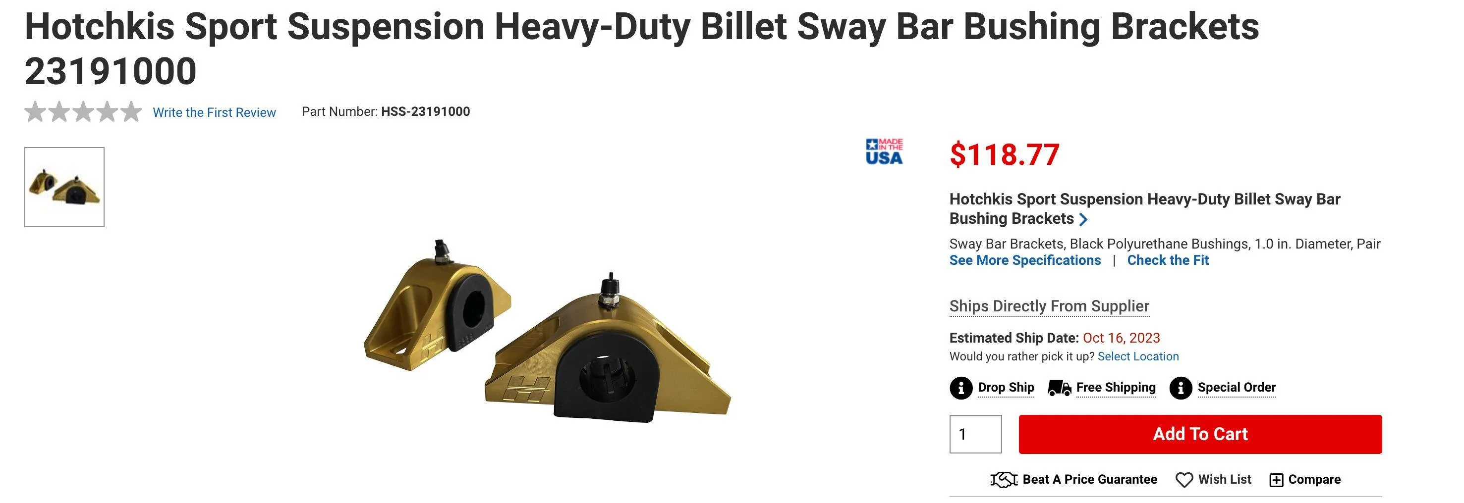

Mark is doing this to help US and Eibach. They couldn't test on a GTPE so they didn't say it's good to go.
Side note Hotchkis Bushings are almost 1/2 the price of the bar lol
As Erik said above, Eibach did not have a GTPE to test so they could not list it under their models to select. There is no difference in the shape of the bars no matter what model Mach-E you have but they won't list anything they have not tested. I can assure you that it works just fine on the GTPE.

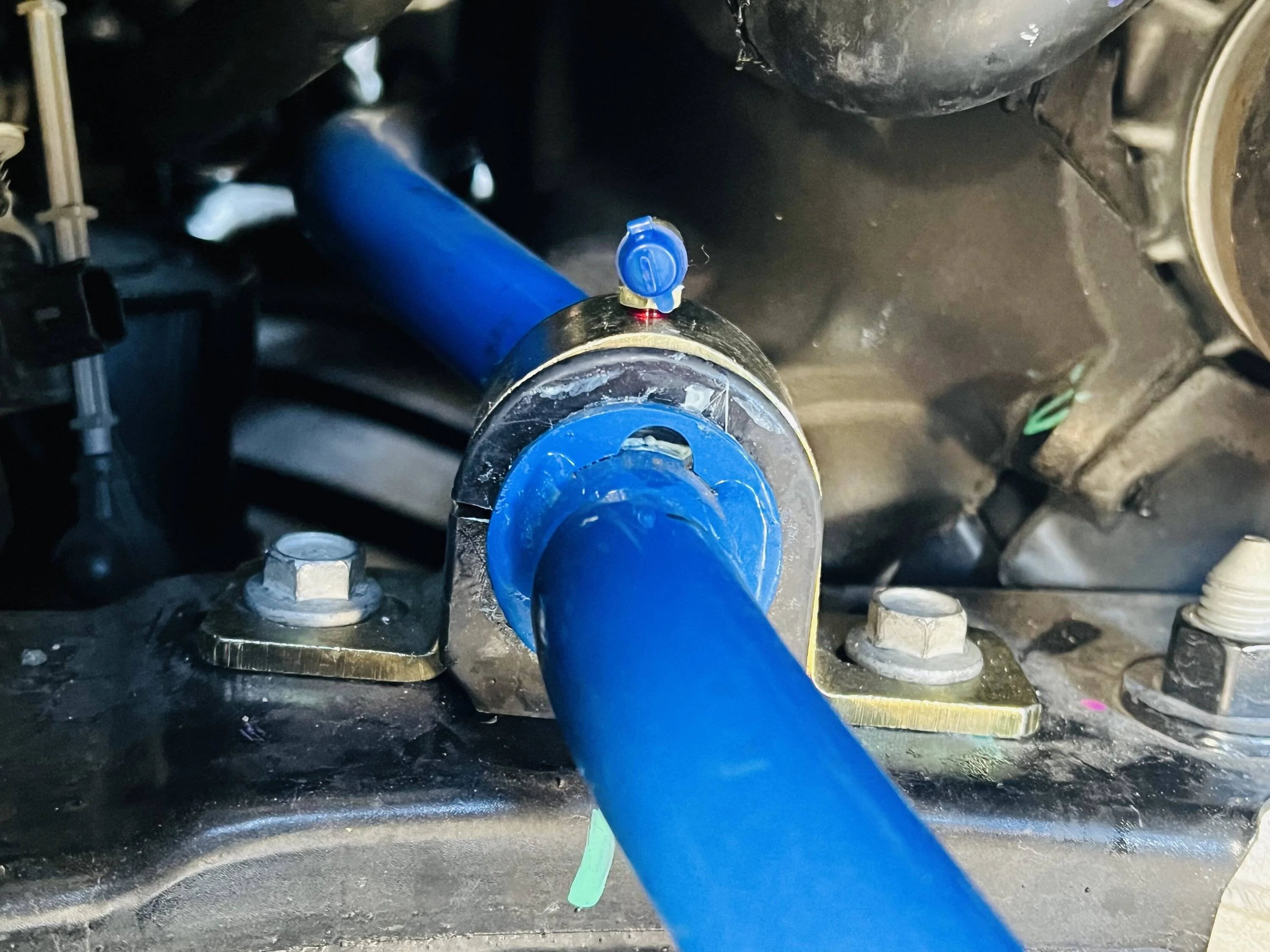

Yes the green grease comes in a pump tube. I dipped into the tube with my finger to lube the bushings.
I don't have any dips at an angle but do have speed bumps that are at an angle and make the car rock side to side very sharply. I can try those as they are close by.
The marine grease I use is similar to the stuff Mark is using but it has a blue color. You can kind of see it squooshing out here. ??
