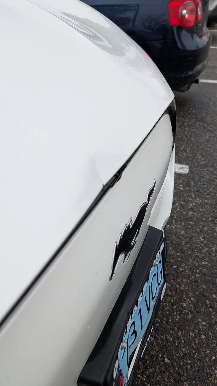

I had a small mishap yesterday in my condo parkade. I was driving at very low speed and was having difficulty opening the sun glass holder. It didn't open after 3 pushes, so then I pried it open. I was obviously distracted and accidently hit a square concrete post resulting in a minor ding on my hood and bumper. The question I have is, why didn't the emergency braking stop me? I got an oral warning less the a second before impact.

Folks, you should not be trying to test the collision avoidance system by hitting something. It’s a very “last minute” system that in some cases will only lessen impacts rather than completely prevent them. This avoids unnecessary activations unlike some other brands that set it off way too early (which is very annoying as an attentive driver) and can potentially trigger a rear end collision due to excessive deceleration.
Small objects like poles may be ignored. It’s designed to detect cars and pedestrians only.
To prevent false activations, it also doesn’t work at very slow speeds while parking (reverse brake assist is a different story). I think you have to be going at least 10 MPH or so. The risk of injuries in frontal collisions below this speed is very low, hence why it’s not used (the goal is to prevent human injuries, not minor fender benders).

Actually, that makes sense to me for forward collisions. I might have been fooled by the fact that the cross traffic alert while backing out of a parking stall really worked. My MME braked violently when a child suddenly ran behind the car. It saved him from injury for sure!

flyboy104: For what it's worth, a piece of metal road debris hit my hood roughly where your hood is damaged. It didn't just dent my hood though; it made a shallow vertical cut into the hood. My insurance company determined the hood needed to be replaced, as did the black trim below the hood that houses the camera. The repair bill came to US$3616.

Yikes! I may be driving with dented hood for awhile! Thanks for the warning

I believe when you go slow, real slow, the car will not stop you; otherwise, you would never be able to park in your garage.
