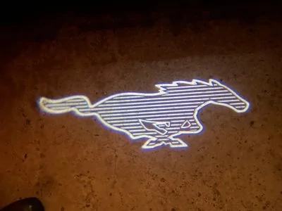

Best of all, the welcome lights come on more reliably when I approach and I am much more regularly seeing my pony lights come out to play!
