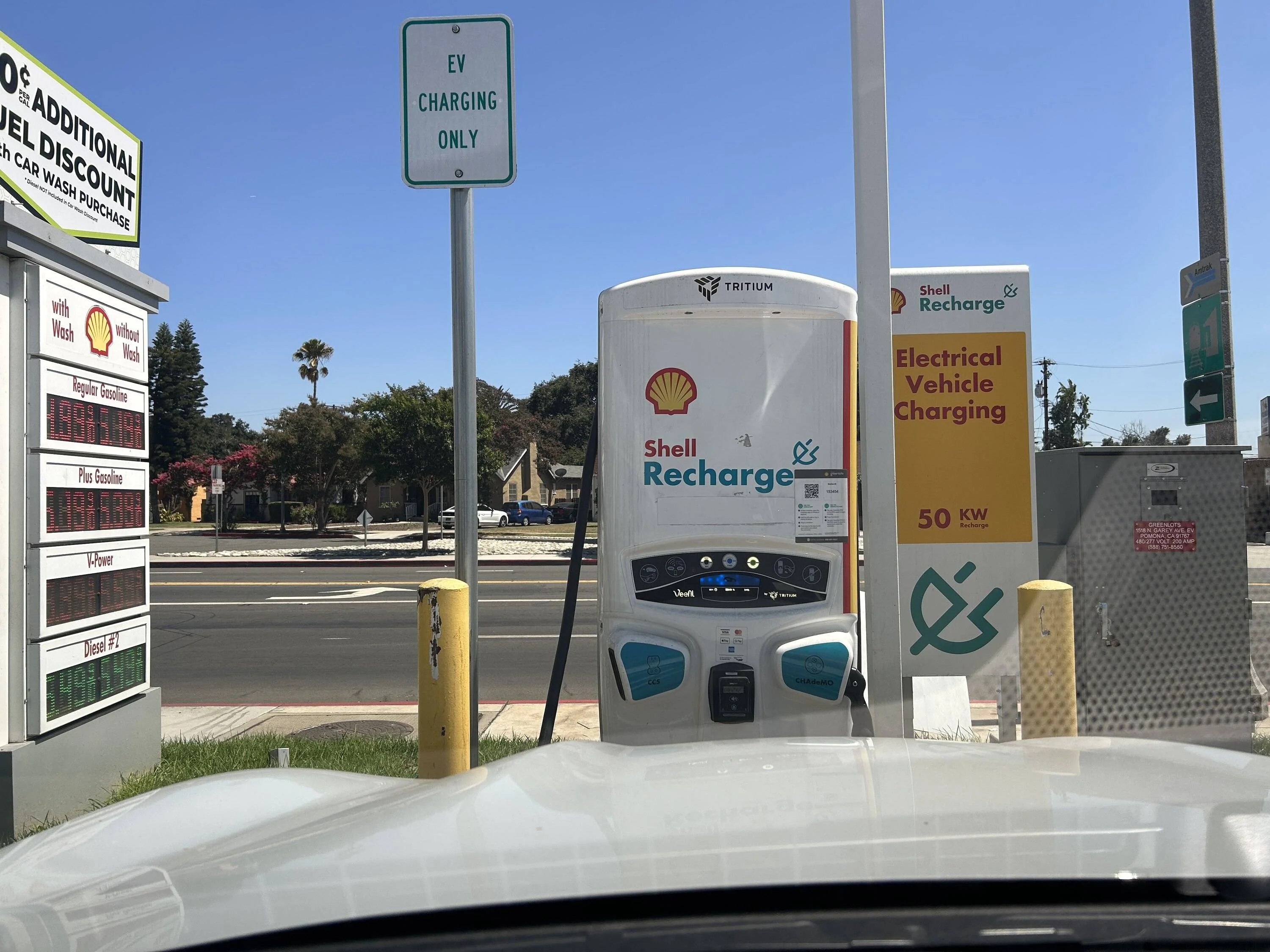

I use Shell ReCharge in the US and they advertise as 50kW but in real charge rate, I get around 90kW peak.

Next time check the panel on the side of the charger unit to see what its maximum power output is. You’ll also start to learn to recognize low power chargers. You may just be using low power chargers.
