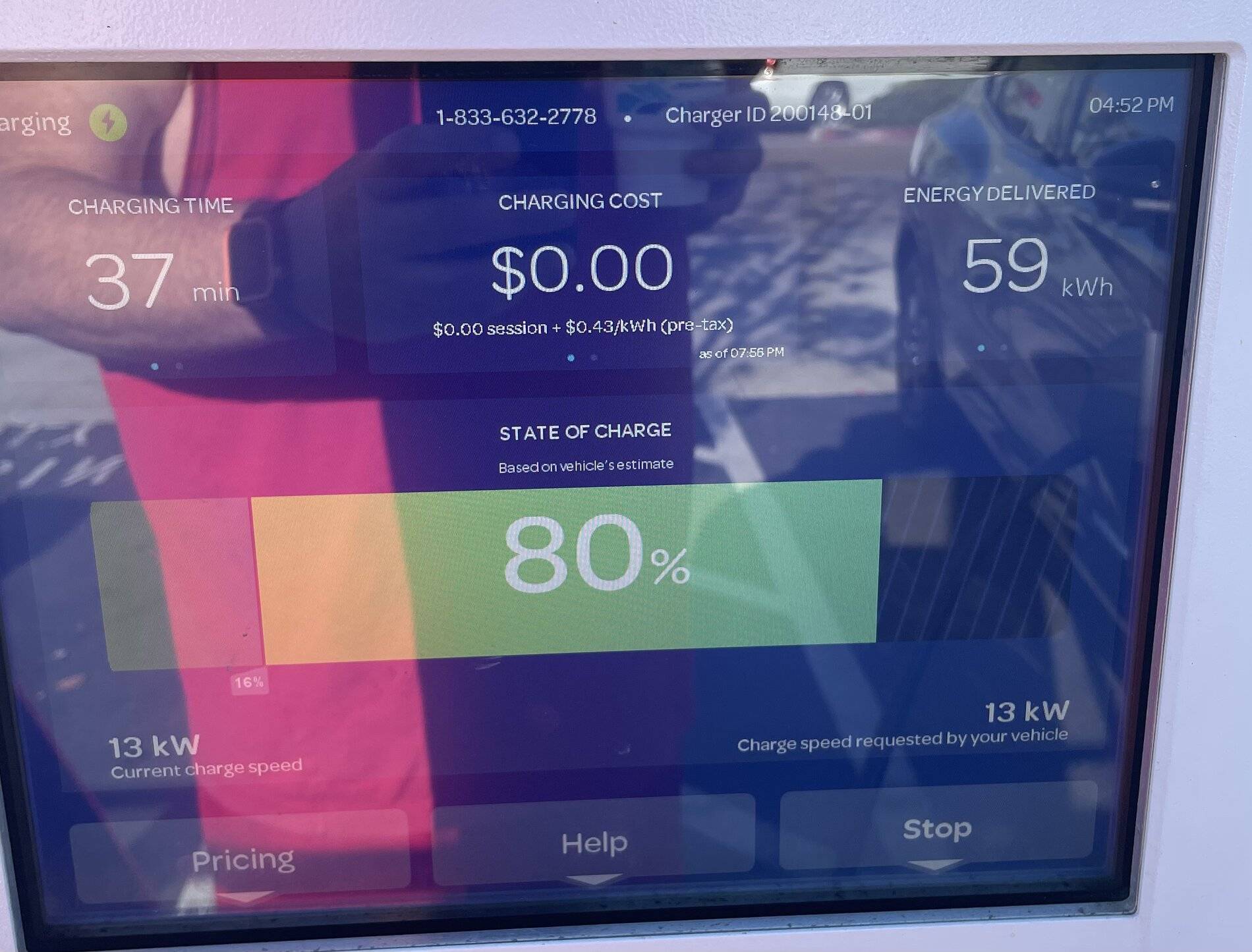

I’ll say 80 minutes is too long for that charge. I had a similar experience at an EA charger a few weeks ago. However, I had just driven for 3 hours and it was 100 degrees outside. At that point it was drawing 70 kWh consistently. I assumed it was because it was so hot, the car was managing battery temp. Could’ve been the charger though.
Probably the charger. I've driven through NV/UT twice this summer in 100-110F temps (8-10 hours drives at 80 MPH) with no noticeable impact on charging power.

I think it took about an hour to charge from 20 to 85% at the Lake City, Fl EA station. I wanted that extra 5% so that I could make it home without charging again.
Roughly 24 minutes of that should have been at L2 power (~11 kW) once it reached 80%. So about 36 minutes of high power to get from 20-80%. Sounds about right.
this is great to know! Some other chargers at the stations weren’t working that day, so must’ve just been a temporary charging issue. Thanks for the insight!

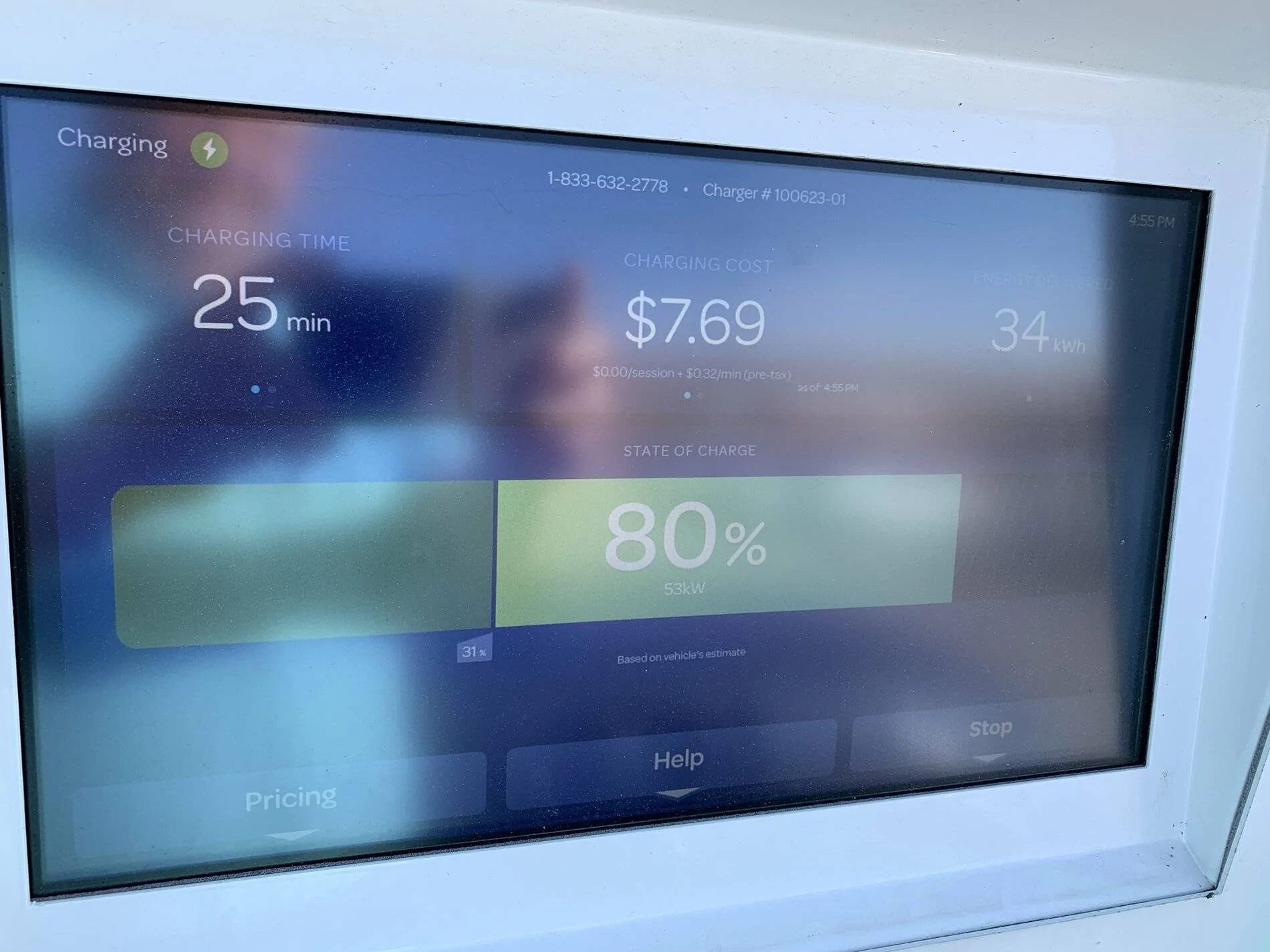

Thanks to everyone for the great education. I have a premium ER AWD. I took it back today to the same charging station and this time got an initial rate of 124kW. It took 24 min to charge from 26% to 80%. That was exactly what is was expecting. Appreciate all of the guidance, now I know what to look for when I make my initial connection.
