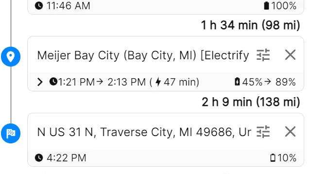

So you are saying, i am getting the right mileage?
Here is my ABRP plan for a recent trip, which was pretty close to reality, i.e. I arrived to the EA charger with 48% instead of predicted 45%:
Ford Mustang Mach-E DC fast charging range 1688312939397
And the second leg is 138 for 79, which is close to your 150 miles for 90%. In reality I had a detour, and didn't want to arrive with a single digit remaining battery, so charged on the way.
On the way back I decided to avoid unnesessary stress of running low and watching my speed all the time, and found a route with two available chargers with good PlugShare rating about 100 miles apart. I charged to 80%, and arrived to next stop with a little more than 20%.
So buttom line - yes, I think your milage is normal (assuming that select has about the same consumption as SB premium).
