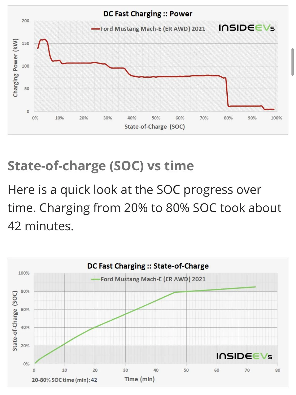

For those new to EVs or DCFC, here is the Mach-Es charging curve as of a few months ago. Given Ford’s obvious lack of updates, I doubt this has changed.
That curve only applies to extend range batteries, the curve is lower for standard range. I think the 120kw number posted earlier is due to that.

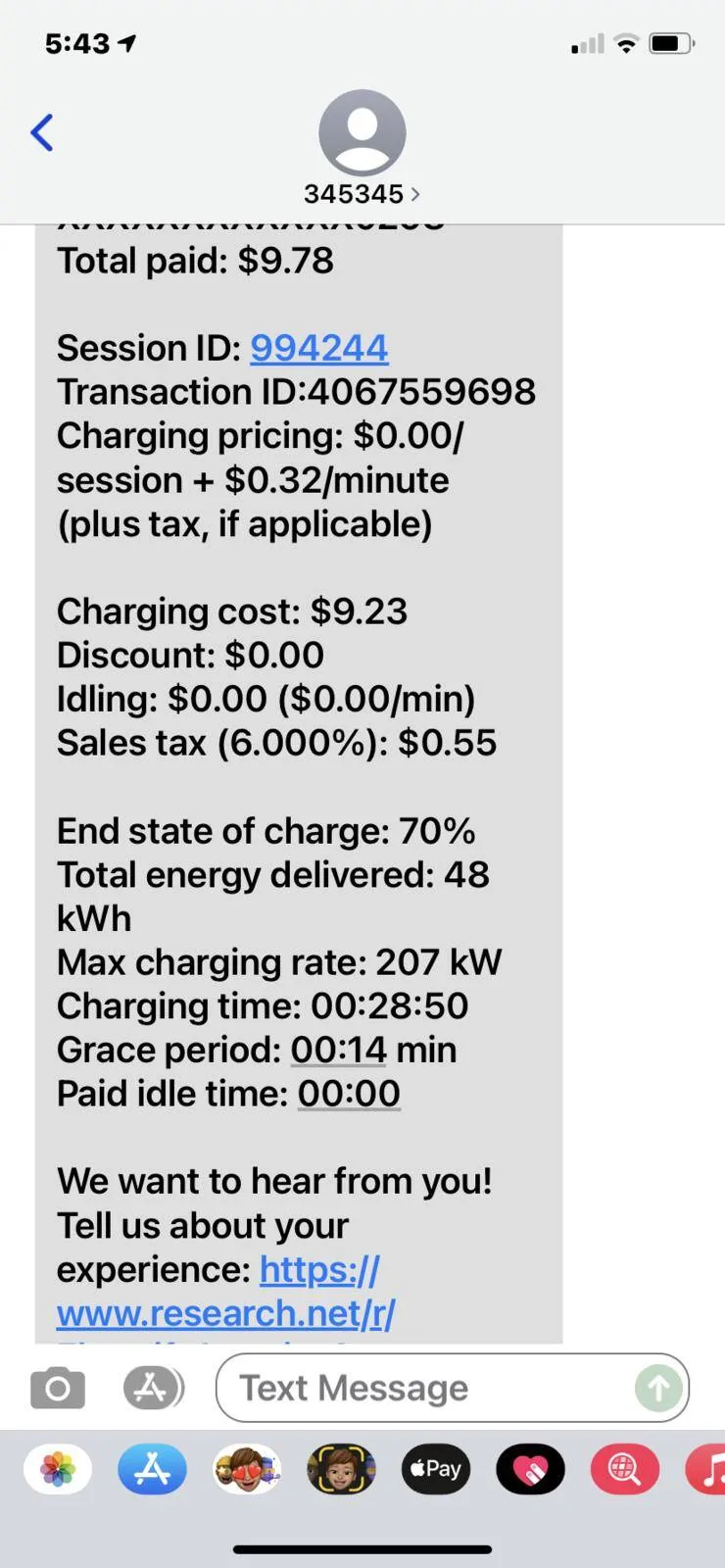

Probably an outlier but here's a receipt showing 207kw from a 350kw machine

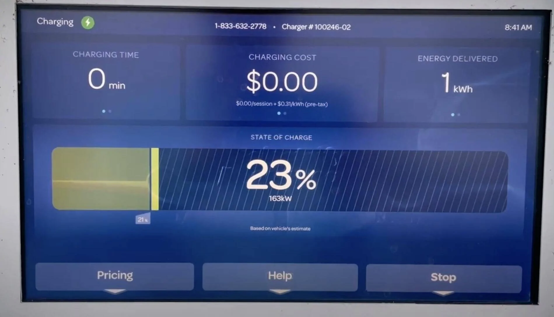

I have had my mach e for about 3 weeks. I normally charge at home but decided to try the local DC fast charger with the free charging event with Electrify America. This was a 150kw station. I charged from 24% to 72% in 1hr and 22min. This seems considerably slower than many of the reported times. Any suggestions as to why I saw this rate?
Assuming you have the ER battery, that's an average rate of 31kW. That's a common number for an EA station that's got problems (we often speculate that it drops to that level as a failsafe when the cable cooling isn't working).
Other than the first 2 minutes where it starts with a surge (up to ~163kW), the rest of the session (up to 80%) usually sits in the 80-120kW area when working correctly. We usually average about 95kW for the whole session most times. That's about 28 minutes to fill 50% (a typical road trip DCFC for us).
