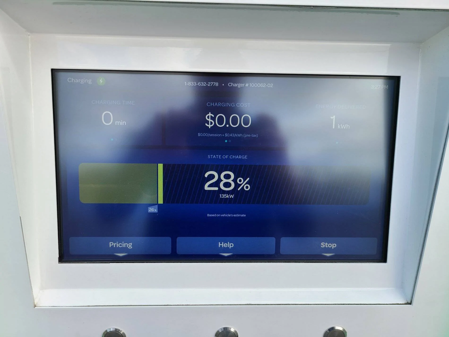

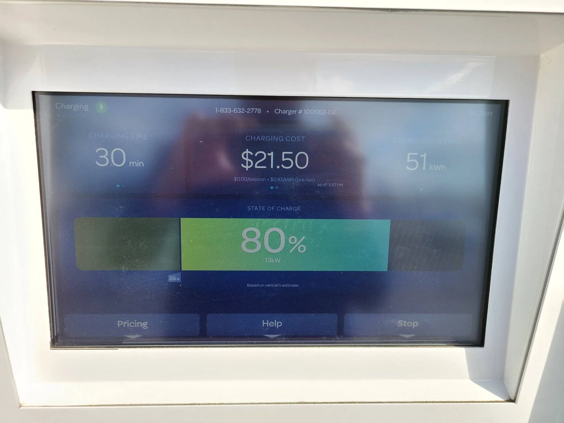

I am being told by a fellow worker of mine who owns a Tesla that the DC fast charging stations doesn't charge the car up from 10%-80% in about 40minutes, it's more like 4 hours. Only the Tesla Supercharger network will charge that fast. Is this true.
Not true, that's the frog in a tesla well. Here's mine from yesterday on Electrify America charger from 26 to 80% in 30min.
Unless it's a fast charger this won't happen.
Some chargers at blink, evgo, chargepoint are only 50kwh max they take 2x longer than EA on an average.

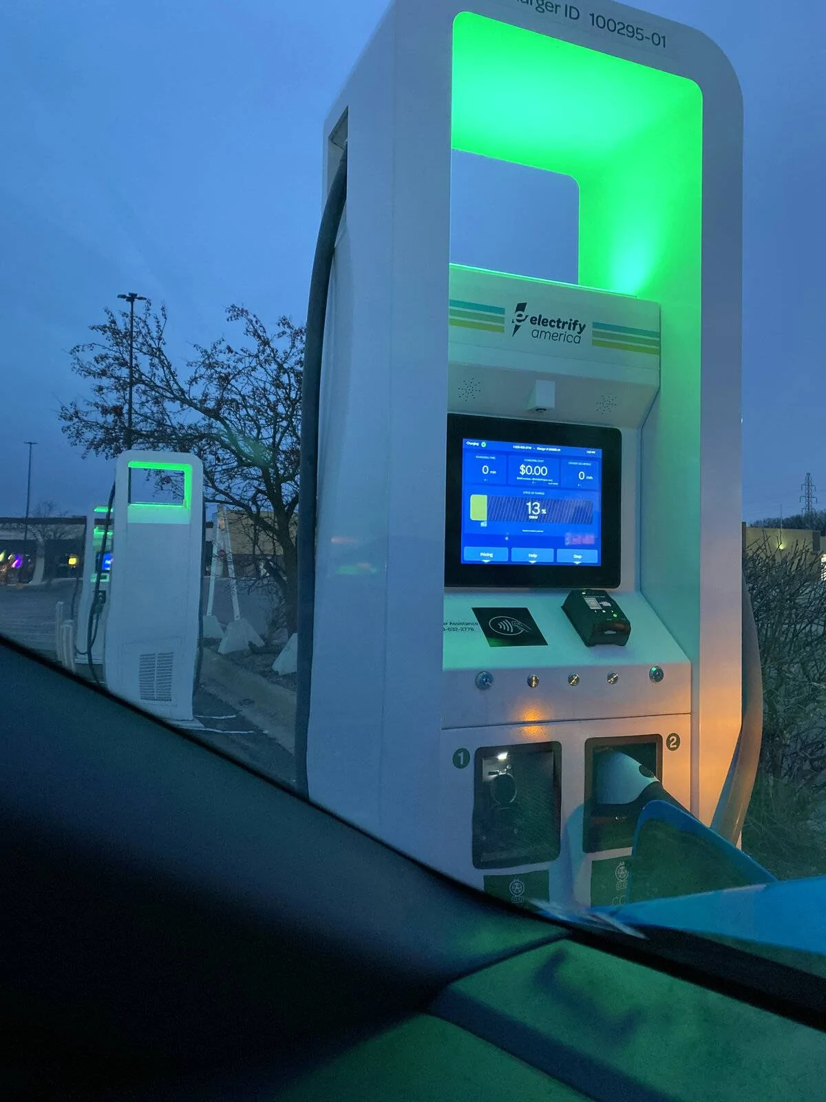

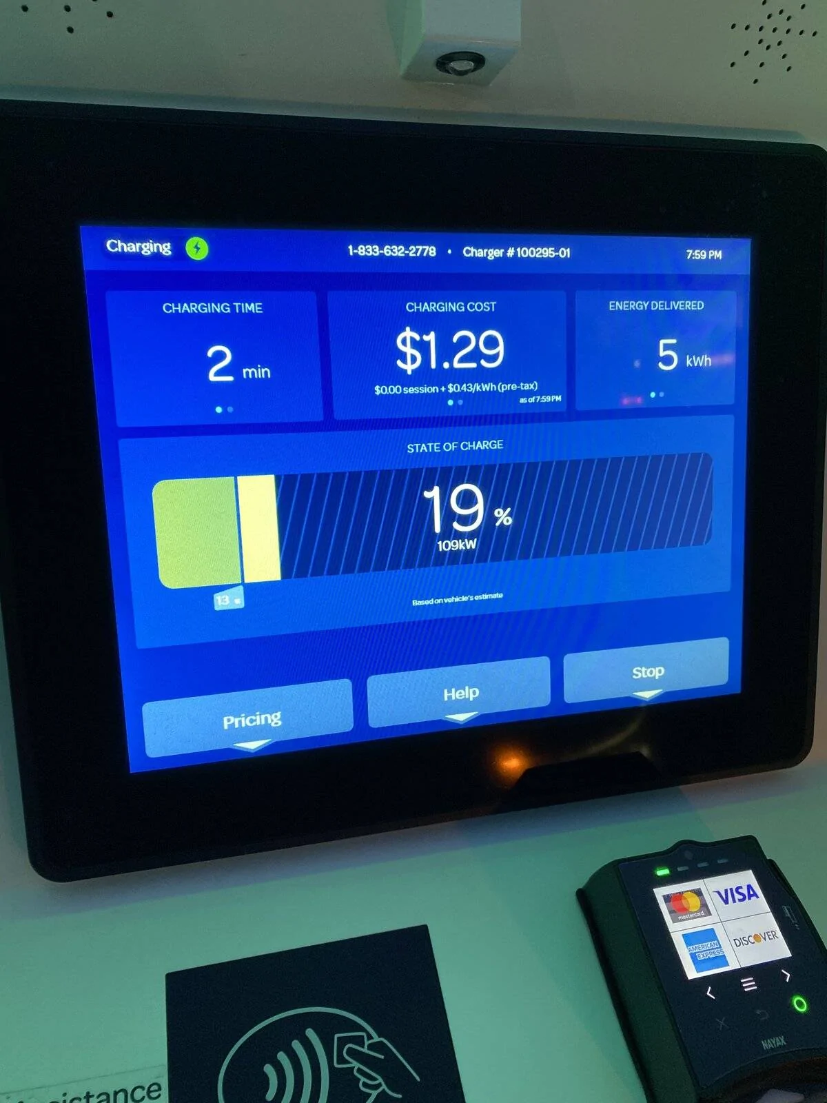

Now that I know to initiate from FordPass (and not try to just plug-and-charge), I get moments of 135 kW.
I average 110 kW
